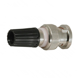

When you use the BNC connections on the 8903B, ONLY the center pin is intended to be connected to the device under test (DUT). The ground of the BNC is there for cable shielding, and is not to be connected to the DUT.
The 8903B originally included a set of BNC to single binding post adapters that look a lot like the ones in the attached pic (I couldn't find a picture of the original). These simplified connections when not using shielded cables, and they expose only the center conductor of the BNC; the shield does not come out to another binding post because as I said, it is not intended to be connected to the DUT.
To make the input connections properly, you can use adapters like the picutred ones, or make a set of cables by cutting a BNC cable in half, then attaching a banana plug to the center conductor of each (don't connect the shield to anything). Float the input of the 8903B; there is almost never a situation when you would not float it, especially when testing an amp rather than line-level gear.
For the 8903B output, you can set it to grounded, which grounds the LOW output center pin, forcing the differential output to act as single ended. Then you can use the HI side BNC to connect in the usual manner to the RCA input jack of the amp.

Success. I floated the output and there were no issues measuring the amp. I did leave the input referenced to ground and used the high output. I also tested another amp (manufacturer produced) this way with good success. Thanks for help!
