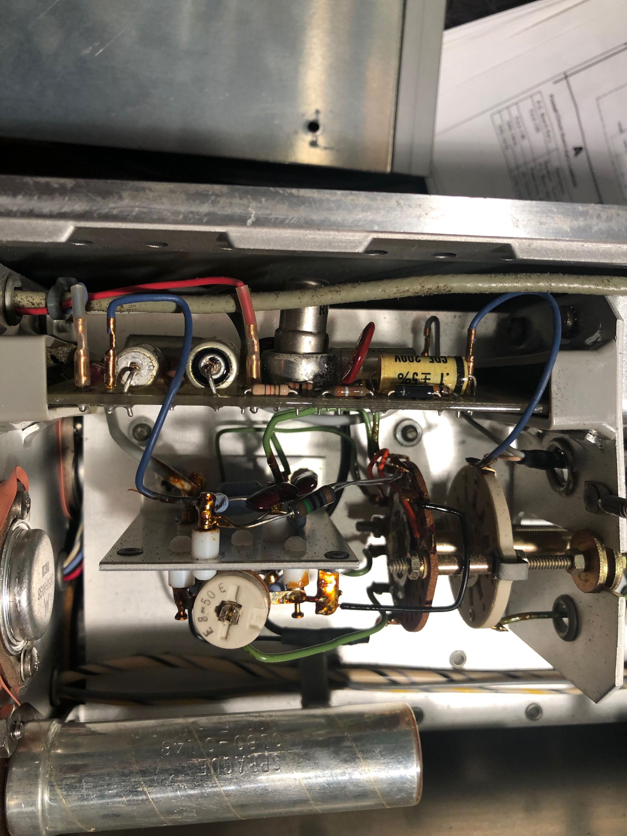

I just acquired some of these HP meters, which look similar to the 400 series AC meters, however they have BNC inputs on the back and 3 pin miniature power connectors-photos attached
I have searched the web and HParchive, but no joy
anybody have a clue as to model number etc?

It's a 400 series there is EL/FL and GL they are a good instrument and wide band the EL is 10Hz to 10MHz. Used one a lot years ago in the Cal lab.
It has a linear movement and 1 mV minimum so that would match a 400E. It looks like it was part of some test system which would explain the unusual layout of the connections.
HP400E http://bama.edebris.com/manuals/hp/400e/ or http://www.jamminpower.com/PDF/HP/HP 400E.pdf They are excellent instruments with a really long service life.

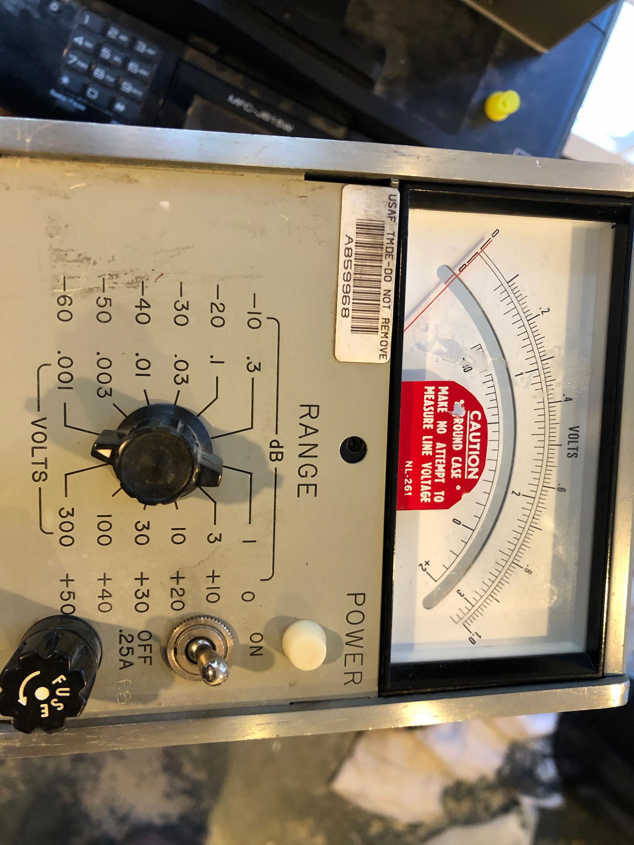

Yes I think you are correct that they were part of a system. One of the units (I have 4 of them) has some USAF markings on the front and a "Don't measure mains voltage" sticker on it- photo attached.
So given this I am wondering what voltage was intended fore the 3 pin power sockets? - (I have natural tendency to not creating magic smoke)
There is a transformer (T1) and some diodes which suggest AC to DC conversion, but I am wondering if the AC voltage was considerably lower?

Assuming the power transformer is still present, the connector is probably AC power, line, neut and gnd. You need a manual confirming the part number on the transformer is the same. HP gear normally works on 120 or 240VAC with appropriate settings. Some will work on 50/60 and 400Hz. You can try 120 VAC 60 Hz and see.

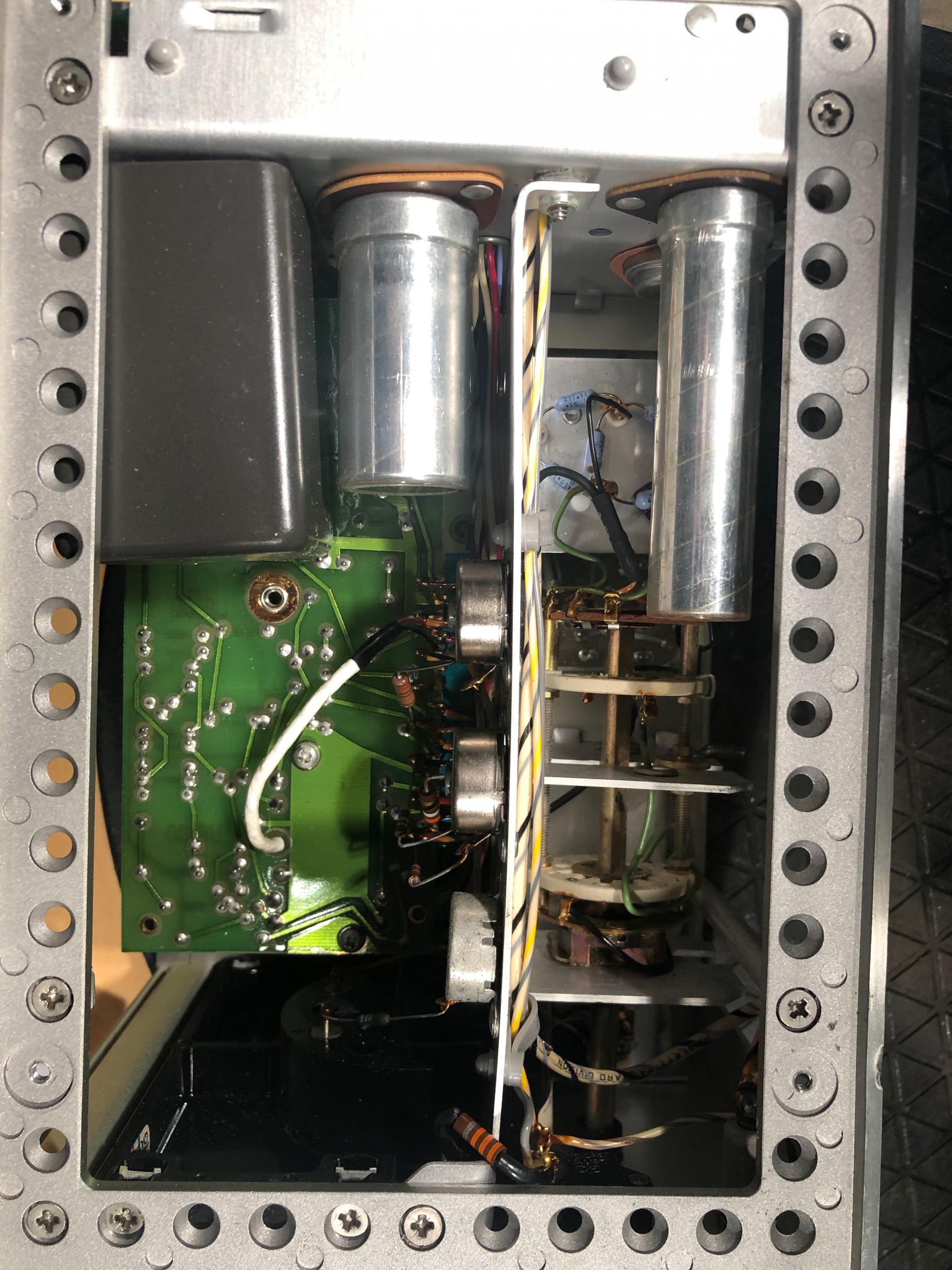

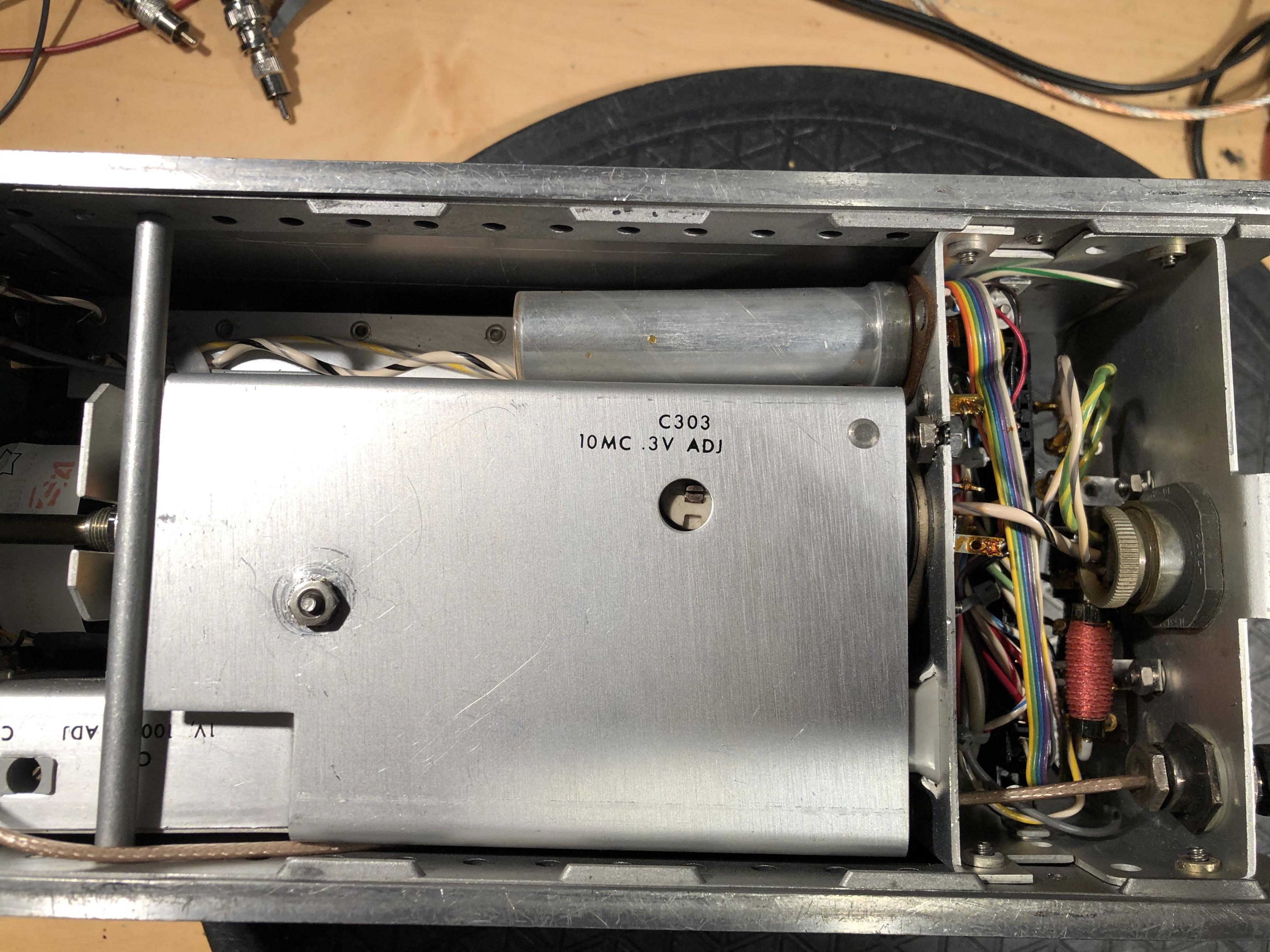

Hewlett Packard "C" modifications are those that generally affect mechanical and cabinetry aspects of a unit and not electrical specifications like the "H" series modifications. I agree with it being a system meter. But not a 400E because the inside picture (post 4) is that of a model 3400A TRMS AC voltmeter. The lower part of the meter scale is also indicative of a 3400A.
The 3400 is a really nice TRMS meter. You were fortunate. The only question would be the power transformer setting. The HP3400 manual should help. 3400A RMS VOLTMETER [Obsolete] | Keysight

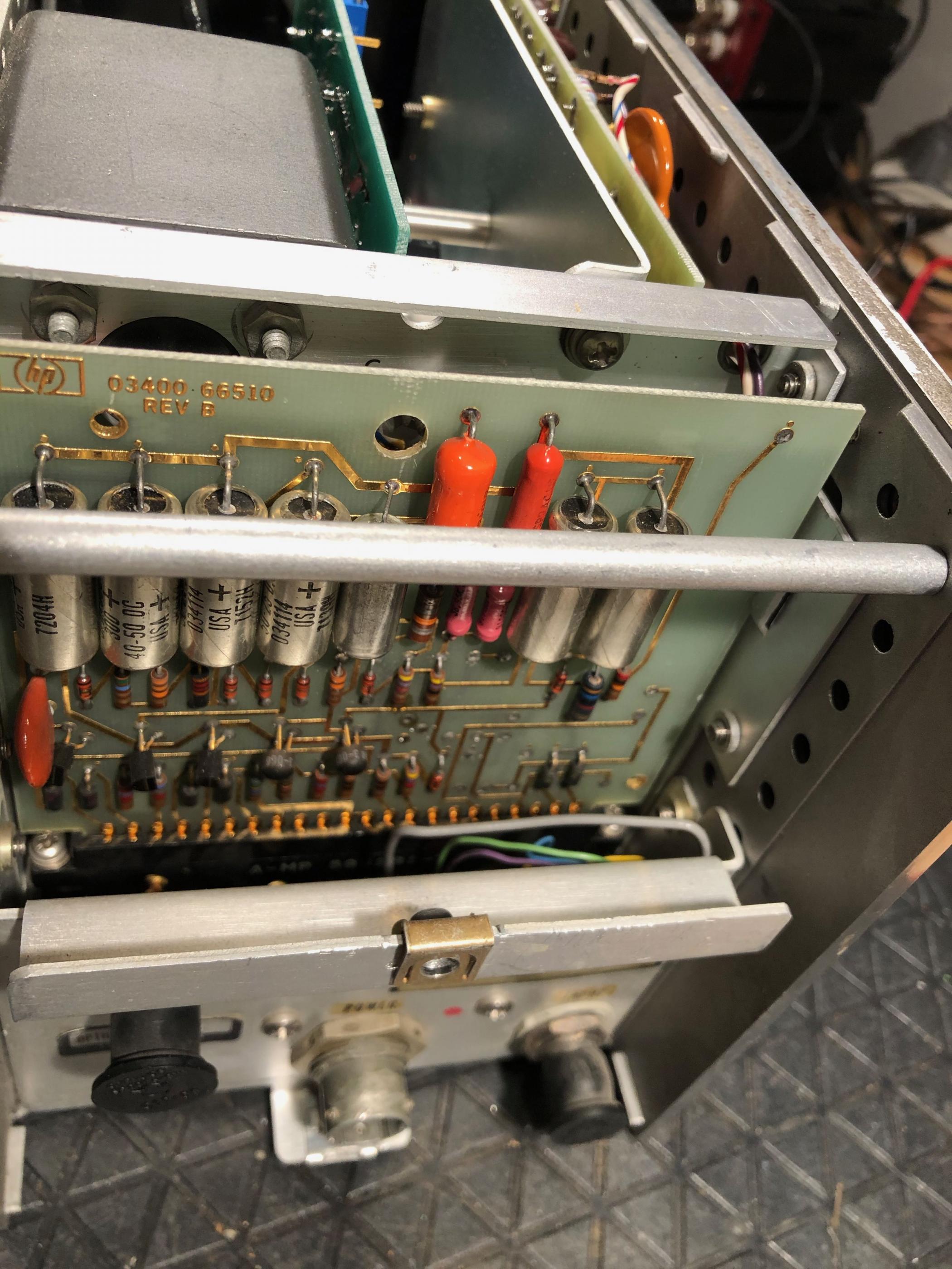

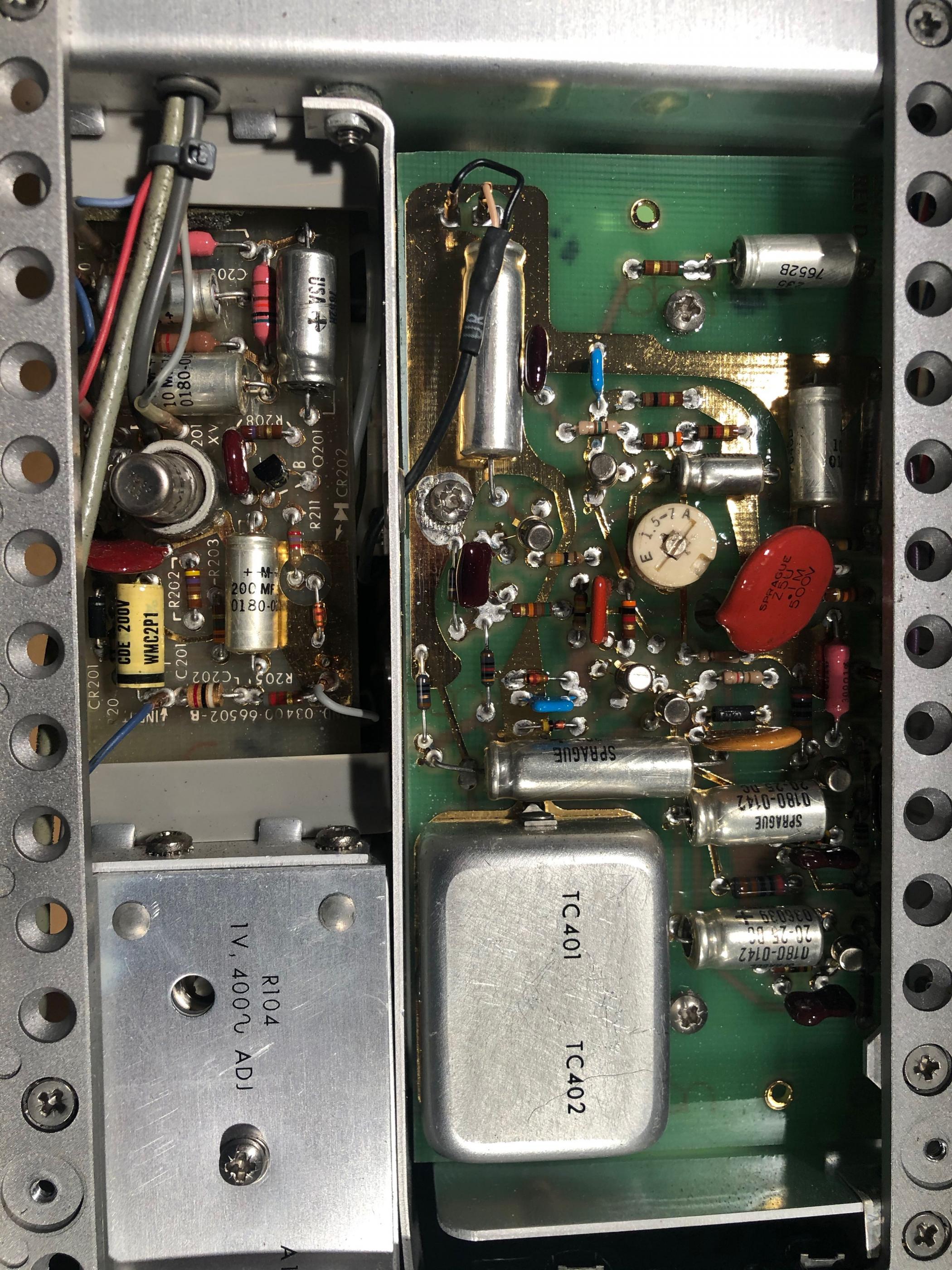

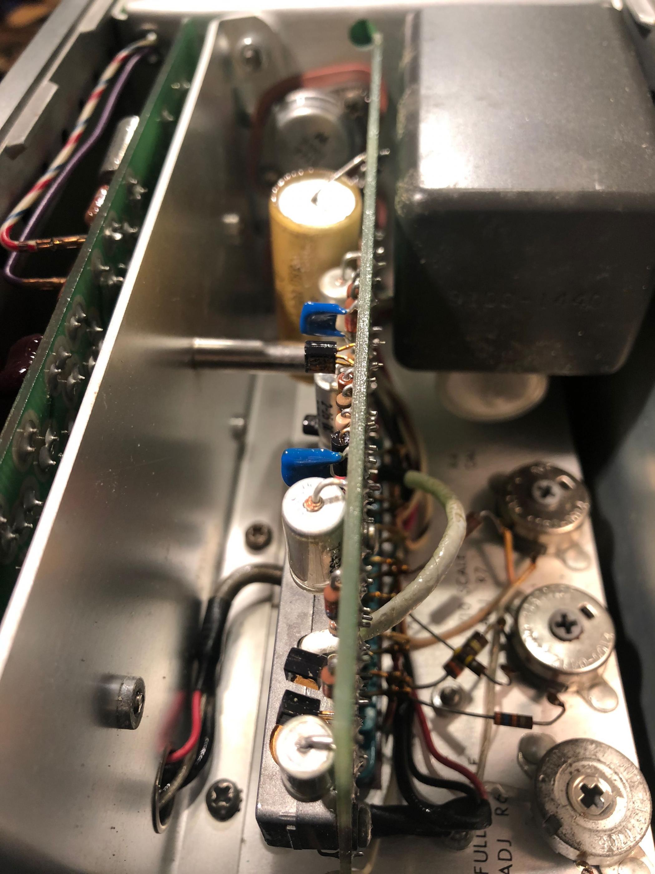

Don't be too concerned with the power transformers. Like most HP trannys they seldom caused trouble. What you should be concerned with is if the meters work correctly. The 3400A has two possible problem areas. The photo chopper and the matched pair of thermocouples in the amplifier feedback loop. The old original choppers were big bricks. Yours, by the serial number, should be the smaller style chopper mounted on the center green fiberglass board. The late versions of this meter had a solid state chopper (chip) with two adjustments on the board instead of pots mounted on the inside chassis. This late chopper board was sometimes retrofitted on earlier models. Symptoms of a defective chopper can be excessive meter jitter or only ½ scale readings on all ranges. The thermocouples can be damaged by overload. Symptoms of a bad thermocouple would be a pegging meter or one that is very sluggish. And if you do get one working well, mount a BNC connector on the front panel with a short piece of wire to the input circuit. No need of shielded wire since it's very near the input. Or just remount the TNC connector to the front and use an adapter.

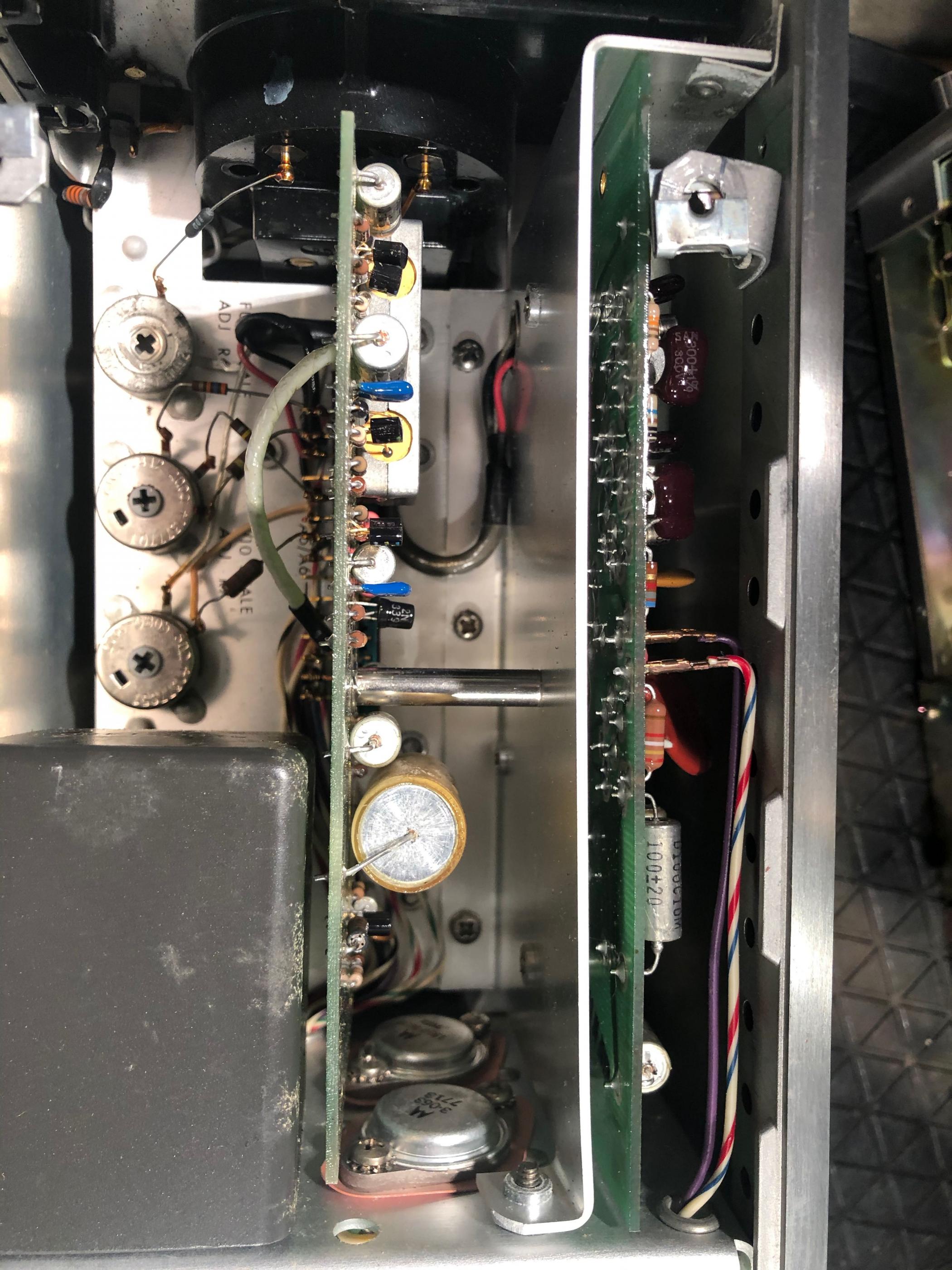

No, that's not the chopper board. It is the input impedance converter board with a 7586 nuvistor tube. They all have that shock mounted board. The chopper board is on the top side center. Just behind the meter. Shoot a pix of that and I'll let you know what you have. From the pix in post 4, you may have the newest style, at least on one, because I think I see a blue trim pot there.
OK, the first two pictures show the chopper board well. It is the rectangular metal box on the green board directly behind the meter. And it's the "small" type that is normally used with a 1218A serial number series. But I "think" that the middle picture in post #4 is a different 3400A then the pictures above. Look at them all and see if the boards are the same or not.
thanks- yes they were two different units, I will check all four to see what is what- much appreciated @HollowState
