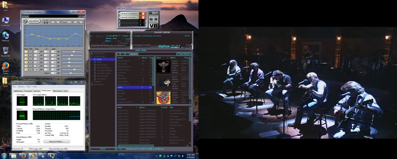

Intel Core 2 Quad is as fast as a modern I5.
What might not be as fast is the ram/bus. but 800mhz
should be good for audio/video.
I have 2 great HTPC's , the core duo does just as good as
the Athlon 4 core. (4 GIG/W7-64 + GT210 video/Asus Xonar sound)

You will "dephile" that quad duo with that.
Linux daphile is made for a atom CPU.
Quad duo is a beast , both fans running at full to cool that 95-135w CPU
down. Intel has speedstep , but I'm not sure linux/daphile can
take advantage of it.
A very loud system that has 50X the processor horsepower required for daphile.
A quad core can do a lot more (below) , running 1/4 speed - still 12%.
Daphiles mobile /wireless features are cool - but made for much
more modest hardware.
