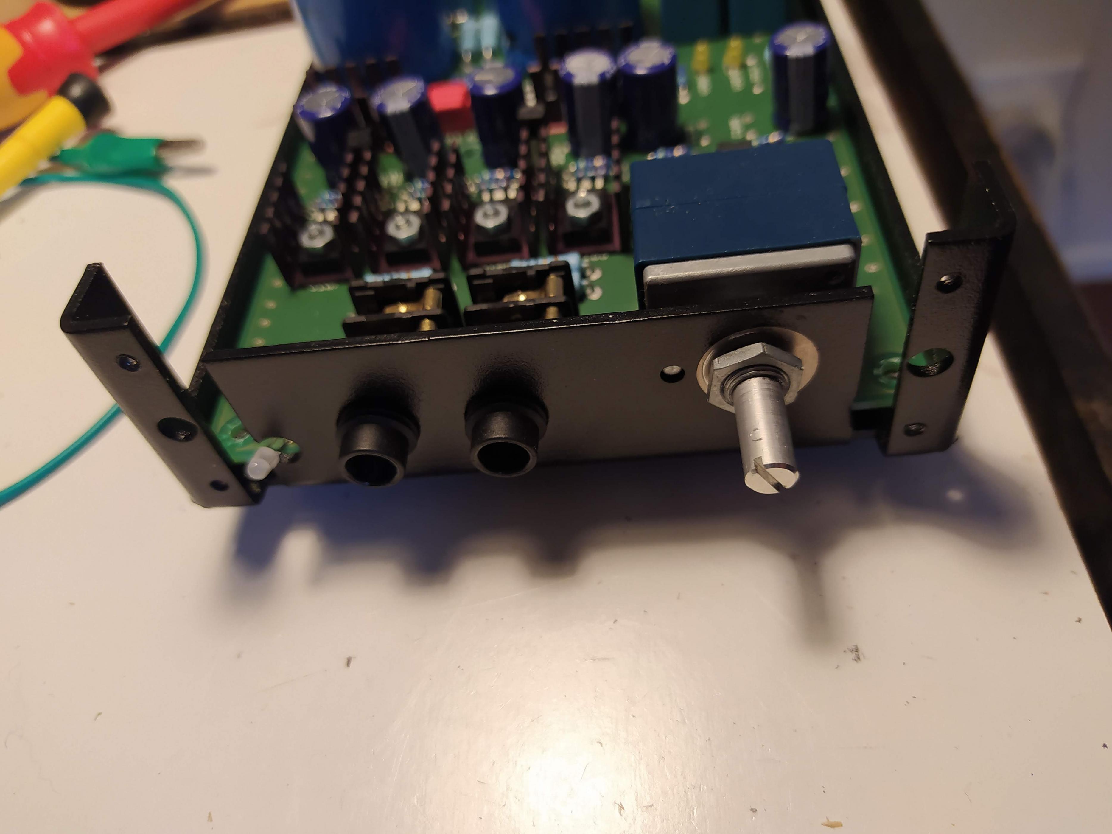

I own an original Lehmann audio black cube linear that has recently started a hum issue.
I know this headphone amp has been cloned many times so am hoping someone familiar could help me troubleshoot.
The symptoms:
When I touch the volume knob I get hum. Both in the headphones and the line out
The hum is louder at high volume and worse when set to high gain settings
When I touch both the volume knob and a grounded part of the chassis such as the RCA connector the hum reduces or goes away.
It does not matter what amps/dacs are connected. The problem is persistent and only if I touch the volume knob.
Where do I start? What could cause this to start occurring after so many years?
Thank you for the assistance.

The grounding is failing somewhere, perhaps between chassis and front panel? Probably
oxidation over the years. The volume pot itself should be firmly grounded to the front panel,
that might be coming loose too (although usually the control would feel loose).

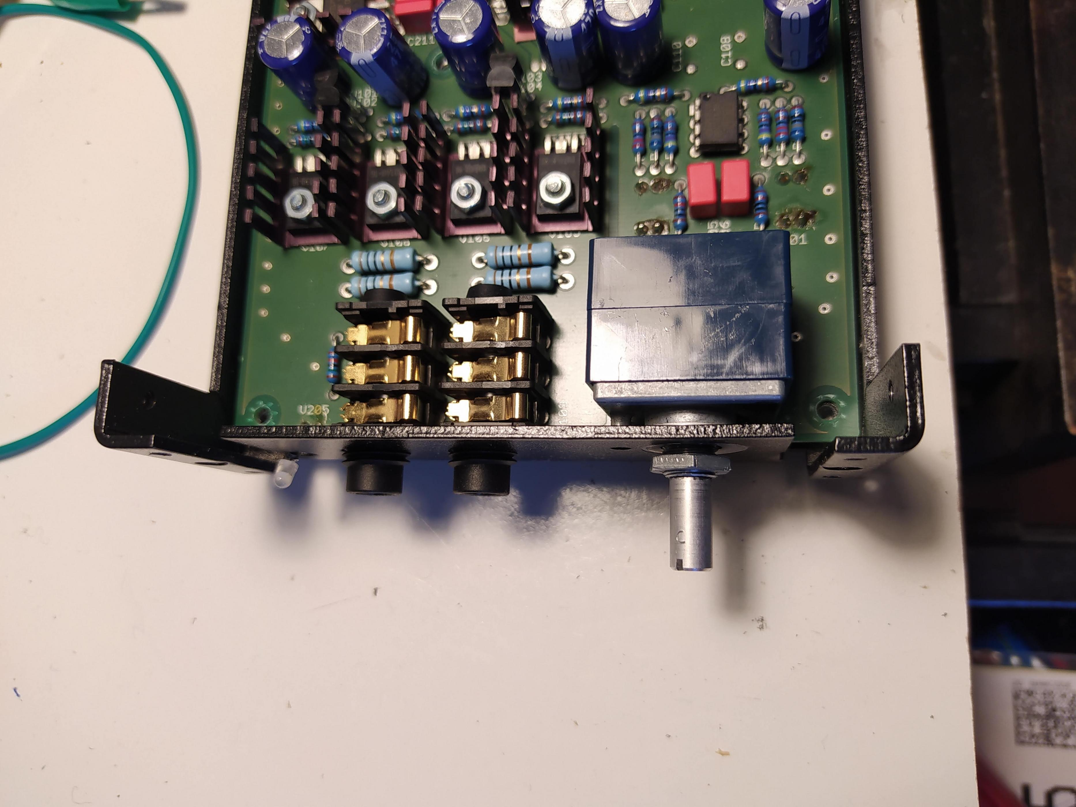

Thanks Mark,
The washer that secures the pot to the front panel was loose.
I tightened it and it fixed the hum straight away. I exaggerated it in the pics.
I'm surprised because I've never taken this amp apart before.
