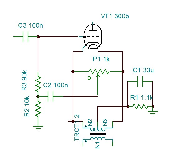

Hum pot implementation on 2a3
Hello folks - I was wondering if someone could help me clarify what I was reading in a post regarding hum pot use with a 2a3. I have tried to draw the schematic that a poster was describing but think I have it wrong. See photo below and any help is appreciated!
Apologies!! These quotes were from Palustris (left) and Kmaier (right).

1. The schematic on the left has finer Resolution (easier to find the spot of lowest hum), but has less Range of adjustment versus using the 50 Ohm pot by itself. Use that schematic if you have enough range to find the sweet spot.
If you are worried about getting optimum performance out of a 2A3, you might consider using very well filtered DC for the filaments. But that takes new filament transformers, and more parts and space.
DC filaments gets rid of the intermodulation of 2X power mains frequency (100 or 120Hz) that appear on each and every music tone/note. The intermodulation tones are generally fairly small, but can be quite large, especially when the music is being played at or near full amplifier output.
I designed and built 2A3 amps with AC filaments. I liked them, and so did those who heard them.
But if I ever build a 2A3 amp again, I will use DC filaments this time.
2. The schematic on the right does not have any DC path for the 2A3.
It shows the self bias resistor connecting to the Center Tap of the 2A3 filament (that is the DC path).
But the 2A3 does Not have a center tap.
Well, there is a 'Pseudo 2A3' from one manufacturer that does have a center tap.
I would worry that the quite expensive 'Pseudo 2A3' might not sound as good as a real 2A3. And if that manufacturer no longer makes that tube,
you would not have a replacement.

I fail to see how the circuit on the left would have finer resolution... it doesn't. The balance solution there is common, i.e., the DC and AC balance are linked. The padded pot certainly helps with minimizing the hum level, as it effectively decreases the impedance of the filament to ground. The circuit on the right (loosely drawn from an old post of mine) is incorrect.
As you noted, there's no center tap on a 2A3. The actual schematic would have the cathode resistor connected to a center tap on the 2.5V filament transformer to ground. This results in a fixed DC balance to ground and an adjustable AC balance to ground, also using a padded pot. The adjustment range for both circuits would be identical, as you can swing the AC balance from one filament leg to the other. Using padding on both pots, a 100 ohm pot would yield a finer resolution over a 50 ohm pot.

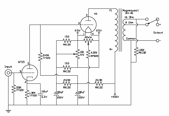

You are half right. The range is the same, but the resolution with the wiper at or nearly centered is finer.
1. Start with a 50 Ohm pot that is connected to the ends of the filament. Now, connect the wiper to the top of the self bias network (self bias resistor with the bypass cap in parallel) to ground.
With the pot centered, it is 25 Ohms from the wiper to either end. The adjustment is 100%, end to end as the pot is rotated.
2. Now, connect a 15 Ohm resistor to one end of the filament, and the other end of the 15 Ohm resistor to the wiper of the pot, and to the top of the self bias network.
Connect a second 15 Ohm resistor to the other end of the filament, and the other end of that second 15 Ohm resistor to the pot wiper, and to the top of the self bias network.
Using the 15 Ohm resistors, and with the pot centered, from one end of the filament, we have a 15 Ohm resistor in parallel with 25 Ohms of the pot, that is 9.37 Ohms to the top of the self bias network. And we likewise have another 9.37 Ohms from the other end of the filament to the top of the self bias network.
Do a little analysis of that circuit, and you will find that the range is the same when the pot wiper is turned fully CCW or fully CW . . .
But with the pot wiper near the center, the effect is like a gear reduction, the same 5 degrees turn CCW or CW from center will have less effect than the circuit in 1. above.
For example, try with the wiper at 23 Ohms from one end, and 27 Ohms from the other end.
Do that for 50 Ohm pot only, and no 15 Ohm resistors.
Do that for 50 Ohm pot plus the two 15 Ohm resistors.
The range of the pot is the same, but now it is easier to land on the exact sweet spot, as long as it is anywhere near the center rotation.
Yes?
No?

We are in agreement on using a set of padding resistors on the balance pot. Also, as part of the analysis, you can take the 9.37 ohms and half that, as the two legs are in parallel to the "cathode". The circuit on the right has it's balance pot configure the same way, albeit with a 100 ohm balance pot and a pair of 12 ohm resistors. The difference is 9.67 ohms instead of 9.37 ohms, which is not going to be significant. The only difference (assuming a correct schematic) would be the fixed DC balance via the filament transformer.
So, you stated that the circuit on the left had finer resolution. Based on the above, it doesn't. In short, the 100 ohm pot would allow a finer resolution based on your own description above.

On a filament transformer without a center tap, can one be created with 2 resistors and the cathode resistor connected from there to ground? Then connect the cathode bypass cap from the humpot wiper to ground? In this configuration, would the padding resistors be needed on the humpot?
Without a center-tap on the filament transformer, the split balance technique would be different. You could implement a separate DC balance and AC balance, or just use a combined one (AC and DC balance linked) as in the initial image on the left.
Linked below is a schematic that shows a pair of balance controls... AC and DC. However, I would note that the DC balance doesn't add that much... however, one could, as noted, use a pair of resistors to provide a virtual center tap for a fixed DC balance and then implement the separate AC balance.
https://www.diyaudio.com/forums/att...gulated-supply-direct-coupled-amp-mq_45se-jpg

Using a pair of resistors for a virtual center tap and using it for a fixed DC balance is fine, but also realize that the resistor pair does two things: 1- They become part of the self-bias resistor value. 2- They also present an additional load to the filament current. Granted, the added current will likely be small, but if you use a pair of 100-ohm resistors, they effectively act as a 50-ohm bias resistor and should be accounted for in your overall bias voltage/current.
For the AC balance pot, I've always used a 100-ohm 2-watt linear pot. In general, a pair of 12-ohm resistors for padding is what I use. Also note that this setup presents an additional current load to the filament current and should be accounted for. Also note there are two reasons to pad the balance pot. 1- To allow a finer adjustment for the hum level, i.e., not a knife-point 2- provide a lower effective resistance in series with the bypass capacitor, which allows better nulling of the AC hum level.

The right schematic has a 100 Ohm pot, yes of course a 100 Ohm pot has more resolution with the 12 Ohm resistors. But as already noted, the schematic wiring either needs to be changed, or list the exact model number of the "2A3" or "45" tube (that has a center tap).
I am sure someone on the forum will try and build to the right side schematic without reading the text below, and then wonder why it does not work with a real 2A3 or 45.

The 45 amps I designed and built back in 2008 have respectable ratings:
- 25Hz - 50KHz within 1dB at 1-watt output
- 2.25 watts RMS before clipping
- 0.35% THD at 1-watt (1KHz - less at higher frequencies)
- Hum and noise output around 150 microvolts (16-ohm output) - ~88.5dB below 1-watt.
And these specs are with AC filaments and a zero-feedback design. Granted, hand-selected and tested tubes from a pretty large stock, but still, they perform very well. I guess in some ways, I just don't like the concept of a DC filament supply on the 45 triode. Most others, as noted above, simply won't yield acceptable results with an AC filament supply.
