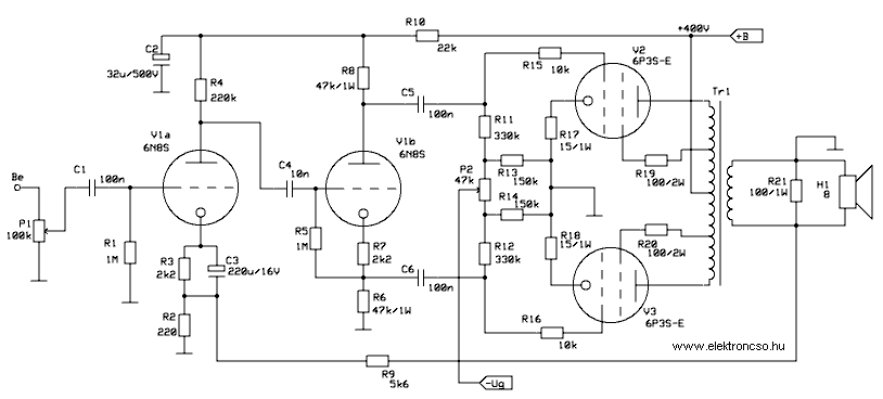

My son wants to build his first vacuum tube amp. He is a senior mechanical engineering student. I'm thinking something with a minimum power rating of 20 watts so something in the push-pull camp using 6SN7s and 6L6/5881 only because I have a good inventory of each. I also have many of the 9 pin 12 family but I prefer to use the 6SN7 on the front end. I only need the audio portion of the schematic as I can help him design the power supply from scratch. If anyone has any ideas, I'd be very appreciative.

This looks quite nice - and remember that a 7N7 is equivalent to 6SN7, so tubes are exactly what you want
Push-Pull 5881/6L6 Amplifier | Evil Science Audio
The Oddblock octal is also quite intriguing, I like the 317HV as the cathode CCS
OddWatt Audio 5751 SRPP / KT88 Push-Pull Monoblock Tube Amplifier Kits

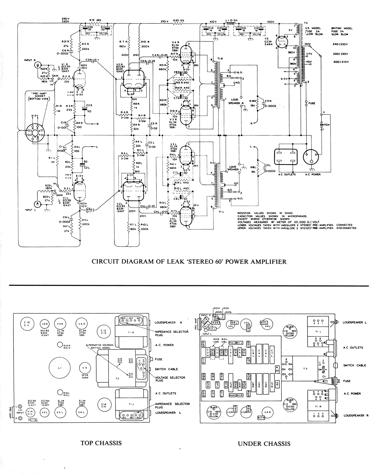

It's hard to argue against the classic Williamson -
![WilliamsonAmp_1947.jpg](https://www.preservationsound.com/wp-content/uploads/2012/01/WilliamsonAmp_1947.jpg)
If you can source a good pair of output transformers with screen taps, you could recreate an original Williamson amplifier modified for Ultralinear operation. That's a classic using 6L6 type output tubes and 6SN7s.
Page 8 in the Acrosound catalog, using the Acro TO-300 output transformer (6.6k:16,8,4):
http://www.tubebooks.org/file_downloads/acrosound.pdf
https://www.pearl-hifi.com/06_Lit_Archive/02_PEARL_Arch/Vol_01/Sec_02/105_UL-ing_the_Williamson.pdf
http://www.tubebooks.org/file_downloads/stancor_ul_schematics.pdf
