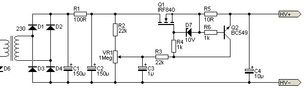

I’m hoping to get some help on a project I’m looking at doing. I want to build a bench power supply for my LAB that will provide a variable DC supply at about 100mA from a 240v ac supply from my bench isolation transformer.
The reason for this supply is to test valve amp projects before building the final circuit. I wanted the supply to be variable from about 10v to the full 300v dc.
I have already constructed one design attached in image 1 below which for voltage control from 0v to 300v worked very well. However I have found that the output voltage can swing high when switching on as it is unregulated. I tried the circuit powering a heater element at 45vdc and when switching it on the voltage spiked to 55vdc then back down again. This destroyed the valve filament.

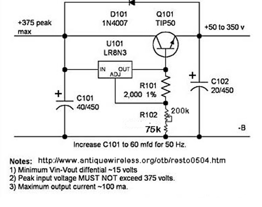

I am looking at the other circuit in image 2 which is a regulated supply. Has anyone built this and is it stable. What sort of output current could I get from this circuit.
I have an idea to build the first unregulated circuit for the plate voltages as this can be fairly unregulated, and then the second circuit for the heater elements at a lower input voltage about 80v ac.
Any help would be much appreciated I am a newbie to this I have experience with HV circuitry but not with designing the circuit.

i started this to get other views. Its progressing I have a variable power supply from 0-300 VDC but not yet regulated

Designing and building a high voltage regulated power supply so it is safe and reliable is significantly harder than designing basic audio equipment. I would not start from here.
Instead, build a PSU which provides both a cap input PSU and a choke input PSU from the same secondary. That way you get two voltages, which can cover most common needs. I did 200V and 300V (nominal). Few valve circuits need regulated voltage rails.

Thanks for the link this will be a good one to keep. The power supply on this is tube based. i have seen these and thought about doing it this way but for a bench power supply and for cost purposes i would prefer a solid state regulation. I have found on ebay a solid state variable power supply which i am considering link below

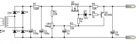

Maximum voltage obtained unloaded (~10ma :bleeder resistor 33k) 334v: astonished due to the tube's characteristics:

On this schematic there is a 0,1 capacitor between grid and output in front of potentiometer,how should i calculate it please ?

You dont really have to, that capacitor is there to direct AC from the main output bus, its a high pass filter, that is not too critical to the functioning of the circuit. 47n-470nF will work OK.
Furthermore you can get a lot better gain by putting the error tube 6SJ7 in pentode instead of triode strapping it. for that the output divider with two 10K 3W resistors will suffice.

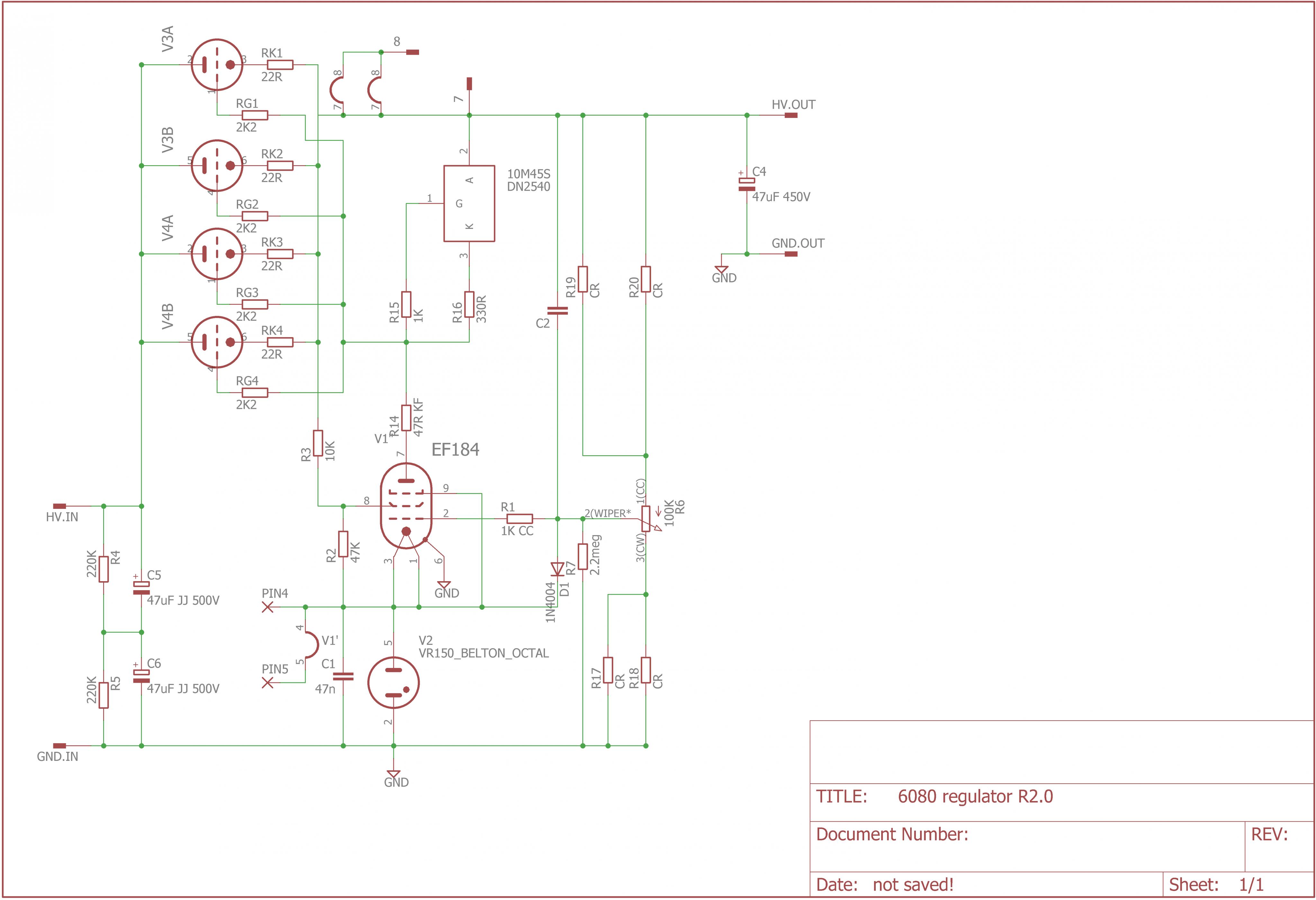

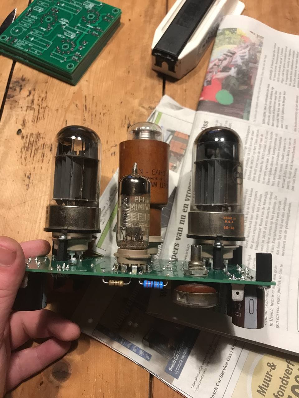

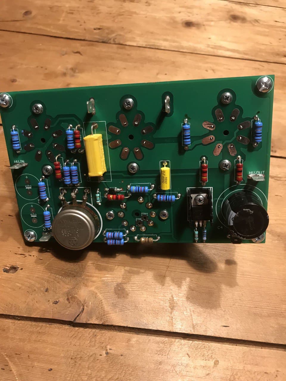

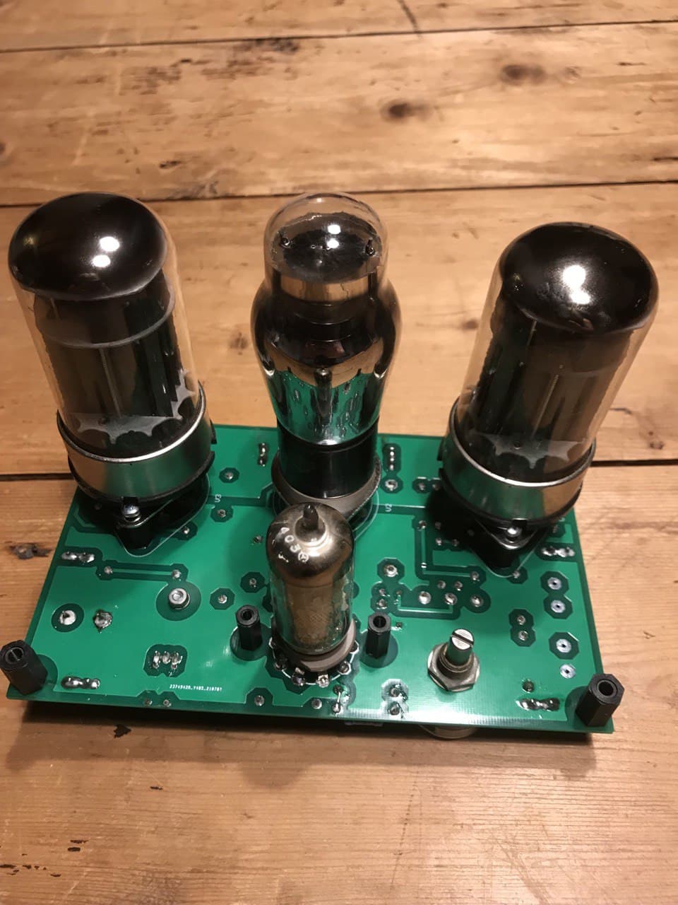

Here are photo's of a supply i built using two 6080/6AS7G tubes, VR150 reference(0D3) and EF184.
Theres a bit of theory behind these kind of supplies, ideally you want the EF184 to have a lot of gain, so it can counteract the ripple more effectively. I solved this with a 10M45S current source, if you load a pentode with a current source, you increase the gain by quite a bit. (Up to ten times last time i did some calculations)
If you want i have a few PCB's for this project leftover, they have one little error but are usable.
....if you load a pentode with a current source, you increase the gain by quite a bit.....
Oddly, the plan in #17 seems to run a pentode as a triode, leaving a lot of gain un-used.
