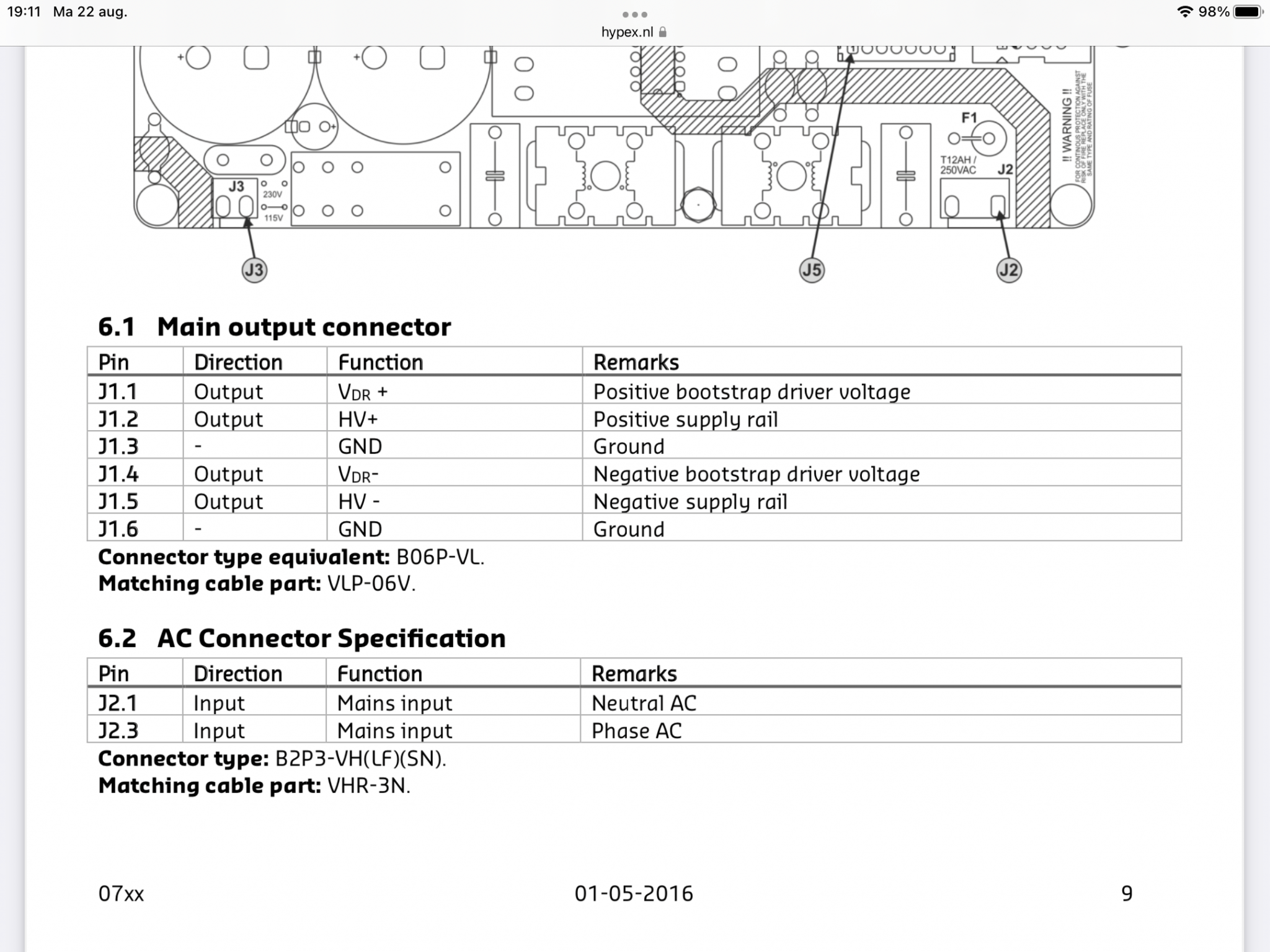

Anybody knows what exactly is this type of connector and pins (6 pin power supply connector)?
Trying to find it on Farnell, but without success.
