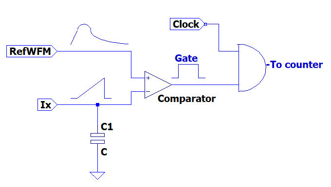

You can integrate the current with a simple capacitor, and compare the resulting voltage ramp to a suitable reference waveform. This will generate a gating window, proportional to the logarithm of the current. Converting a time period into a digital form is then the easiest thing to do.
Feeding the unknown current directly into an integrator has a number of advantages: a current can cover many decades without being affected by thermoelectric voltages, and the integrator has an inherent low-pass behaviour, helping to filter the noise.
The slope-based nature of the converter lends itself to auto-zero and offset elimination: switches are needed anyway to reset the integrator(s).
In its simplified form, the circuit would look like this:

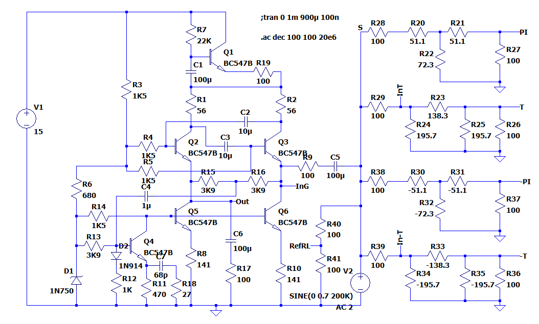

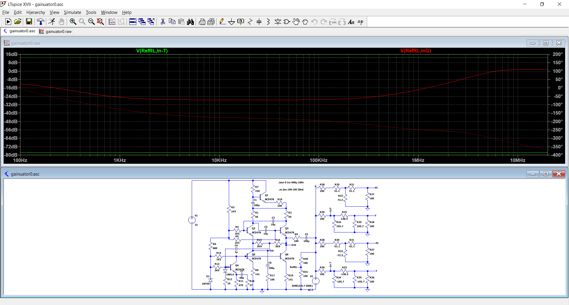

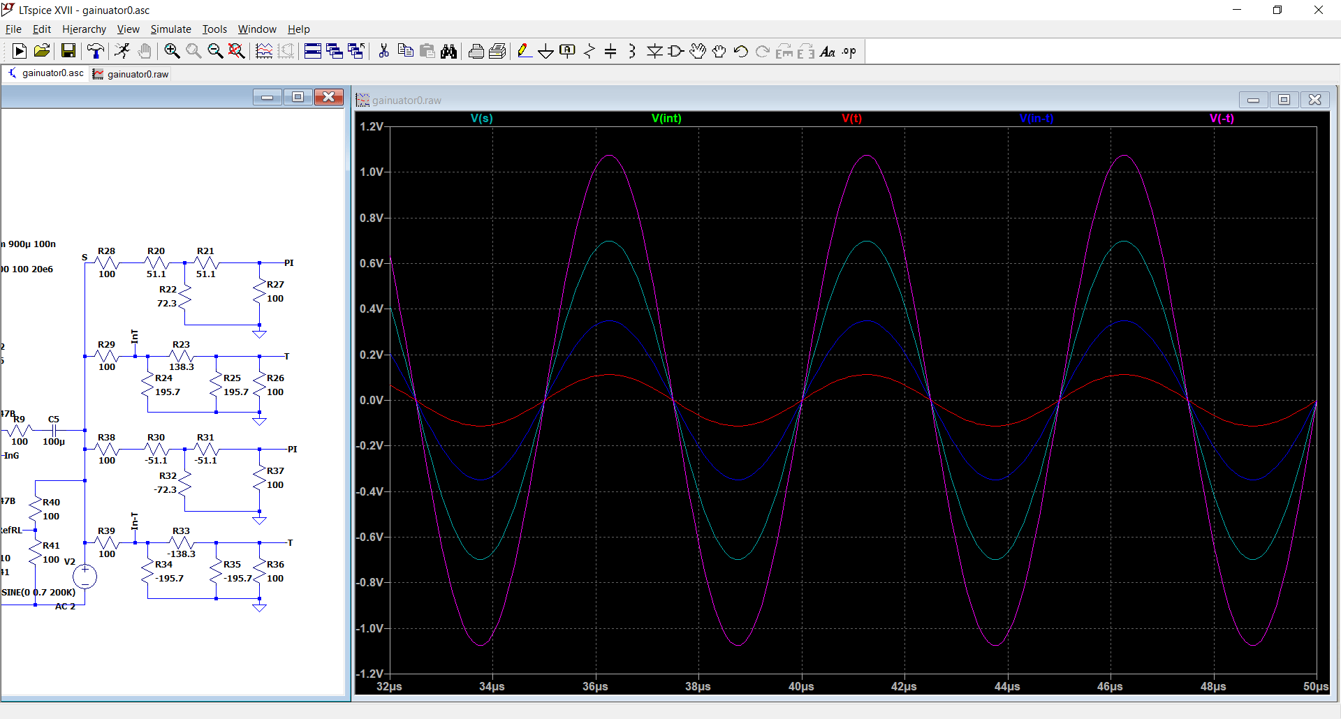

Back to the gainuator: ever wondered how an attenuator built from negative resistors would behave?
Here is the answer: all four circuits are ~10dB attenuators, built for a 100ohm characteristic impedance. Some are in the T format and other in the PI one. The two bottom ones use negative resistors, something allowed by spice simulators.
You might think that it would be unstable or unpredictable. Not at all: trace S (cyan) is the source, traces InT and In-T show the signal after the input matching resistors (blue and green traces superposed), and the red and magenta traces are the outputs of the regular and negative T attenuators, respectively.
As expected, the red trace is 10dB down, but the magenta is 10dB up.
This means that the input impedance of the negative attenuator is real and positive (blue and green traces are undistinguishable), and instead of an attenuation it provides an amplification.
This can be demonstrated by computing the values of the characteristic impedance and attenuation for negative components.
This means that this negative attenuator is in fact an amplifier. Nothing to write home about: there are many ways of building an amplifier, using less exotic methods. But this one is completely symmetrical, and therefore bilateral: input and output are completely exchangeable.
This becomes more interesting, but bilateral amplifiers or repeaters already exist: they are typically made from two distinct amplifiers and two directional bridges to separate and recombine the Rx and Tx directions.
Anyway, such a negative attenuator is completely hypothetical and chimerical, and could never exist outside of a simulator or the mind of a deranged electronician. Or could it?

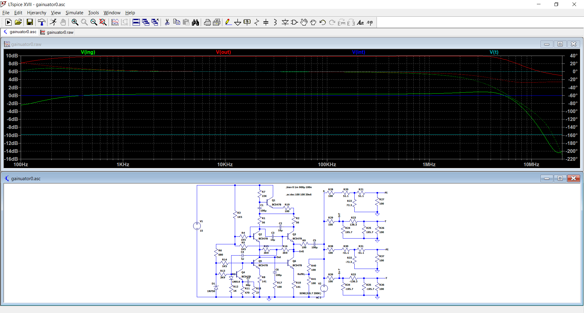

Let's look at this circuit:
InG and InT are practically identical (green & blue), meaning the input impedance of the "Gainuator" is 100ohm, just like the regular attenuator, but the outputs (red and cyan) are 20dB apart: +10 and -10.
This means that this circuit actually behaves like a negative attenuator.
The actual configuration is difficult to classify: it is mostly a PI configuration, but with a hint of T. There is a middle, floating negative resistor, but the shunt parts are made from two negative resistors fed from a T center point. It is thus a kind of hybrid, but the important thing is that it actually works.... In sim at least. It could be pie in the sky.
Not really:

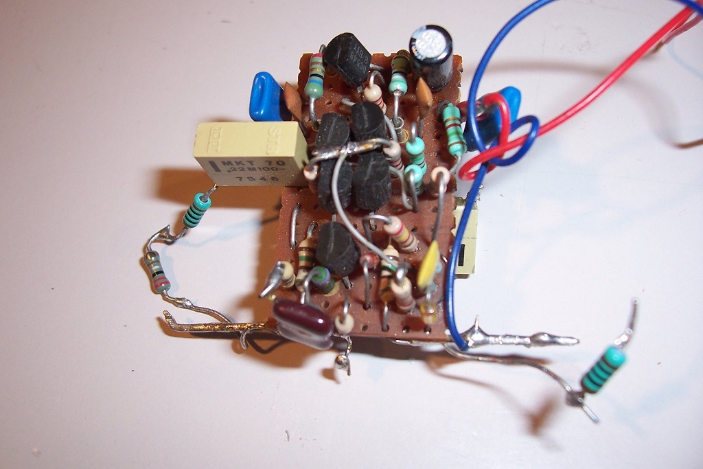

This has actually been built and tested as a bilateral repeater for DSL signals.
Note that the concept of negative resistors is not new in the field of telecommunications: repeaters made from "negistors" have been developed, but they could only be used for minor gain corrections, because the negative resistor changed the characteristic impedance and degraded the return loss.
The concept of a complete negative attenuator addresses this issue, and remains simpler than all the hardware required by two separate amplifiers and coupling circuits.

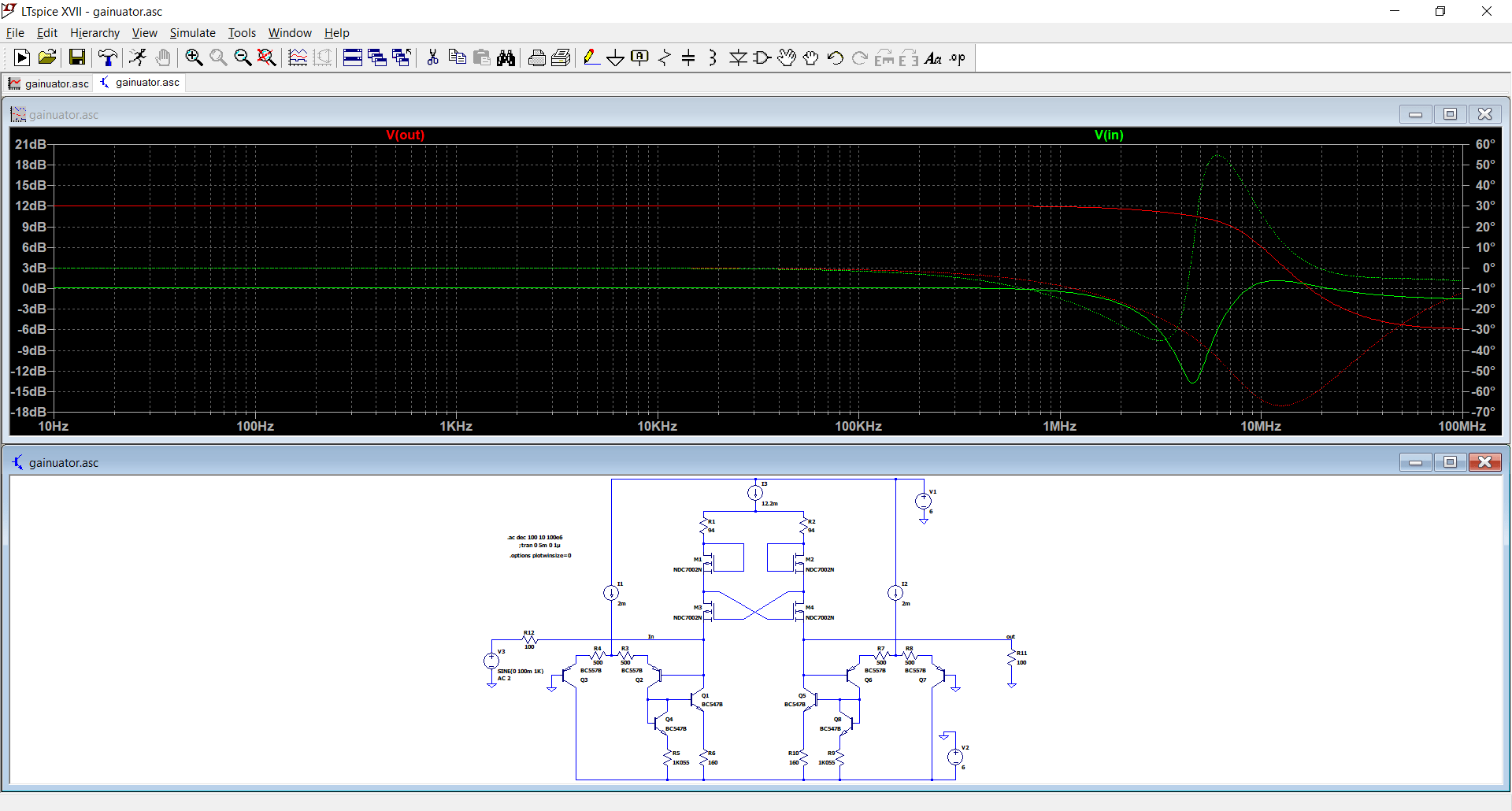

Here is a short description of the circuit:
The cross-coupled Q2 & Q3 synthesize the series resistor of the PI attenuator (the analogue of R33 in the simulated version). They need to see an impedance in their emitters in order to achieve that.
The impedance is formed by the I/O lines, and two other synthetic negative resistors generated by Q5 and Q6, with the help of Q5 which amplifies and inverts the average of the I/O ports thanks to R15 & 16.
The two inversions result in a positive feedback, causing the negative resistance behaviour.
In order to keep the series negative resistor floating, the whole circuit is fed by a gyrator built around Q1.
The circuit is far from perfect in its implementation, mainly because of the need to include resistors to bias the transistors. These parasitic resistors somewhat upset the ideal synthesis of the gainuator.
This can be seen in the return loss figure: -27.5dB at best, against -77dB for the purely synthetic one
That said, anything better than -25dB is deemed excellent in real life, and the circuit could be refined further. It is probably even possible to use the circuit itself to cancel its own parasitics, but that would require some brain-twisting exercises.
This is far from the only possible implementation: this time a purely PI type, with no hint of T present:

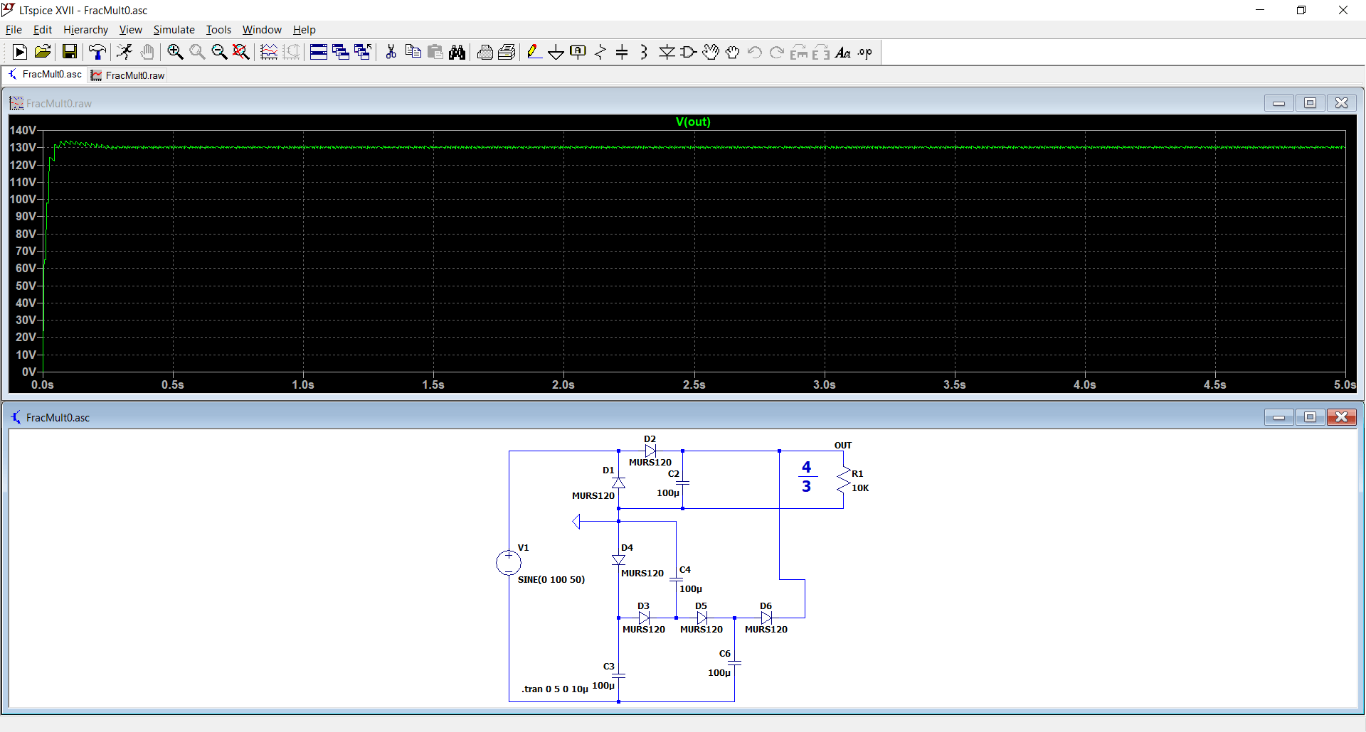

And here is the proof:
It is a working example of 4/3rd multiplier (I can see some of you frantically typing, trying to find a precedent, but I don't think it will return a hit).
At first sight, exchanging fractional charge quantities using just "dumb", autonomous switching devices seems impossible, but a workaround is possible: if you connect the inputs of two different multipliers in series, and their outputs in parallel, they will have to split the charge and find an equilibrium satisfying the input and output voltage conditions for both.
In this example, the upper multiplier is a doubler, and the lower one a quadrupler.
Let's call the input of the upper one V1, and the lower one V2.
We can write: 2*V1=Vout and 4*V2=Vout, and also V1+V2=Vin
We can sum twice the first equation to the second: 4*(V1+V2)=3*Vout. As V1+V2= Vin, 4*Vin=3*Vout, thus Vout=4*Vin/3.

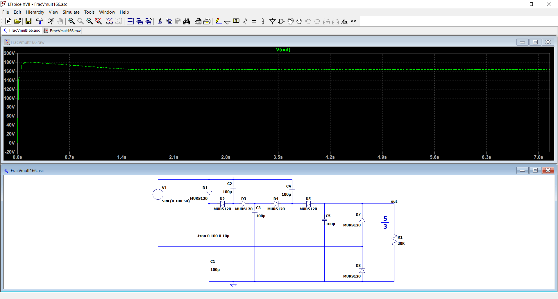

Other factors are possible; in fact, the number is ~limitless, but in practice very complicated ratio's are not very advantageous, because they require lots of components.

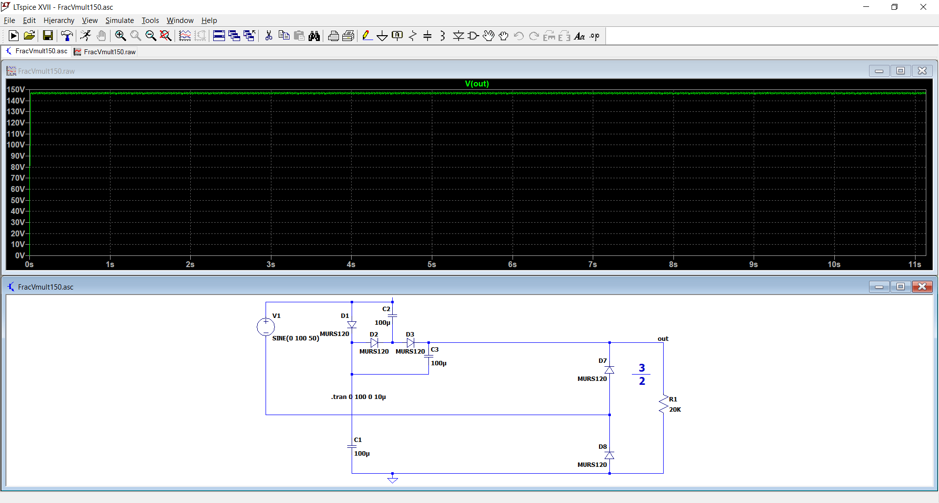

The 3/2 ratio is particularly interesting: it has a reasonable parts count, and sits just between a plain rectifier and a doubler. Many DIYers have been confronted to the situation where a transformer delivers a voltage just too low with a simple rectifier, but much too high with a doubler. The 3/2 option is a neat tradeoff in this case.
Here are some more examples.
First, the 5/3 (1.666x) one:

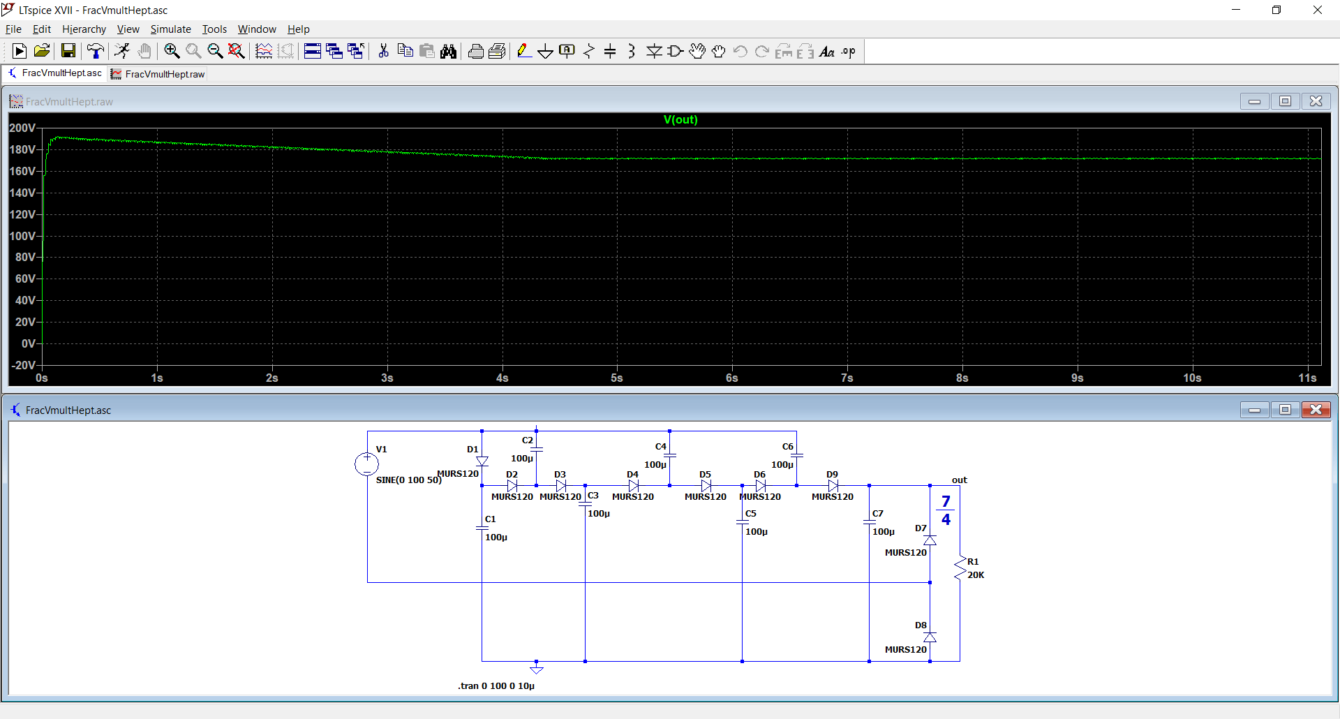

Then, the 7/4 (1.75x):
Many other values are possible using the same principles. Nowadays however, the usefulness of these circuits is reduced: to squeeze the last % of possible efficiency out of a supply, the rectifiers use controlled switches anyway: active bridges, etc., and they allow any fantasy when driven suitably.
For DIYers, these circuits make sense: they are not obsessed by efficiency, and the scheme allows the use of transformers that would be useless otherwise.
For industrial, EHV circuits, they could be useful too: at voltages >>10kV, stacking is necessary, and the need to add a drive circuit to control the switch adds to the complications. Diodes are two-terminal devices, and they can be connected in series without great difficulties.

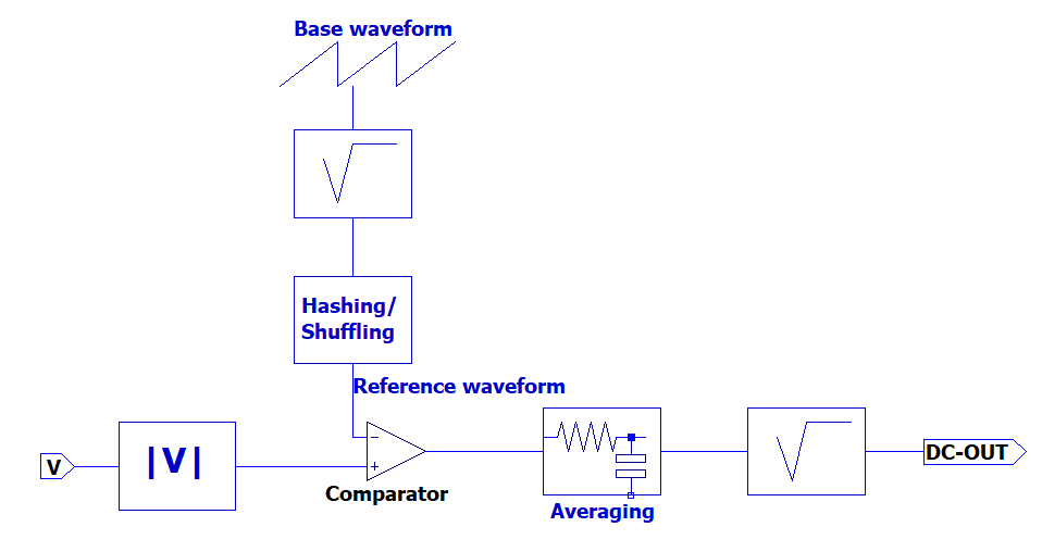

This is a possible example:
A reference waveform is compared to the input signal, preferably passed through a precision rectifier, AKA absolute value circuit.
The reference waveform is a processed √t starting like that:
If you compare any waveform to this modified sawtooth, the averaged result will always be the mean square value. This is valid for any waveform or any frequency: the incident signal can have a much higher or a much lower frequency than the reference, it doesn't matter provided the averaging time is long enough. You have to take my word for it: if you wanted a formal proof, you are ~40 years too late. Nowadays, I don't bother writing equations, I just rely on my sixth sense (AKA gut feeling): I simply know it is true. For a steady DC voltage, it is trivial, for other signals it is less obvious, precisely because it is a stochastic process: if you try to decompose the resulting squarewave into individual bits, none of them makes sense in isolation. Only an average taken on a sufficient number of samples will converge towards the desired value.
Once you have the mean square, you just need to take the square root to arrive at the RMS value.
This simplified scheme has an issue though: if the waveforms frequencies or their multiples/submultiples are close, beat effects due to aliasing will appear, making the end result fluctuate, or even stay stuck at a wrong value in case of synchronism with an unfavourable phase.
That is the reason for the hashing/shuffling function block: you cut the initial waveform into a large number (1024 for example) of small pieces, and you rearrange them in a different, random order. The next cycle, you do the same using another sequence, etc etc.
With 1024 samples, you must have something like 1024! sequences possible, which should be sufficient to last for a century or two.
The result will look like white noise, except the amplitudes distribution will be skewed, and remain the same as the original waveform, meaning the conversion process will work in exactly the same way.
The difference is that with a random, noise-like waveform, no coherence is possible, and all the aliasing effects are eliminated.
Note that the block-diagram above is mostly explanatory: the real implementation would be somewhat different.
Firstly the reference signal generator would be digital, a µC or FPGA with a D/A convertor.
Secondly, the final √ function would be implicit rather than explicit, like in many similar converters: it simplifies the circuit and improves the dynamic range.
And finally there would be no absolute value generator: a big advantage of this scheme is the combination of extreme speed (sub-ns comparators are no problem) and fine accuracy: a good comparator can resolve much less than 1 mV.
A conventional absolute value circuit would have trouble keeping up with such performances, and would ruin the ability to process accurately small amplitude, high frequency signals.
The best method would be the duplication of the circuit: one for the positive, and its complement for the negative. They would then be combined in a digital gate before being averaged.
This method has the potential to match the best present ones regarding dynamic range and resolution, but at speeds close to RF.

The circuit is minimally simplistic and has no protection against aliasing, but in practice it is never noticeable, unless you are really determined to cause it (I carefully tested this aspect before including it in the final build).

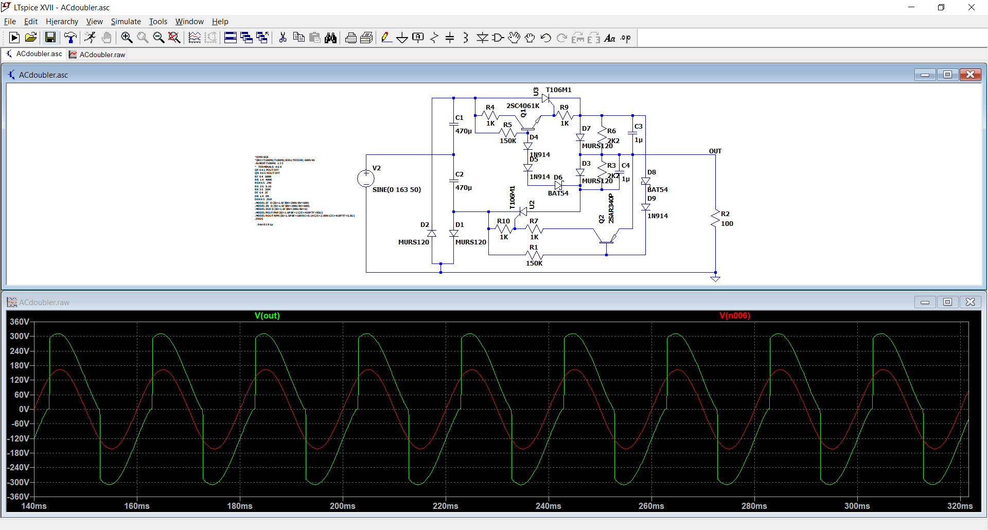

A transformer-less AC voltage doubler
Here is a lighter, but possibly useful idea.
It is a voltage multiplier, but it operates fully in AC, input and output. It can convert a 115V mains into a 230V output, and could be of some use to DIYers on the other side of the pond: when you want to convert an exclusively European equipment to the US mains, you have the choice between changing the internal transformer (or supply) or using an autoformer, none of which is very appealing: no one likes the idea of butchering an equipment or adding a bulky, heavy piece of kit to the existing setup.
This converter is purely electronic, takes little room or power, and could generally be tucked inside the equipment to convert, without any visible exterior sign.
It is far from perfect: the frequency will remain 60Hz, not 50, and the waveform is not sinusoidal, but it isn't too aggressive either.
In practice, the transistors can be MPSA42/92, I used these types for simulation convenience

I think that your fractional voltage multipliers would be very useful for those of us building tube amplifier supplies with off the shelf power transformers. I 'm already thinking of a power transformer I have that has never found use because of it's 'inconvenient' winding ratio.

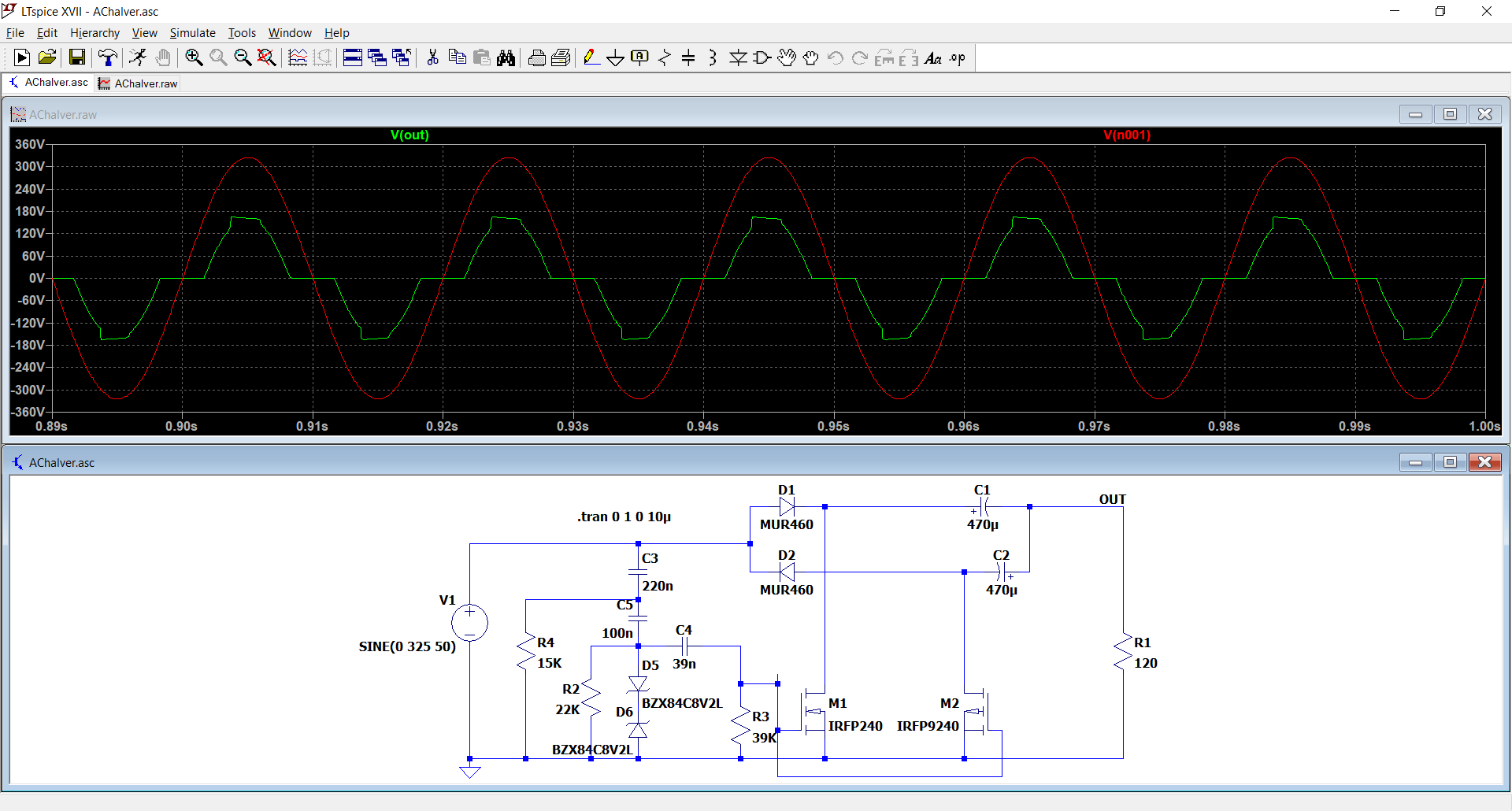

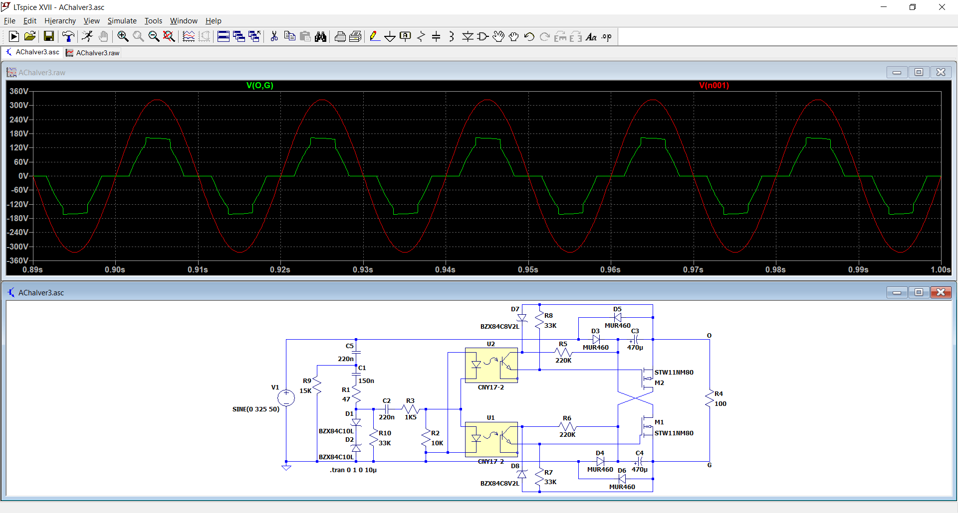

AC voltage halvers
For the sake of completeness (purely), here are the "dual" equivalents of the previous one.
They change a 230V input into a 115V output, and they don't rely on a transformer, of course. In their present form, they are purely conceptual: they have never been tested or used, not even breadboarded.
They certainly have issues: for example the startup/inrush behaviour, but if someone needs such a function, they are a good starting point/initial framework to start with.
Here is the first, simpler version:
Its problem is the use of a power, high-voltage PMOS, which are very rare beasts. They need to withstand the full peak input voltage, plus some margin, at least 400V, preferably 500V or 600V.
The sim cheats with a 200V IRF9240.
This variant is more complex, but it only uses more common N-types:
Both are based on the same principle: a constant voltage is subtracted from each sine arch. The voltage is stored in capacitors, and the complicated part of the scheme is the removal of the excess charge of the capacitors after they have been used in the forward path.
The charge is dumped into the load during the opposite part of the cycle, at around 90° and 270°, which explains the little "hat" on the top of the waveforms. This also guarantees an exact halving of the input voltage
The waveform is therefore far from a sinewave, but the peak voltage is correct, which matters for capacitively filtered supplies. The average voltage is too low, but it is rather good news for inductive components, and the rms voltage is too low too, meaning that loads using power, like heaters will receive 10% less voltage.
Both suffer from a high inrush current. It can be eliminated by including series diodes in the drains of MOS, but at startup this will cause the load to see the full input voltage. Thus, an unfinished work

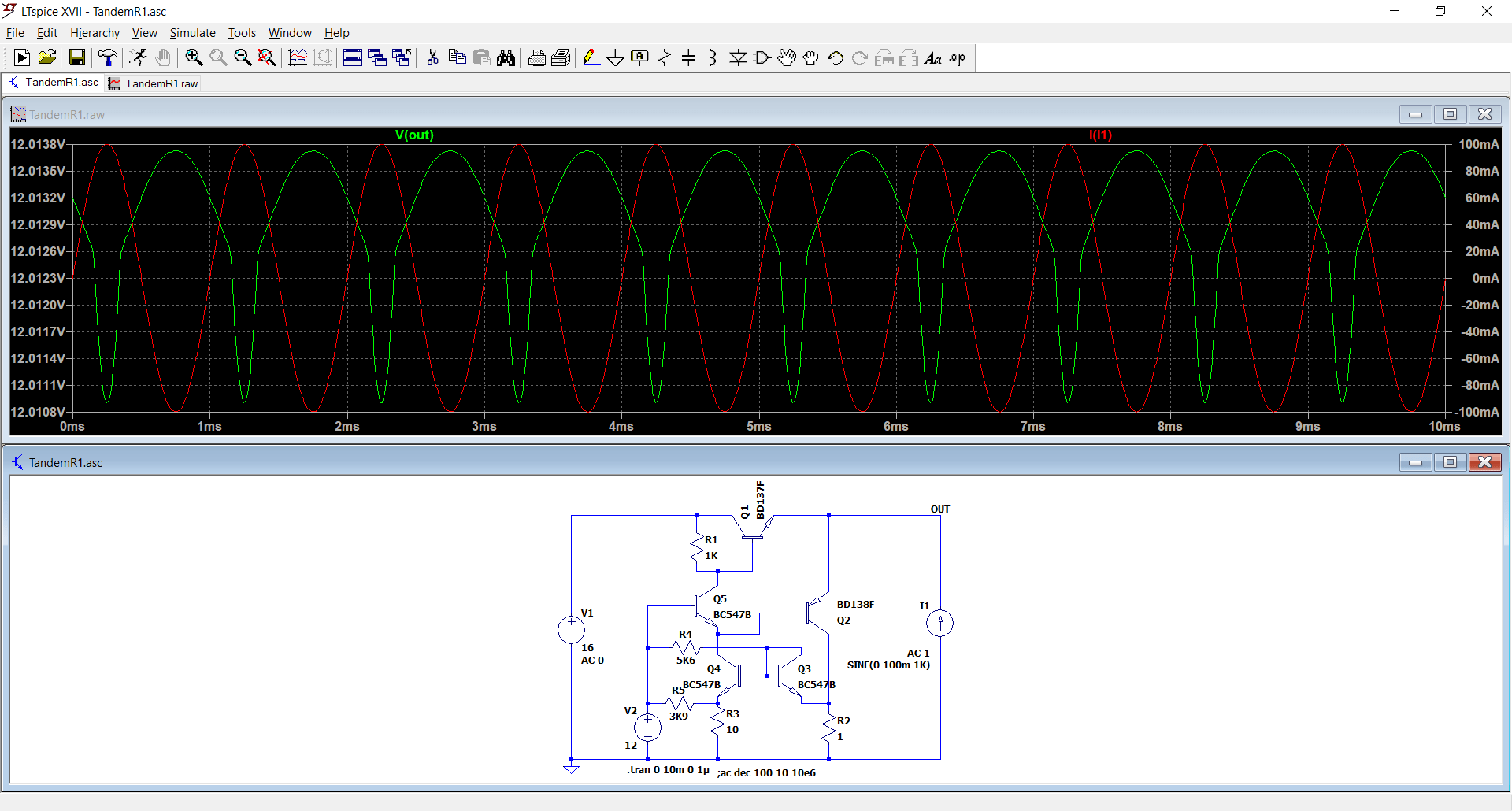

It does work, of course, but it is possible to do better:
This one has more amplification, and includes compensation resistors (since the compensation is optimal, the output residue has twice the frequency of the stimulus current).

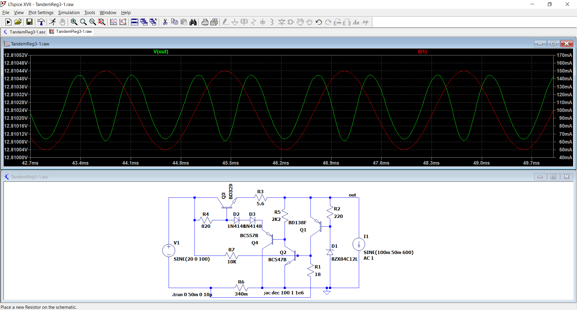

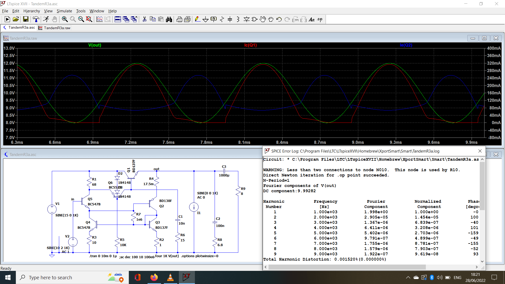

Let's go a step further, and include an active compensation:
The sim illustrates clearly the two-quadrant capability. Here, the reference voltage is provided by V2, and this voltage is reproduced exactly at the output.
The circuit uses a mix of negative and positive feedback to arrive at excellent performances (the output impedance is well under 1 milliohm).
The high input impedance seen from the reference input, the extreme fidelity of the output to the input and the deterministically controlled quiescent (shunt) current combined with the two quadrant capability opens intriguing possibilities: the circuit can also operate as a high-performance, power buffer, or a near-ideal output stage.

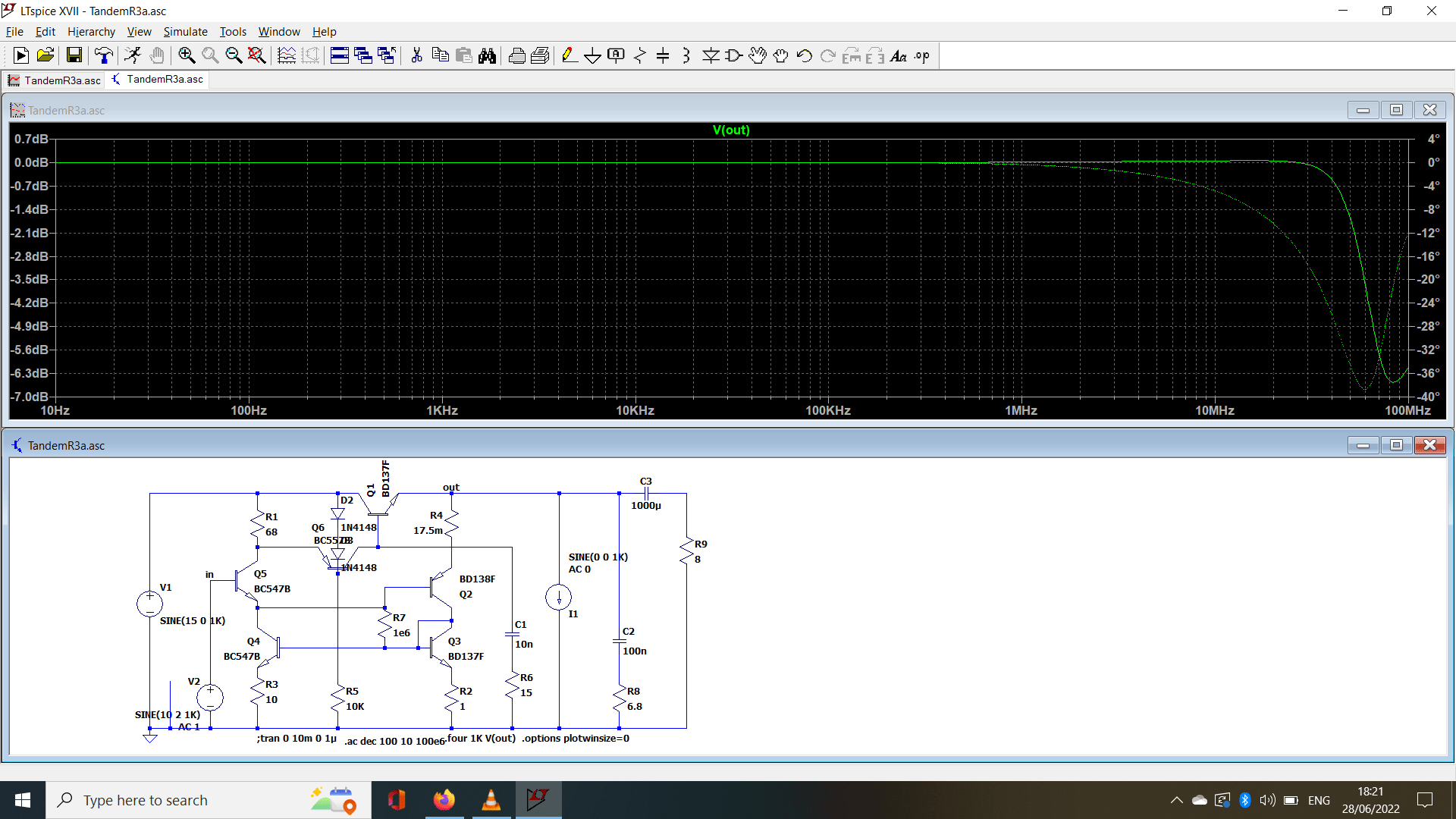

This sim shows the circuit in this role, with only minimal adaptations. The level is kept to a reasonable 4V pp, because it is a medium power supply, not suited to a full amplitude swing into 4 ohm:
The simulated THD is ~15ppm, in reality it would probably be 2 or 3 times higher, but it would remain excellent for a naked OP stage. The circuit is half non-switching: one half (the shunt part) always conducts.
The small-signal BW is nice too, meaning the integration of this stage in a GNFB loop would pose no problem:
It easily reaches 30MHz, using only common, GP transistors.
This is all very nice, but that's theory and sim. What about the reality?
I made some tests, and the reality agrees with the sims -up to a point-: as soon as you draw current, there is a differential heating of the transistors, and this degrades the ideal static compensations.
The effect is not caused by Vbe changes, because the circuit is mostly immune to them, but by kT/q and parasitic resistances variations: metallizations, bonding wires, etc.
Thus, ppm performance is not realistic in the real world, but the performances remain outstanding.
The circuit is somewhat quirky: for the audio range, the input impedance is ~200K, but with a minus sign in front of it.... Somewhat disconcerting, but not really a problem: by paralleling a 180K, the impedance will become some megohms, and turn positive. At higher frequencies, a RC circuit is required to keep the impedance positive.
These are minor issues if you are aware of them.
This shows that this class of regulators are capable of unusual tricks, in addition to their superb performance as ordinary regulators.

Yes Sir, in this pic, you see that the load is a purely AC current source, swinging from +100mA to -100mA, with no static load or offset current in sight:
You see that the response is different for negative and positive excursions; this explains the fact that the THD is mainly composed of second/even harmonics.
It is certainly an aspect that could be improved/equalized in case it matters, but I didn't focus on such things: this is just a high-level introduction to the various concepts, not complete projects.
If you want to use the concepts, you need to make your own homework and personalize them according to your needs. That said, if you look at the vertical scale on the left, you can see that in absolute terms, the difference is not that huge

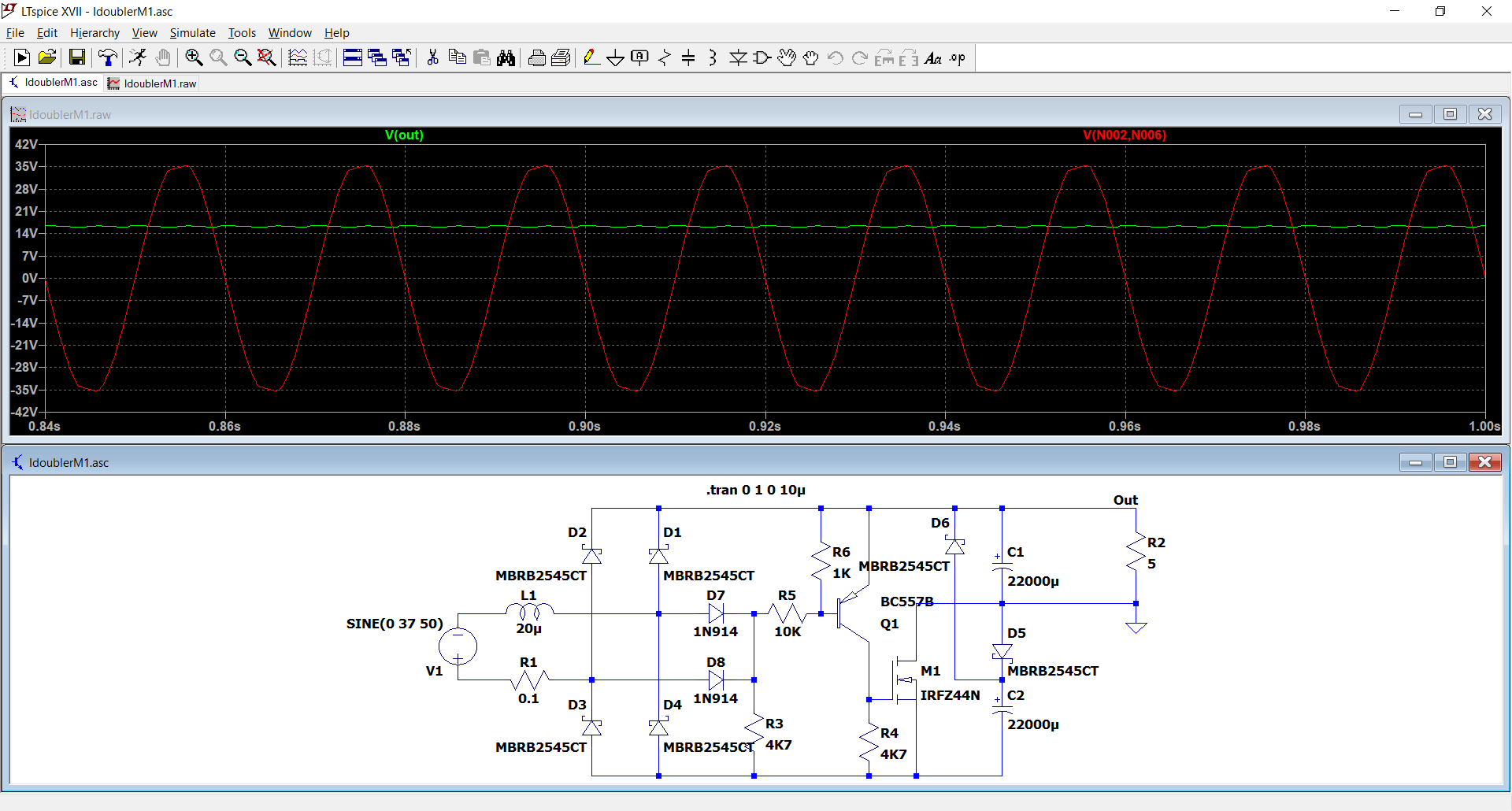

Full-wave current doubler
Here is another little circuit that tube-lovers might find useful: it is a FW current doubler (and thus voltage halver), but with an interesting feature.
Usually, current doublers use the positive half-cycle to charge two capacitors in series, and the negative one to connect them in parallel, meaning they are half-wave. Another similar circuit is required, together with an inverting circuit to be able to use the whole cycle actively.
This doubler works as a half-wave doubler, with a single controlled switch (a MOSFET), but it operates on an already rectified full-wave input: the charging phase takes place during the peaks of the waveform, and the parallel discharge during the troughs, thanks to a peculiar control of the MOS.
As an added benefit, the final ripple frequency is 4*Fmains, thus 200Hz with a 50Hz mains, which eases the filtering:
It has a number of potential applications, but one that comes to mind is as a DC heater supply, possibly with a transformer having the wrong voltage, or when there is a mix of 6V and 12V tubes: you simply need to add an isolation diode to the FW rectified output, to isolate it from the 12V filtering capacitor.
The same principle could be used to create half-voltage rails, in an amplifier for example: the +/-50V would go to the power amplifier, and the +/-25V would be used for the lower power circuits, without requiring an additional transformer or winding, or wasting too much power in a regulator.

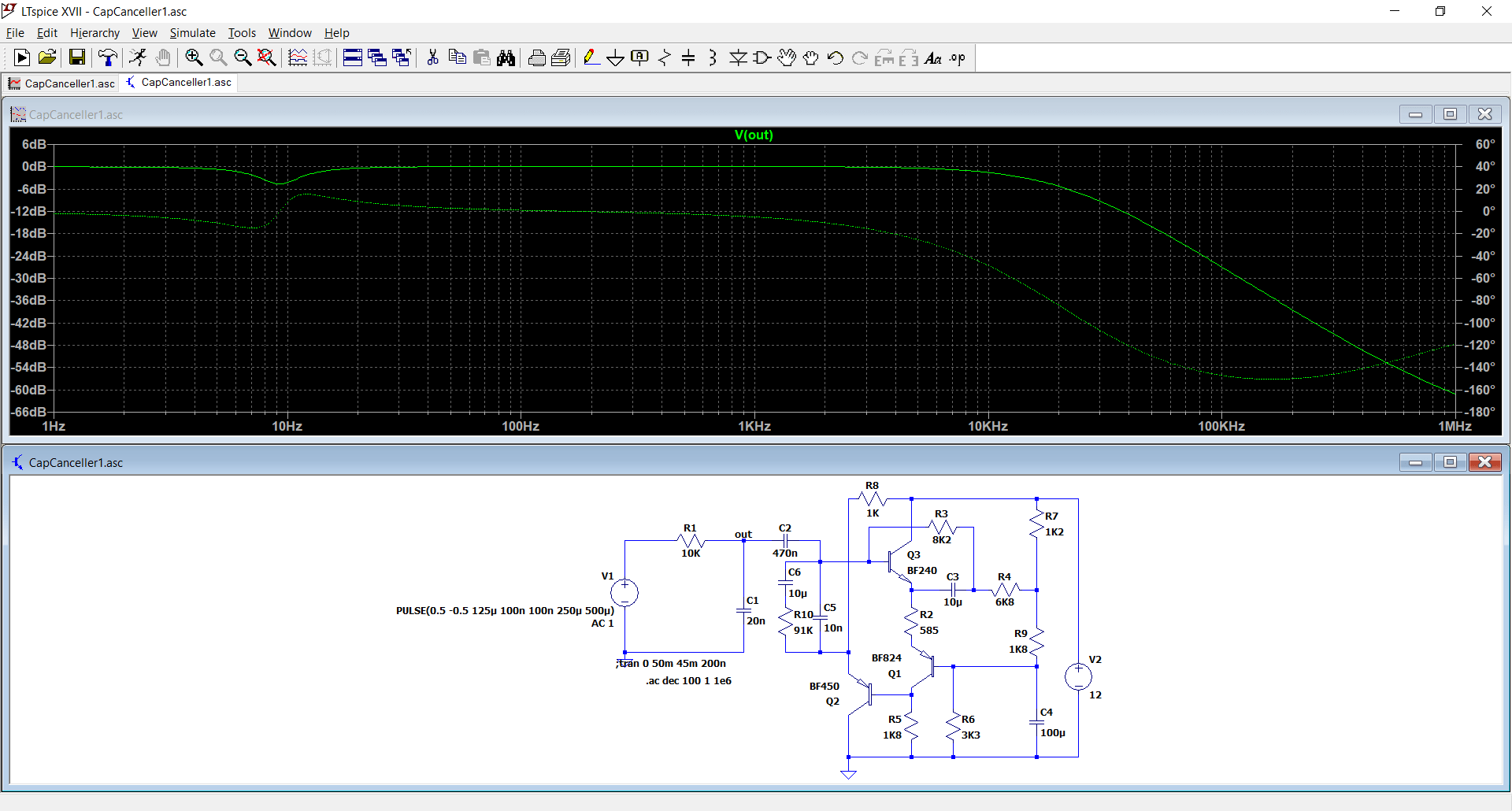

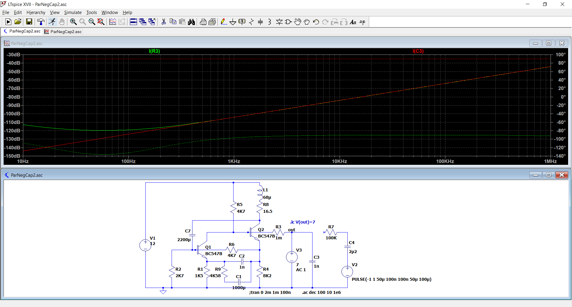

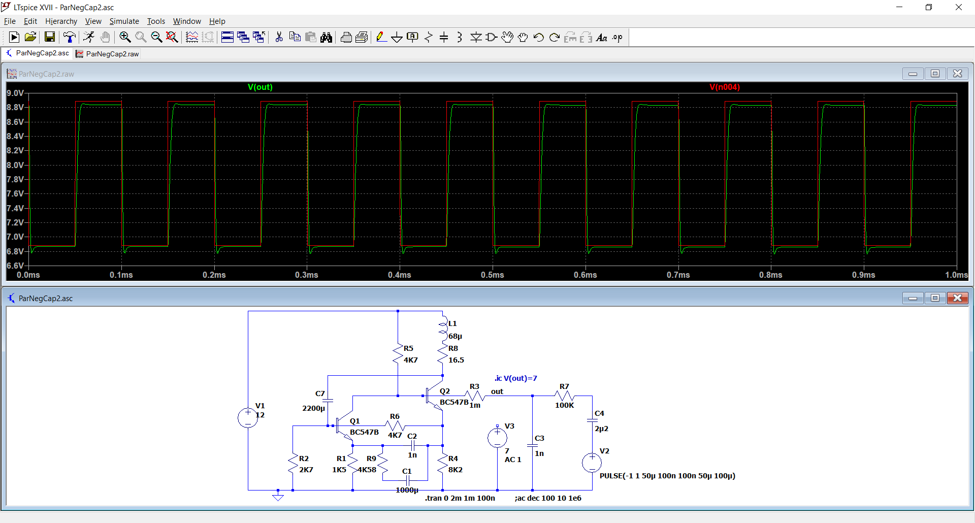

Here are two examples of // negative capacitors:
This circuit inverts C2, and the -1nF is connected in // with C3, cancelling it: this can be verified with the time-domain response. The 100K in series with the 10kHz squarewave source has a minimal effect.
In the frequency domain, the magnitude of the current through C3 and -C2 is similar, but the phases are 180° apart:
Various components, L1, R8, R9 compensate for the parasitics of the transistors and the bias and load resistors required to make the transistors function normally. Their value needs to be accurate if the positive capacitor has to be 100% cancelled.
Another variant, first in the time-domain:
Then in the frequency domain:
Again, R10 is a compensating component, but something should also be added for higher frequencies; anyway, these are just examples, and the LF blip is caused by too small coupling caps.

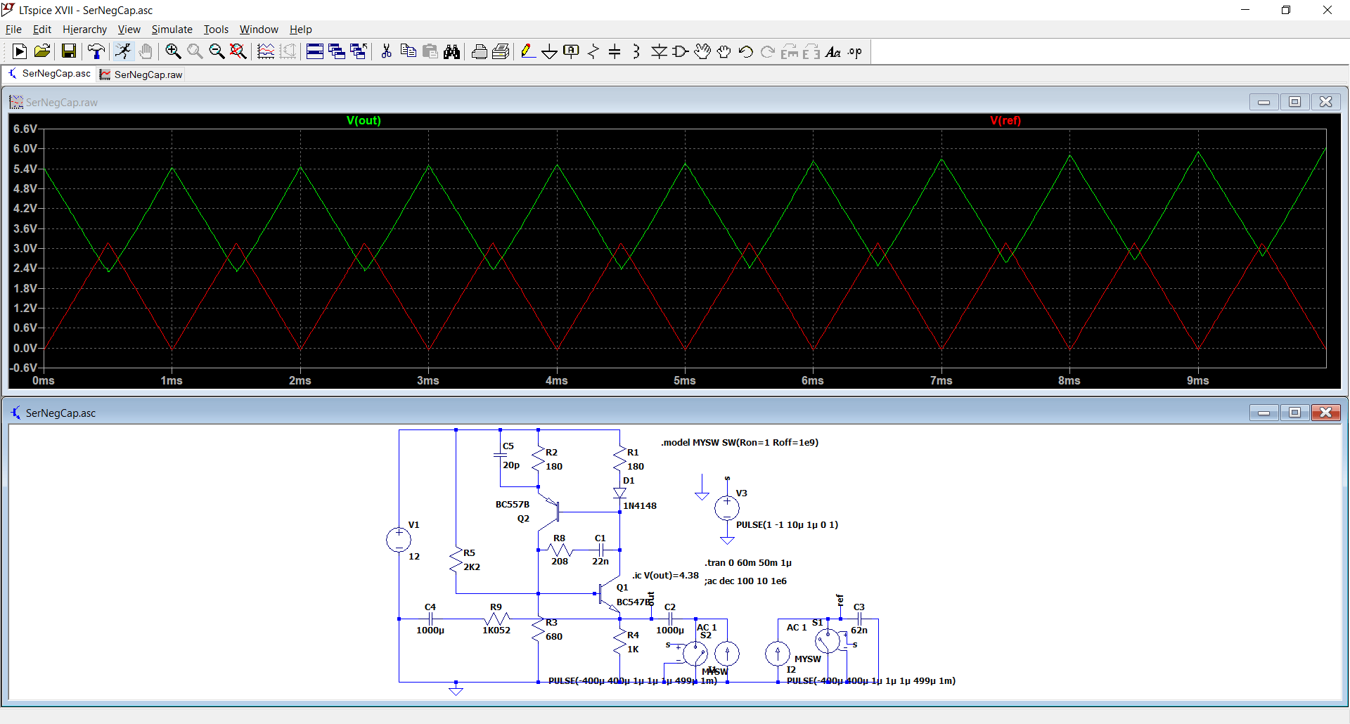

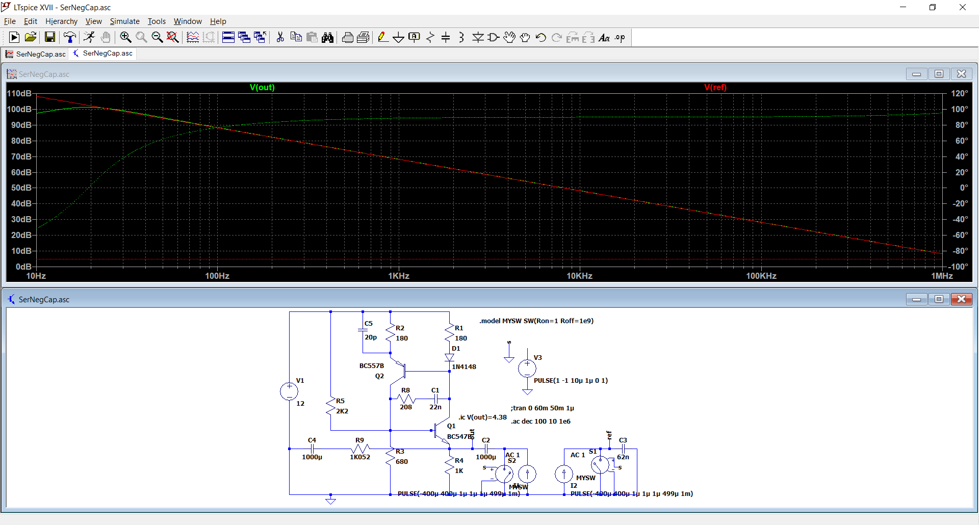

Now, the series version, in the time-domain:
The simulated capacitor behaves exactly like its positive counterpart, the 62nF capacitor but with the phase reversed.
The same in the frequency-domain:
Again, same behaviour but the phases are 180° apart.
