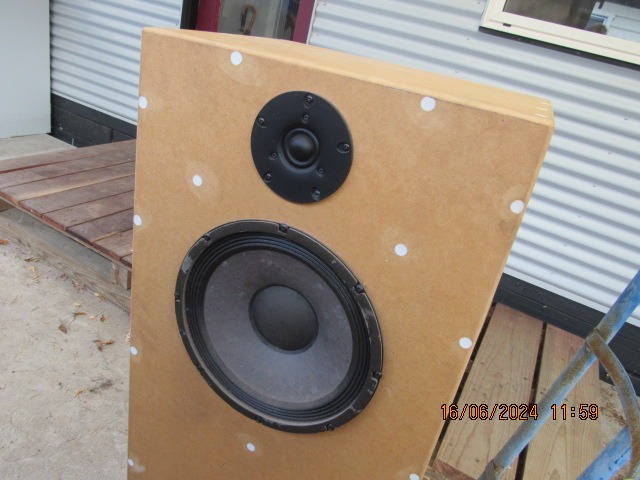

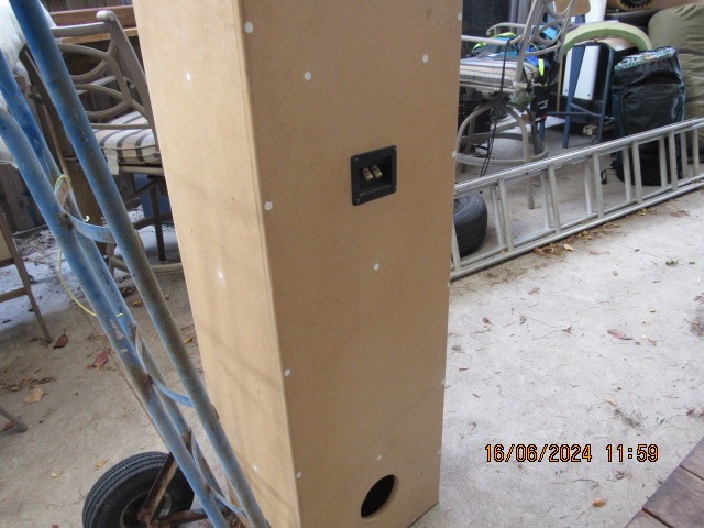

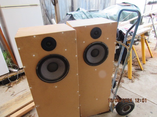

Using a garage sale box and some bits from the shed to make a new set of party speakers.
Going though my spare parts and trying to figure out a crossover to go with the hodgepodge of drivers I'll be using I couldn't make a decision.
Went on eBay this AM and found some Jaycar 3-Way crossovers from about 20 years ago [ 2004 catalogue says $57- each 200 watts and frequency divides to suit the old Tandy 2" dome at 1500 and 5k-.
It's a junk box why not use a junk XO? So I bought 2.
Near enough good enough?
I will need to put a zobel on the woofer but that's from stuff in the junk box and I finally get to re-use the old Tandy dome

Woofer really needs a conjugate, doing party duty how long will it take to cook a 5W ceramic? Jaycar Geelong burnt down and I'm out of resistors in suitable value apart from two 5W and no large values in the stash to dubble up.

Although you didn't actually spell it out, the Tandy 2" dome driver is a midrange.
The only problem with using these for a 'Party Speaker' is their slightly low efficiency - being roughly 89dB/1W/1M.
However, Tandy drivers always had a rather poor tolerance spec. around 15%, so there is a chance you've got some 'loud' ones.
Your project still sounds like FUN to me.
Approximately 8R I have 8.2R in 5W and enough five watt resistors to knock up a series/parallel to give the correct value. Jaycar were a 5 minute drive away and the new Geelong store may not open for months yet. I wonder how much stock went up in the fire and how much was able to be salvaged.What value resistors do you need?
Geoff
MA it won't help that the two mid domes are different to each other either, but for a party speaker it may not make any difference,
This project is being driven by my neighbors. At dinner the other nite out on the new patio area besides the firepit I was asked why I didn't have music playing. As you may all know my "Party System" is a bit too big for gentle background music and I have all these spare drivers and bits of old boxes there.
@ MisterAudio, yep not really efficient but there should be a couple of dB boost from the second order XO at 1500, I'll make up for it with treble boost if I can
