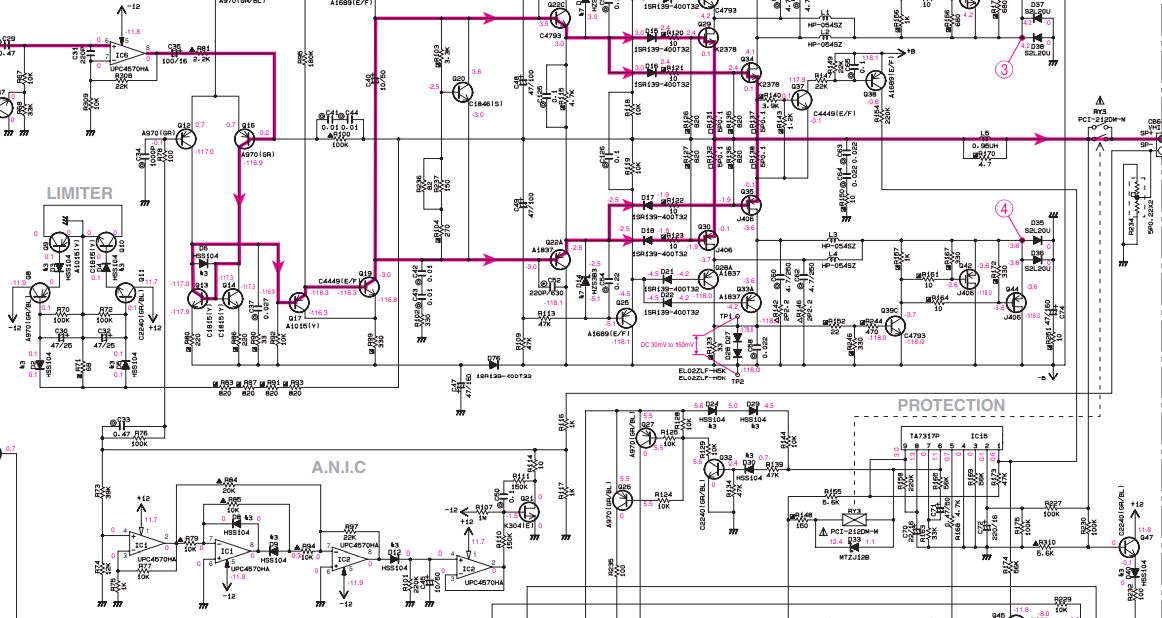

I need help understanding schematic of Yamaha subwoofer
I am not used to this type of layout, why are there 2pairs of mosfets on each rail that is connected in series with inductors?
First pair triggering the second or what?
I feel stupid!
Rail voltage +/- 118v
Yamaha yst sw1500 triggers protection

It looks likethe total rail voltage is +/- 180 volts, but the MOSFETs are only rated at 200V. So the inner ones (Q28,Q34) are doing the almplification. The outer ones (Q41, Q43)are reducing the supply voltage across the others so they stay within there voltage ratings. They do this by tracking nominally 4.2V voltage above the output.
Note that as the output swings below -5V the inner ones (Q29,Q34) are supplied via the Diodes D37, D38, so the Drain is clamped to Gnd, this also stops the voltage across Q41,Q43 exceeding there 200V limit.
strange with C48,C49
Maybe something to do with the A.N.I.C and the motion control of woofer
I could be mistaken but C48/C49 look to me like a pair of bootstrap caps to keep maintain constant voltage between the R108/R112 and R109/R113 junctions and between those junctions and the output. This maintains the proper operating points for Q24 and Q25, which then control and maintain the proper operating point for the output stage cascode transistors (Q28, Q33), which then maintain a constant and low VDS across the output FETs.
Yes. It's important to realize that the upper FETs Oscillate/ switch....

...but operate in "non-synchronous" mode...
Thanks, not sure I understand exactly what you mean by this but I stared at the circuit (for quite a while) and eventually worked it out.
Pretty clever - simple but effective.
It seems the oscillation frequency would be determined by the rise and fall times of the transistors, parasitics and other somewhat ill-defined characteristics.

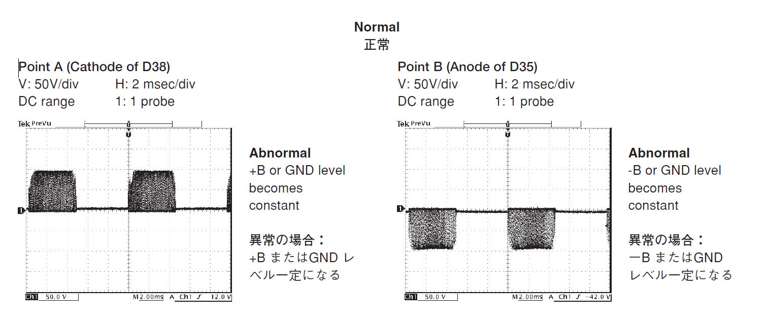

The drop across TP1-TP2 is involved and has to be adjusted to within 30 mV to 150 mV - but I can't see how this is done, where's the trimmer?

...It seems the oscillation frequency would be determined by the rise and fall times of the transistors, parasitics and other somewhat ill-defined characteristics...
OK, a closer look shows oscillation frequency mostly set by the resonance of the inductors with capacitors C59-61.
Still need a little extra phase shift to make it 180 phase reversal, so the second order parasitics and such are involved but not too much.
Still can't find the damned trimmer.
David
The oscillating frequency is pulled down by C57, C58.
If there is a trimmer, it's R236, R237.
A "synchronous" buck converter uses a transistor on the lower side of the totem pole that switches out of phase with the upper transistor, vs a non-synchronous buck converter that just allows the inductor to pull current from diodes to ~ground when the (upper) switch is off.

There are 2 different patents in this circuit, one is the old carlsson/acepro/yst negative impedans speaker approach and the other is as already mentioned in thread.
I now understand the schematic/design and i feel educated.
That's what I expected too, but they are shown on the schematic as fixed, shown on the PCB illustration as simple resistors and in the parts list also.
The manual says to adjust "VR1" but it doesn't seem to exist- typo or bad cut-and-paste from a earlier version maybe?

Here you have a US patent on this circuit:...

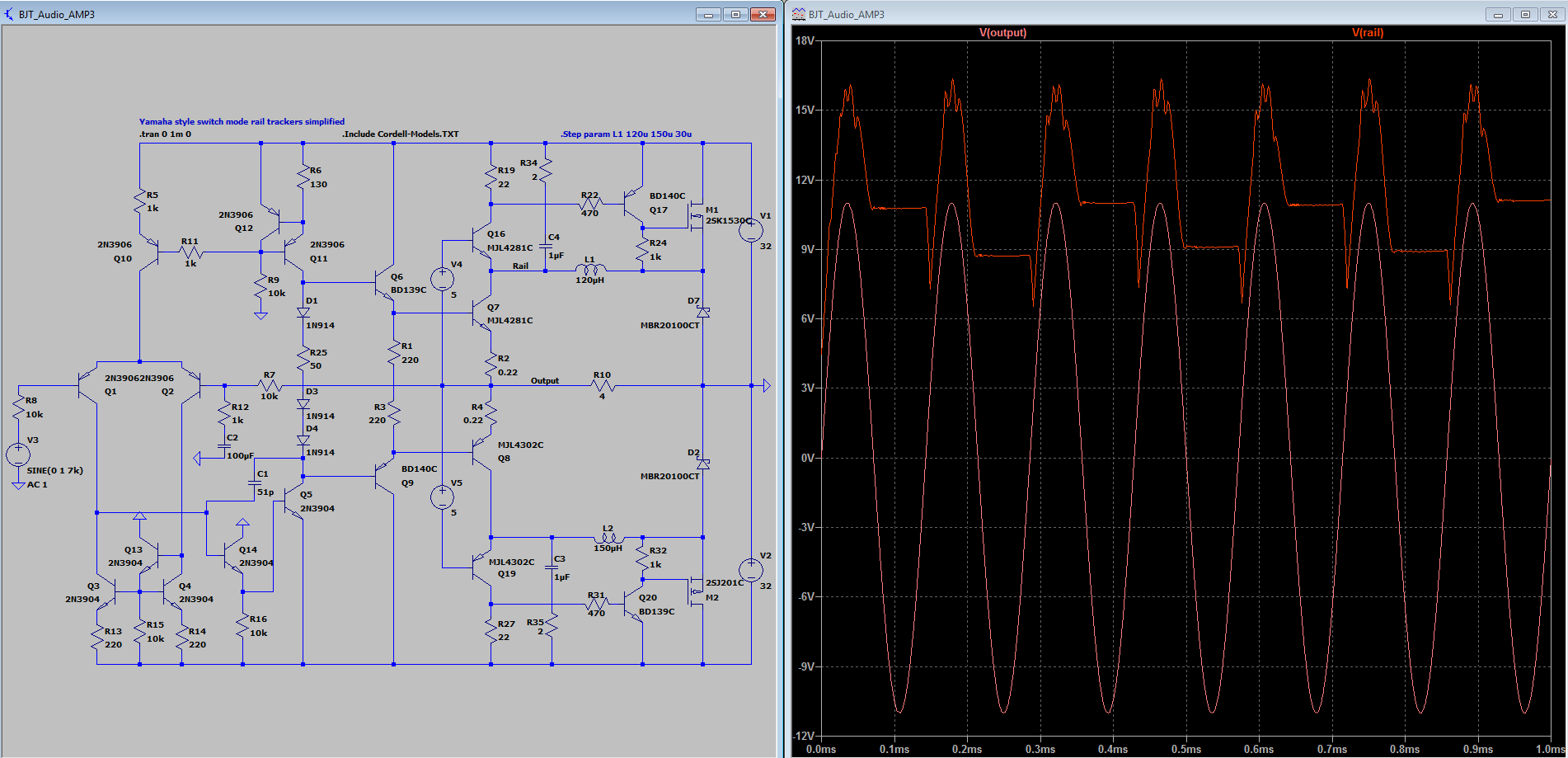

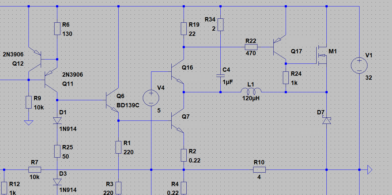

Dave Zan said:
Is it your own circuit?
No, I just add the "Yamaha circuit" into the existing (random) amplifier schematics I have found in LTspice.
I've added Q15, Q16, Q17, M1, and D7. And I lowered the output stage quiescent current so that Q17 is OFF at the idle.
And we can simplify the circuit

So, here's the first observations-
The two circuits seem to have poorly defined hysteresis, I commented about the Yamaha YST 1500 circuit that the frequency looked poorly defined then back tracked a bit because I expected the inductor/capacitor resonance would constrain it fairly well.
But I now think I didn't properly understand the inductor/capacitor interaction.
This issue of phase shift from the inductor/capacitor filter and it's relation to hysteresis is not simple.
Bruno Putzeys mentions it in the Ncore whitepapers but mainly to say that no one else has it worked out as well as he has.
So I need to reread the Class D literature to see what is applicable here, because the circuits are essentially similar.

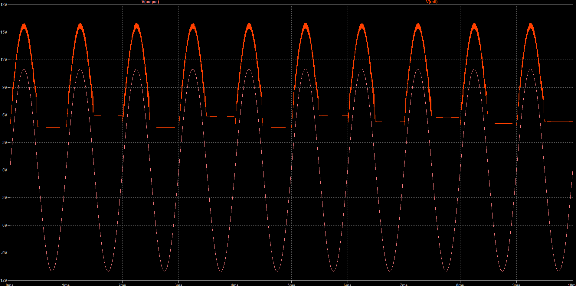

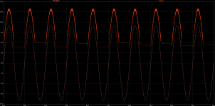

Here's a plot of the outputs of your simplified circuit.
At 1 kHz it's noticeable the way the Rail potential baseline jumps around.
Class-D can have some kind of similar problems IIRC.
At 7 kHz the rail does not track well at all.
(I know the OP was about a subwoofer amp but I want a full audio frequency power amp)
By 20 kHz it's completely unusable.

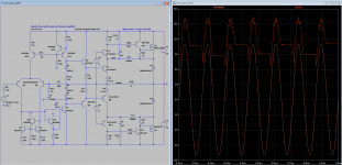

I assume the 220 uH value of the -ve side inductor was to help it solve the initial conditions.
(Curious that if the values of both side are identical then LTspice has trouble.)
I altered the inductor on the -ve side from 220 uH to 150 uH to make it more similar to the +ve one.
Yes for sure.

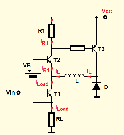

attachment.php
But if for simplicity we will treat the inductor as a current source.
We can see the at the beginning when I_L = 0A all the load current is flowing from Vcc through R1 and T2 thus, we turn on the T3 and the inductor current will start to flow and rise at a rate equal to VL/L = A/s (ampere per second).
But as the inductor current increases the R1 resistor should decrease with a similar rate because I_load = I_R1 + I_L.
If this is the case, at some value of a load current the R1 current will be too low to sustain a voltage drop needed for T3 to stay open.
If T3 tuns-OFF the inductor will start a "discharge" phase. And the inductor current will start decreases process at the rate of (V_Out + VB )/L.
Decreasing I_L current will increase the I_R1 current. And if this current is high enough the T3 will open once more and the cycle will repeat itself.
What do you think about this? Of course, some "internal" delay is needed I suppose as in every self-oscillating D class amplifier.
Also, the frequency of oscillations of a self-oscillating D class amplifier is also not well defined but we have to live with it.
