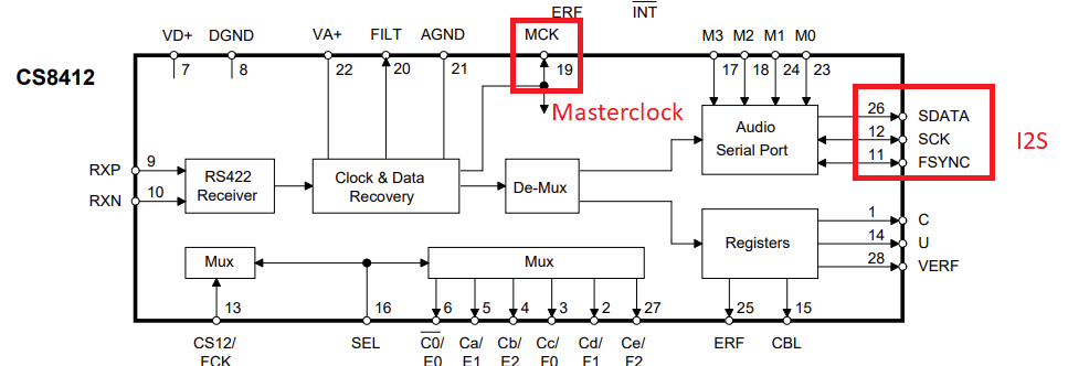

CS8412 is not I2S. Try trace back the connections from the cable pins to the chip. Is there any input ransformer? It could be SPDIF interface.
the cs8412's job is to convert the s/pdif inputs to I2S for the df1700, which then converts the I2S to an output that the pcm63 can read.
by connecting the I2S input I will be able to bypass the input receiver (cs8412), and will be connected directly into the digital filter (df1700). which is why I want to do so.

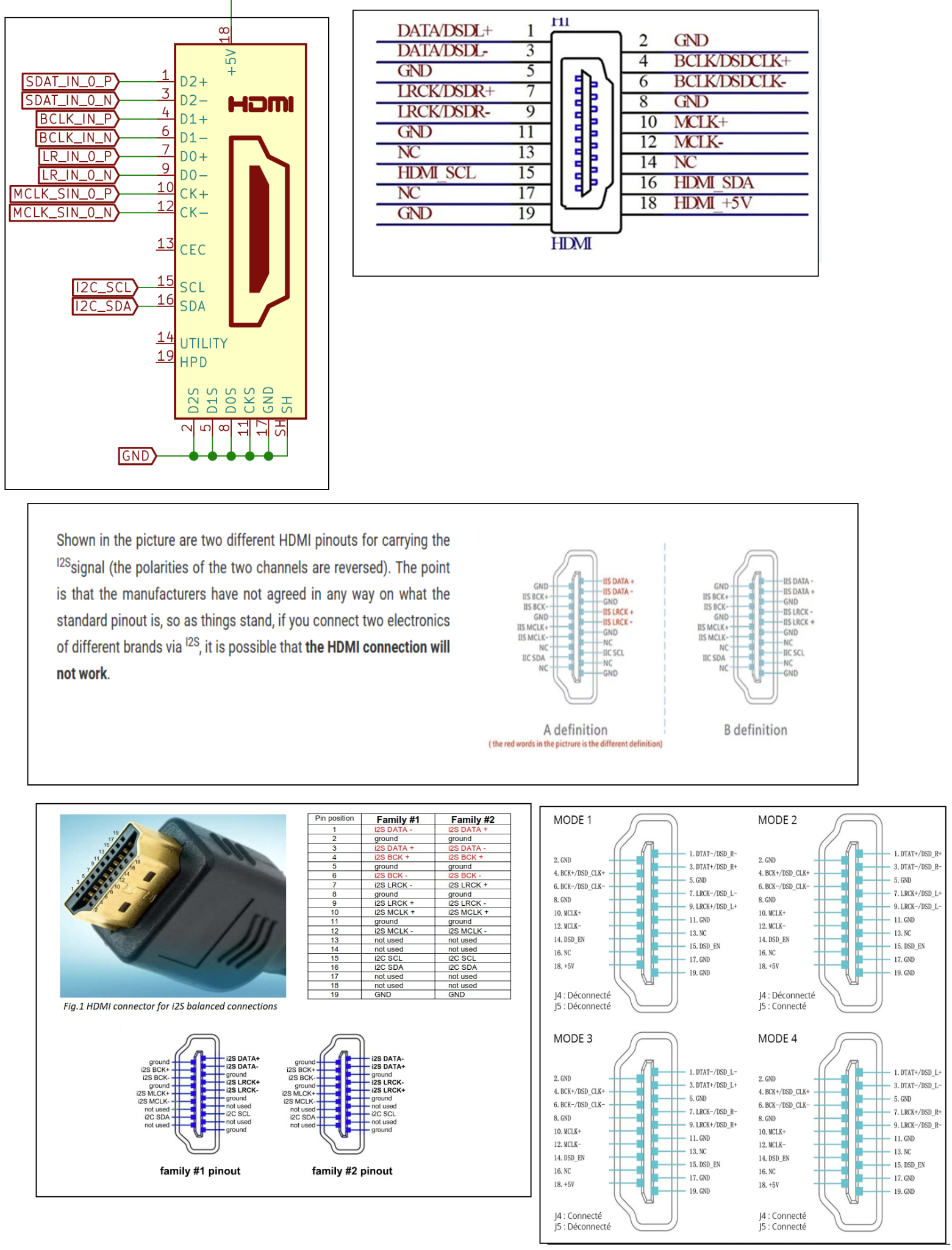

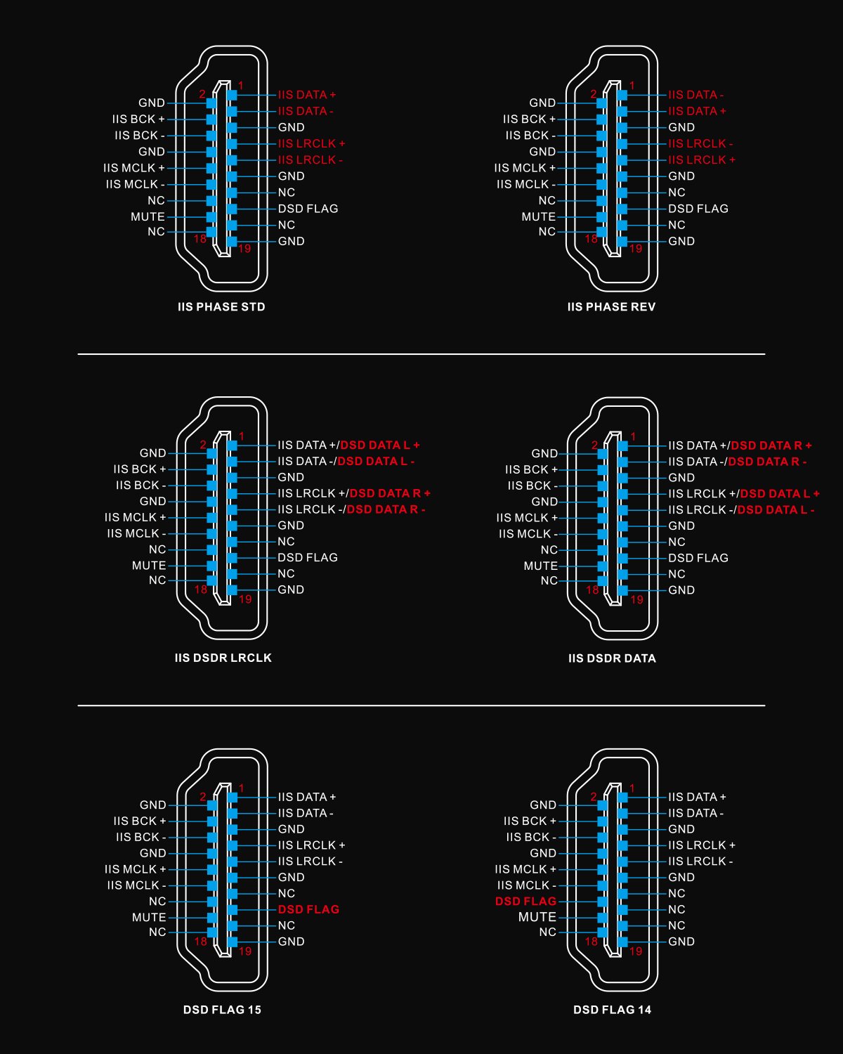

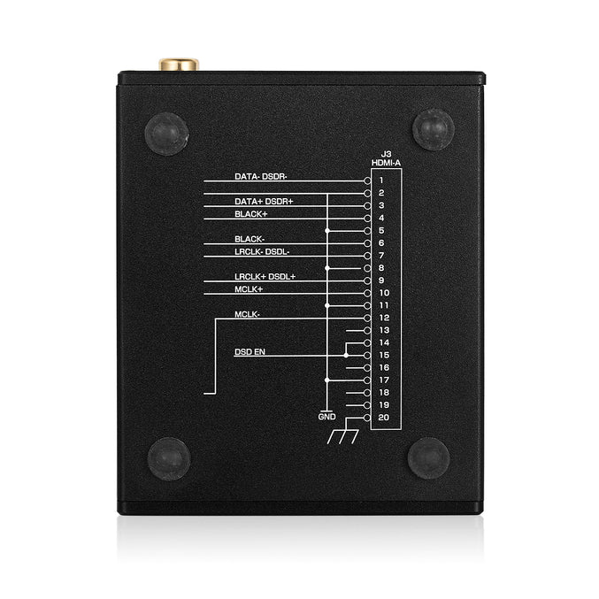

The use of the I2S HDMI connector is not standardized, so different companies may use different pinouts.
However, the main difference is the polarity of the signals.
Here are some examples:
that much I know, the muse model two uses a 13w3 connection and not hdmi. I just need to figure out the pin so I could make a hdmi->12w3 cable for my dac and whatever DDC I will choose.
my question is what are those +/- connections, the df1700 doesn't have those, does this mean I won't be able to connect modern DDC'S with such +/- to my dac?
+/- is most likely balanced LVDS. I guess you need a receiver that translates LVDS to TTL (3.3 V).

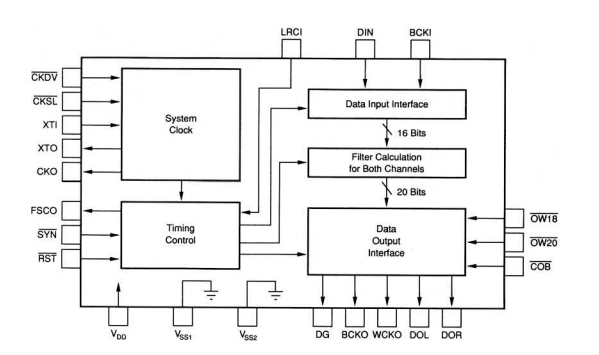

DF1700 required from I2S just 4 signals: WCLK (pin 28), BCLK (pin 2), Data (pin 1) and MCLK (pin 6).
But I2S must operate in RJ16, RJ18 or RJ20 mode, depend of how DF1700 is configured in your board.
These modes may not be available in the modern sources.

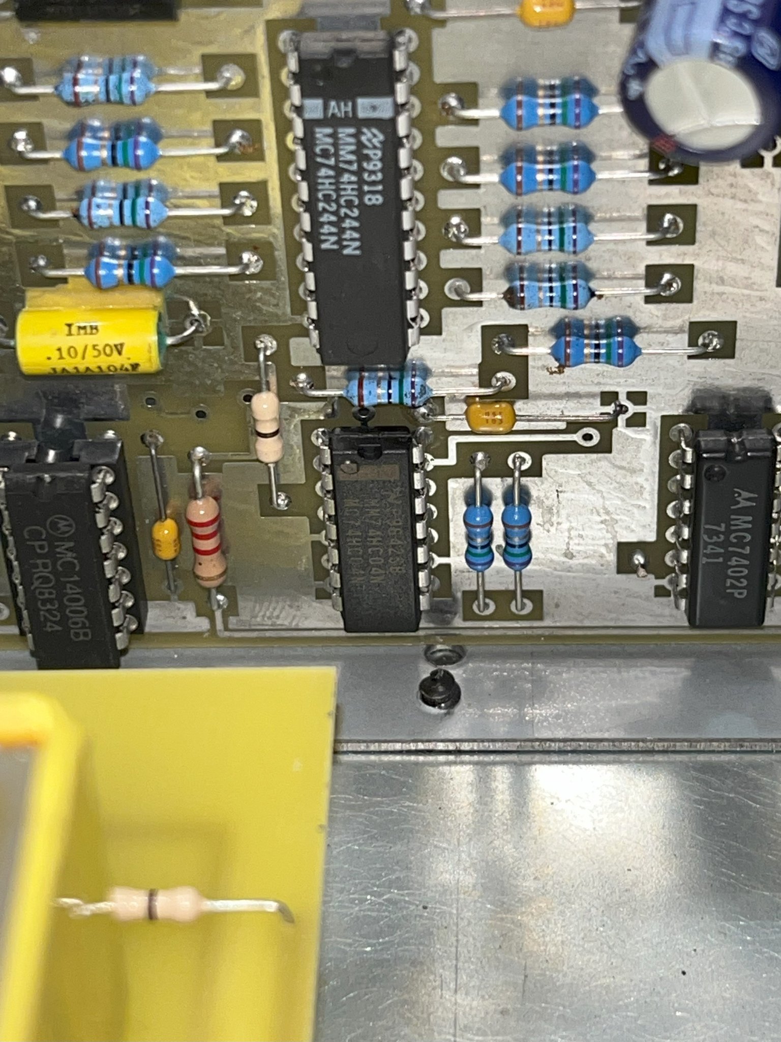

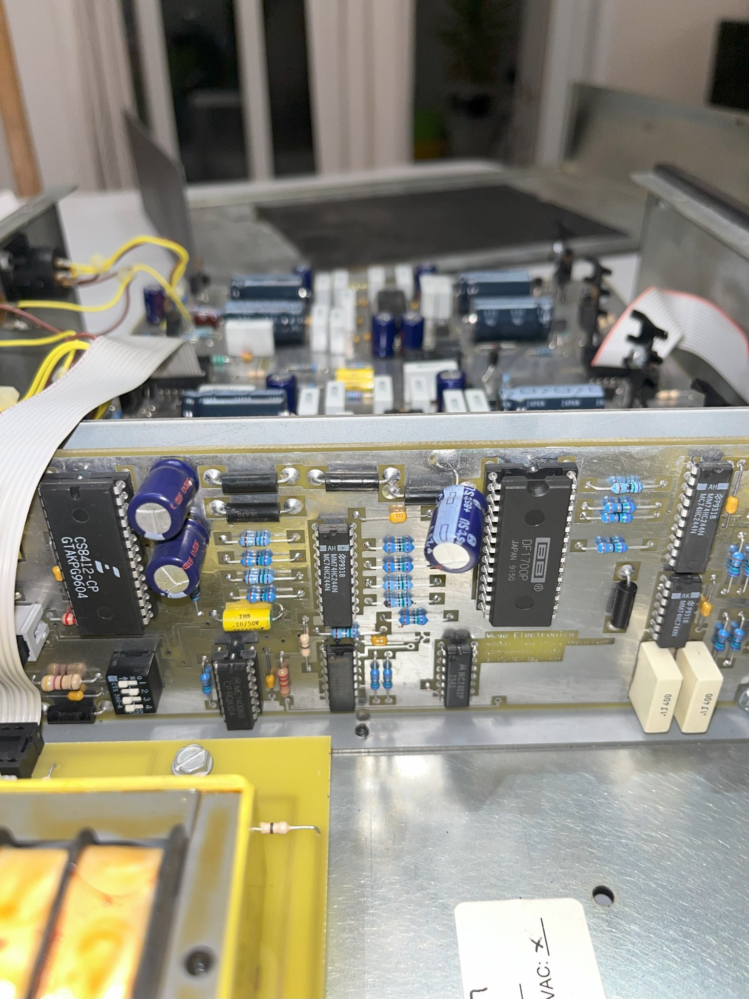

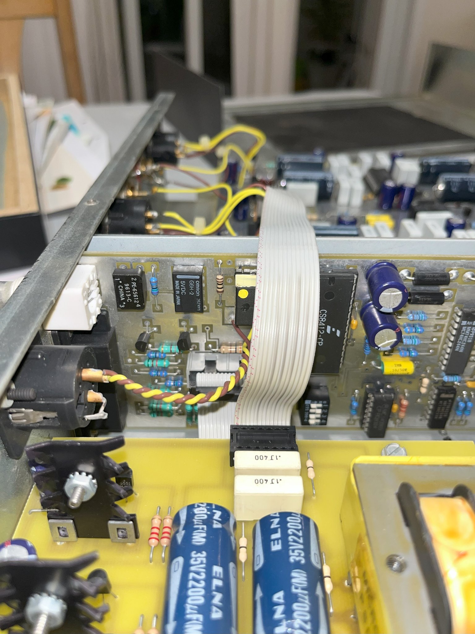

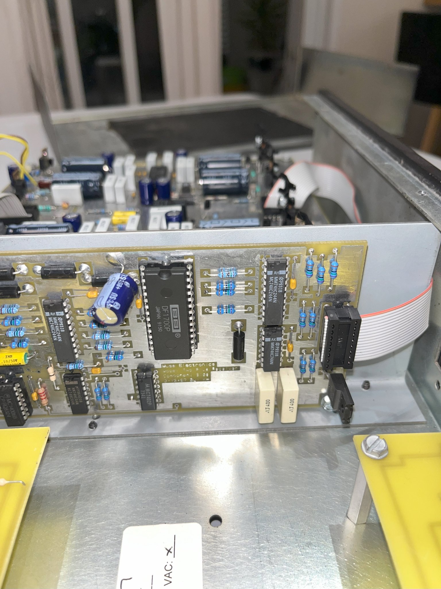

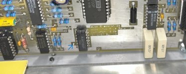

I can probably open up the dac and look inside, will some pictures of the digital board will help figuring it out?
13W3 was the original I2SE connector. A Google search using the terms 13W3 and I2SE should find it.
was there a I2S 13W3 standard back then? because if not the 13W3 I2S inputs could differ from brand to brand.
my question was more towards rfbrw, but is it possible to send you pictures of the digital board?
if you could tell me stuff about how the digital board works based on its look it will be very very helpful.
You can share the pictures here, maybe is will be possible to see something.
Alex.
