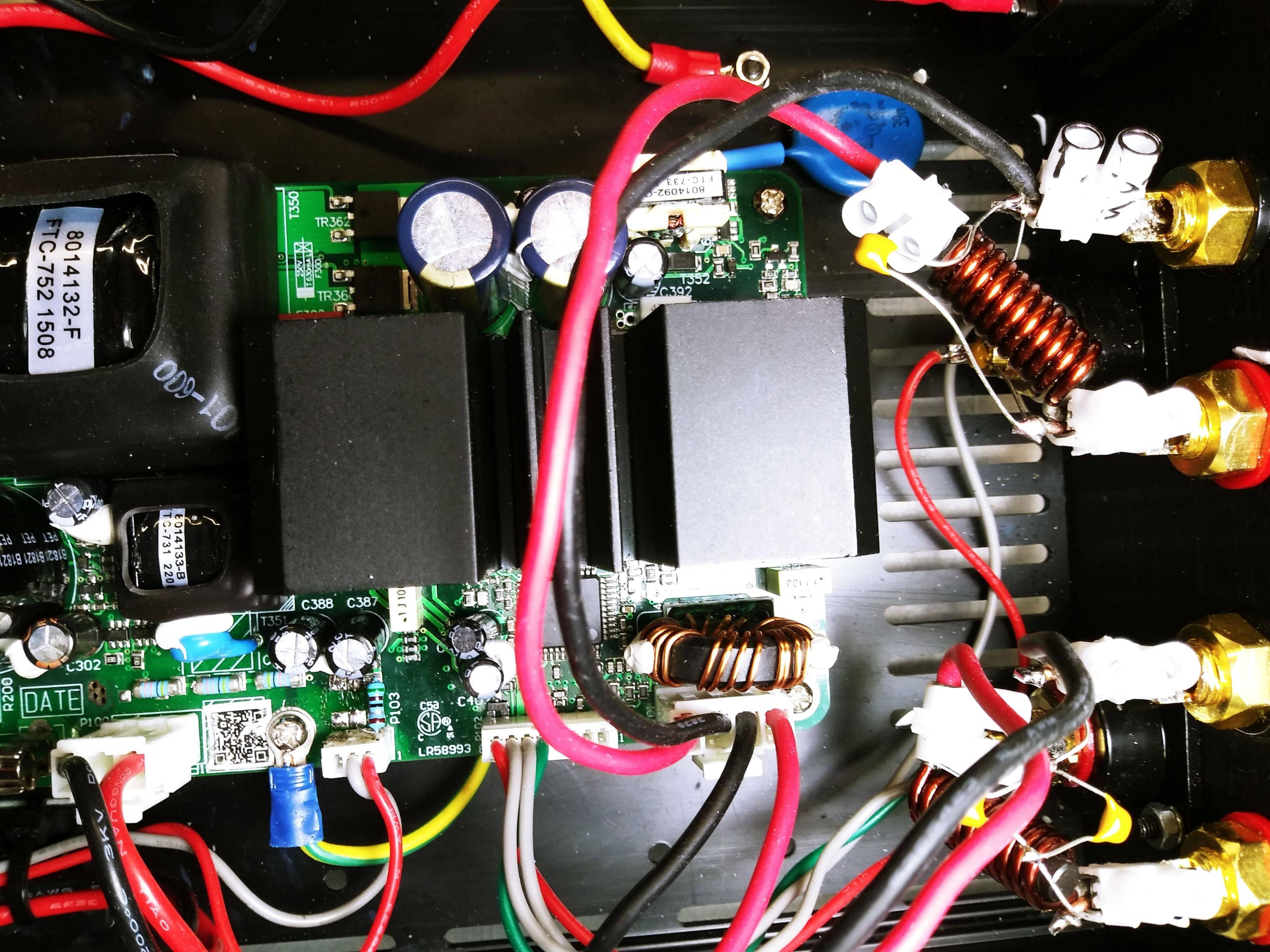

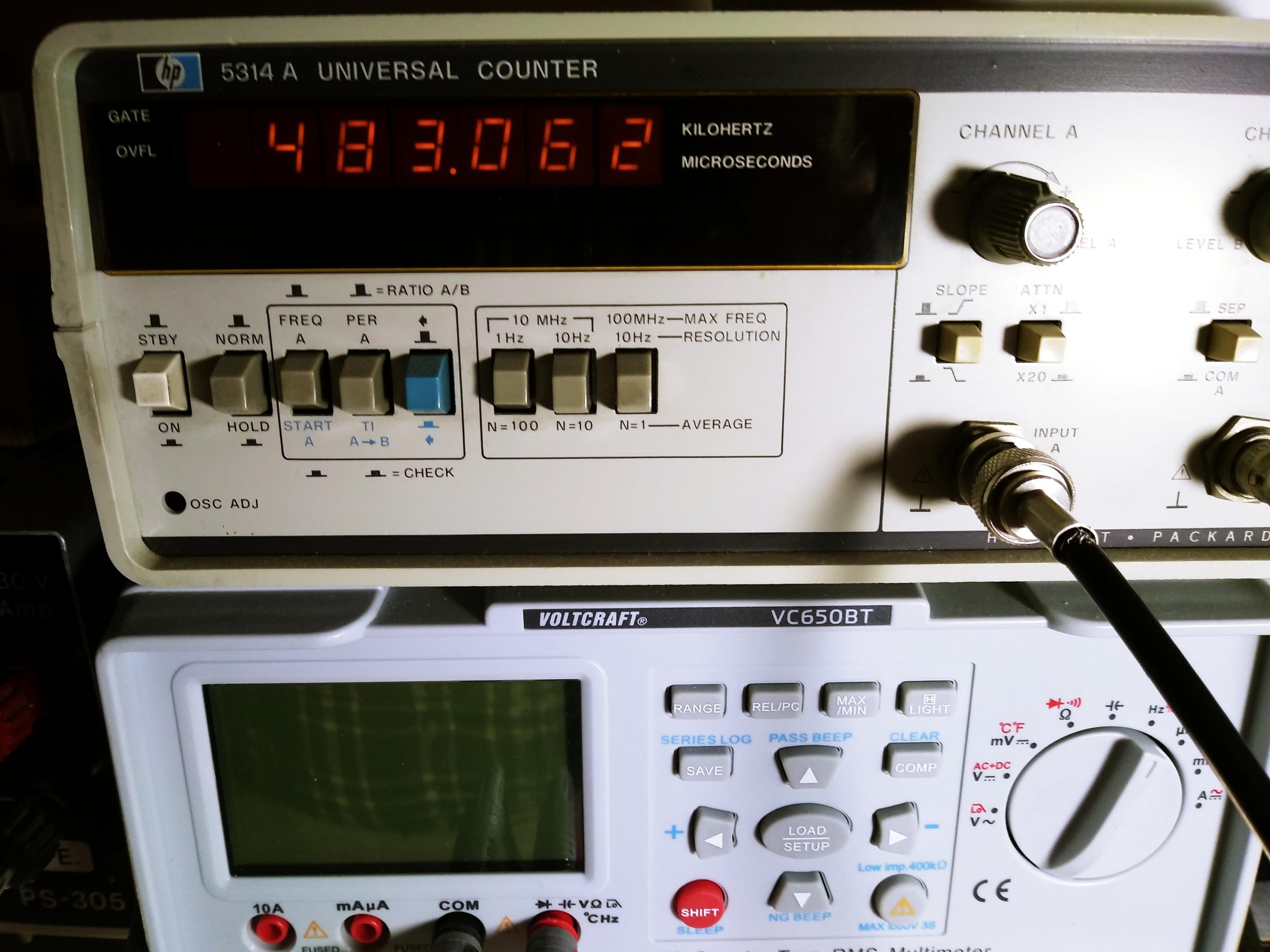

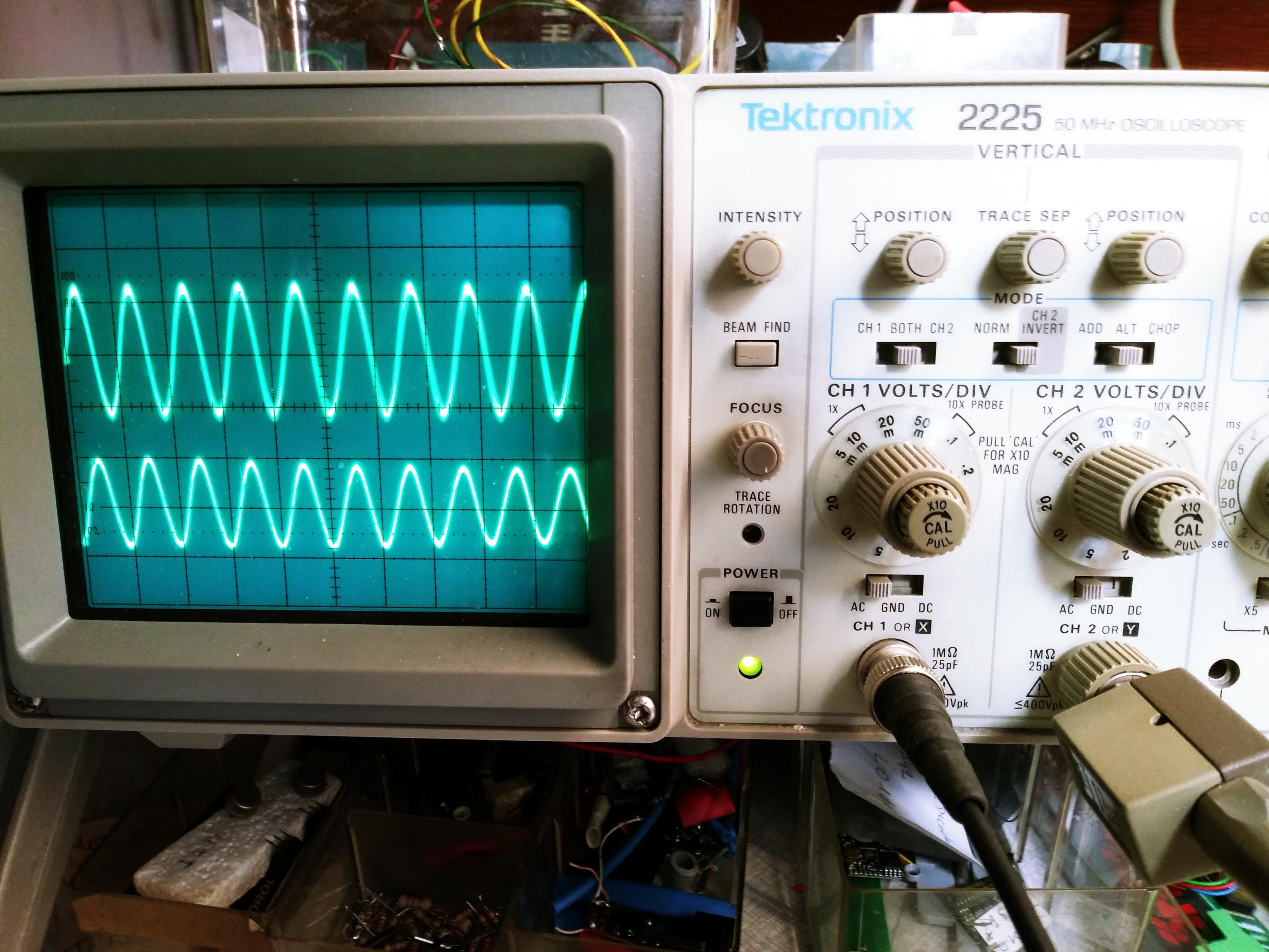

I use the ICEpower 125ASX2
2 V ptp output noise 485 Khz.

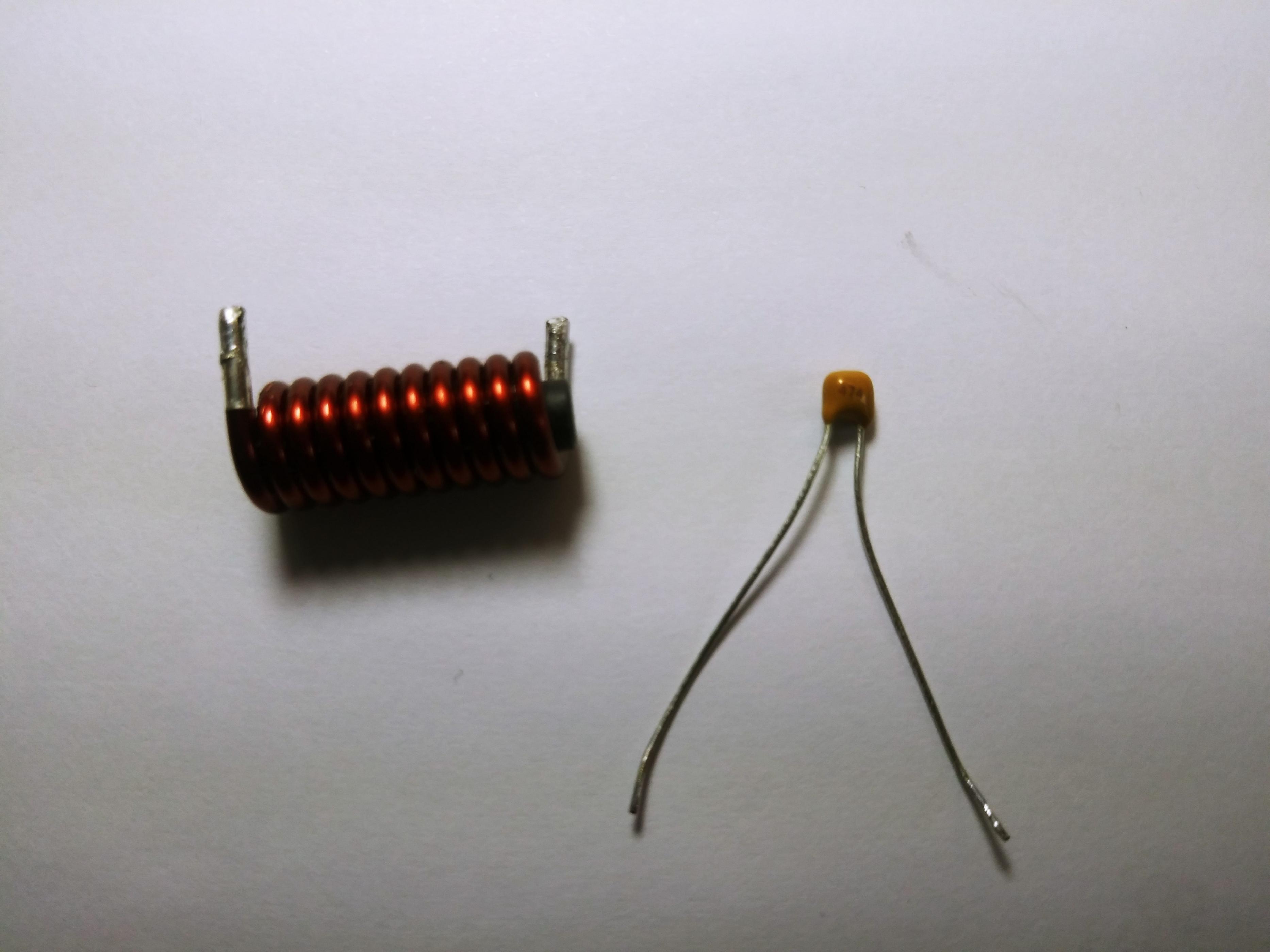

I put some LC filter at the output and now +/- 250 mv
cap 470 nF (conrad art nr 001578609) L ? recup from a broken powerline adapter.

Hello
here some pictures
via attachm
gr
guy
