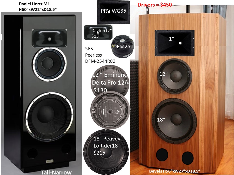

What percentage of your time do you listen to front 2-channel stereo audio(music + video) vs. a 5 or 7 channel surround sound movie? Have you discussed adjusting your budget to say 50% front stereo pair, and 50% for the 5-HT surround sound speakers?
With a $2000 total 7 speaker budget, would you get greater enjoyment with a $550/speaker front stereo design? No subwoofer required.

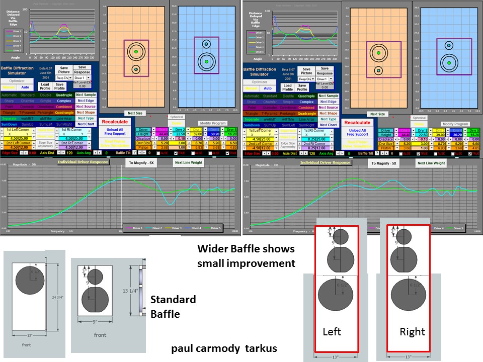

Sketch of 1-box Tarkus tower with tweeter and midrange baffle offset distances similar to original 2-box for good crossover match.
