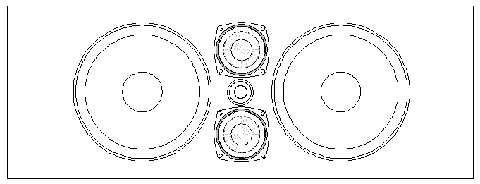

Sideways MTMs as centres do not work well unless the midWoofer to tweeter XO is (ideally) less than a quarter wavelength. In your case the XO from woofers to mids should be approx at a quarter. wavelength of the distance between the centres of the 2 woofers. At that point the woofers act/look like a single woofer.

Dave- My center will be a 3 way design with the tweeter over the 4 inch mid, in the middle, with the (2) 8" woofers on either side. I think the distance between them is close enough but I'm not sure on the calculation.
I understand. I did this illustration in 2007 to illustrate the proper way to do a sideways multiway centre channle (ignore the second mid).
Note that even this fails the quarer wave at the mid-tweeter XO (i’d be doing a WAW with a 3” replacing the mid+tweeter), but the woofer to mid is more critical in my estimation. I usually like to cross mids <250-300Hz, which represents a separation of 25-35cm.
dave
