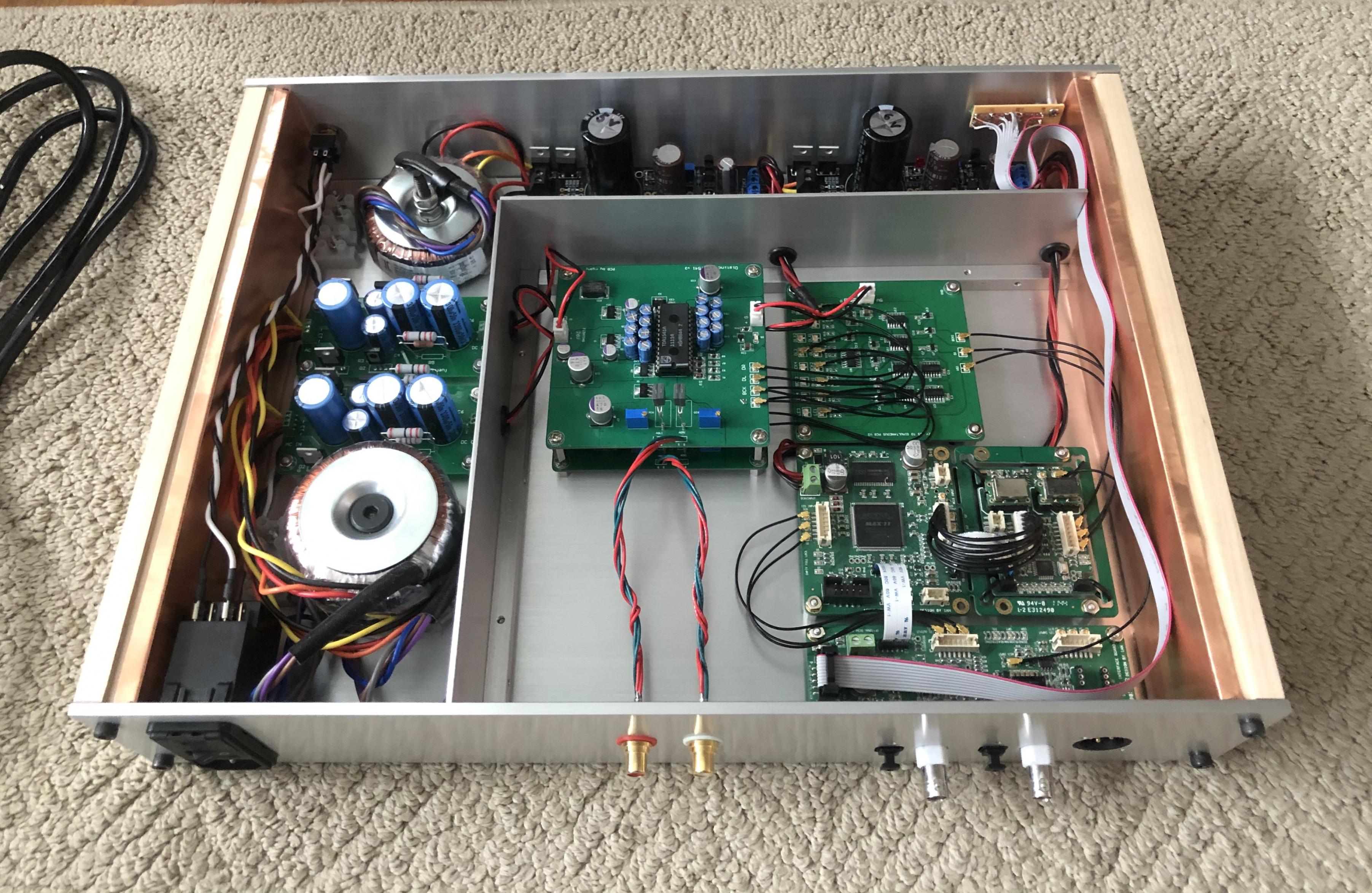

When I first started building projects I would go to local thrift stores and buy old equipment for a few dollars to reuse the cases.
Around me it was St. Vincent DePaul and Red, White and Blue thrift...as well as Goodwill.

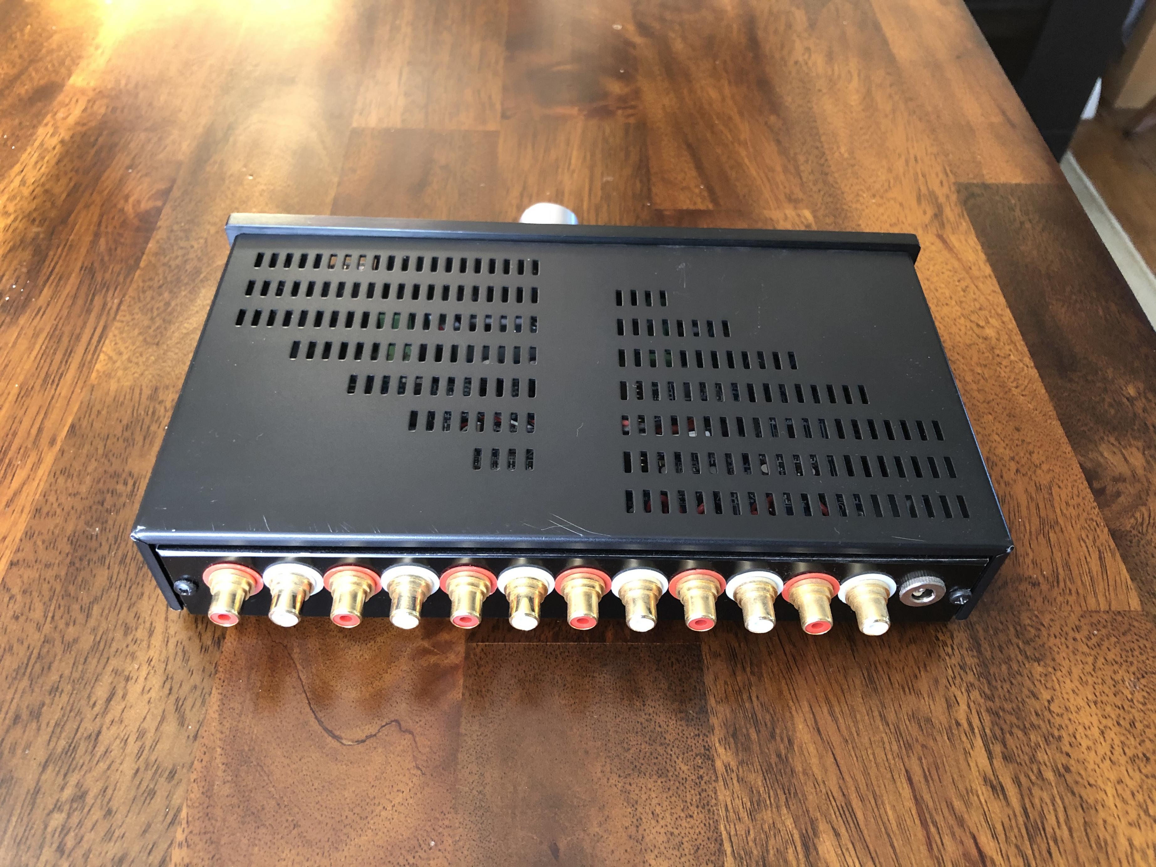

I still have one that I used for my DIY MiniDSP that I put two raw 2X4 boards into.
It was some kind of TV video call box I gutted and just used aluminum to make a new rear panel for my connections. I did it with hand tools. I used little black spray paint to match the panel to the case.
Nothing beautiful...it did the job.
Since then I mostly build from scratch now using wood and aluminum I get from the scrap barn at a local metal yard.

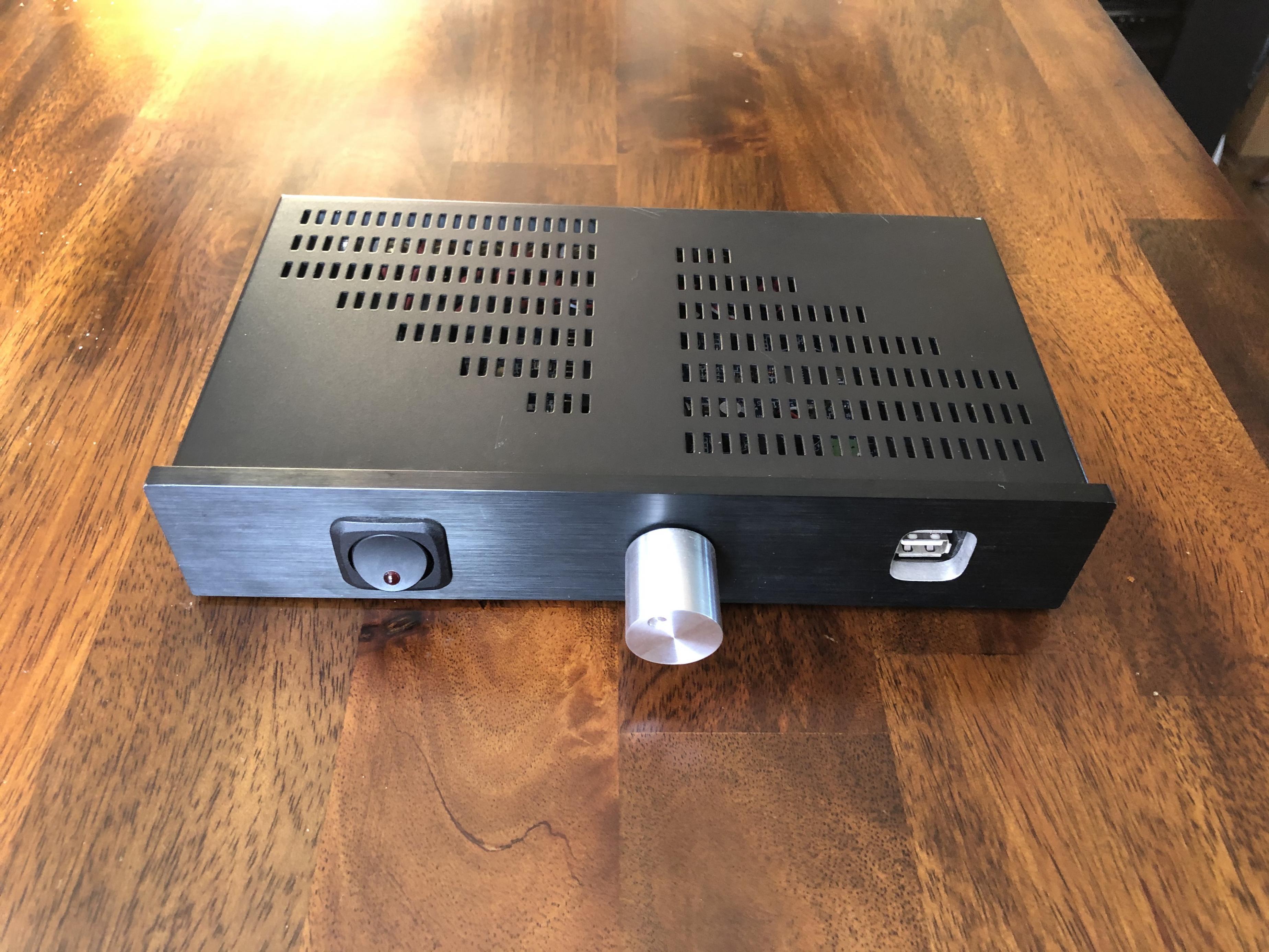

Found one of these on amazon for 19 bucks 🙂

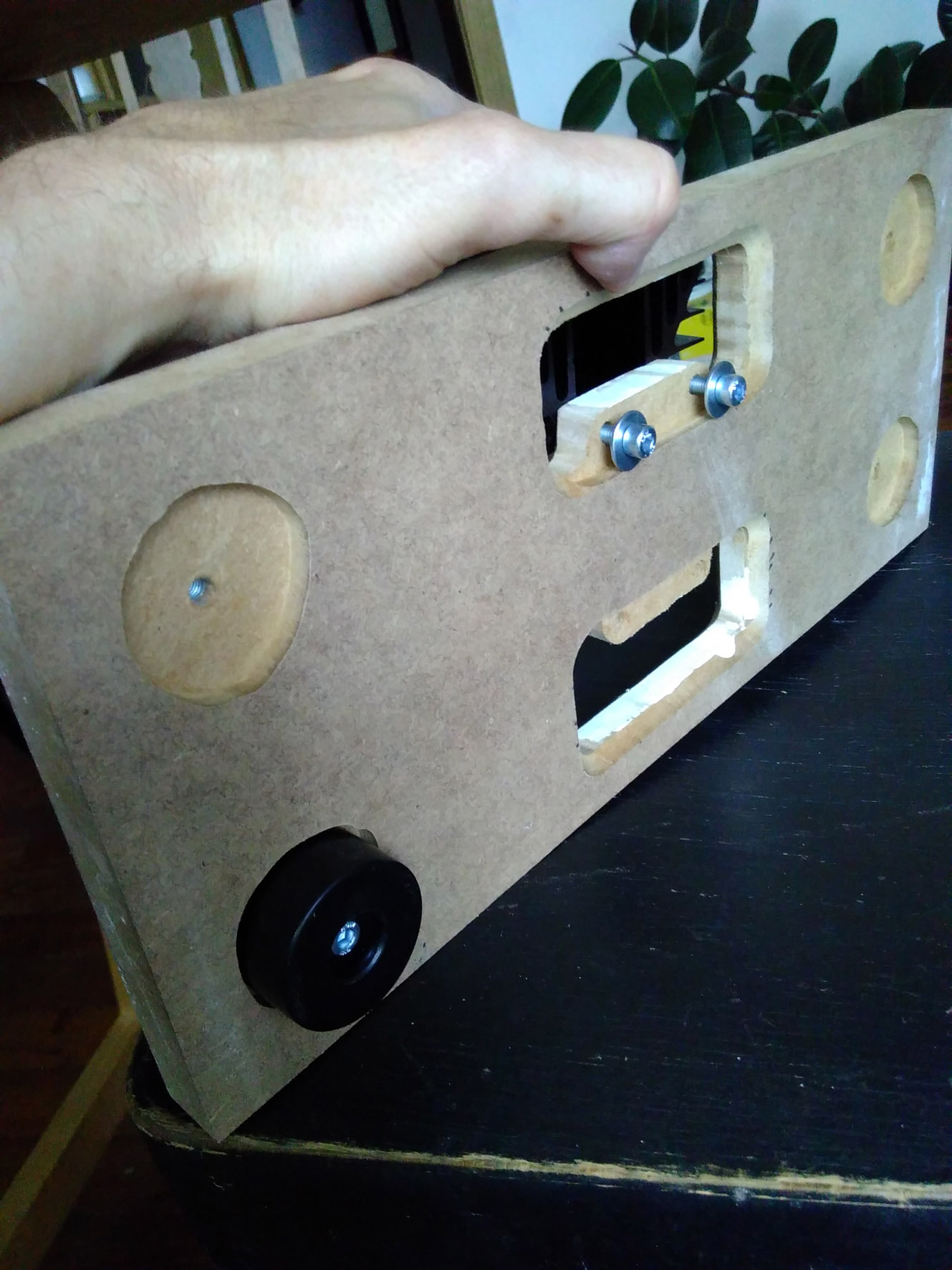

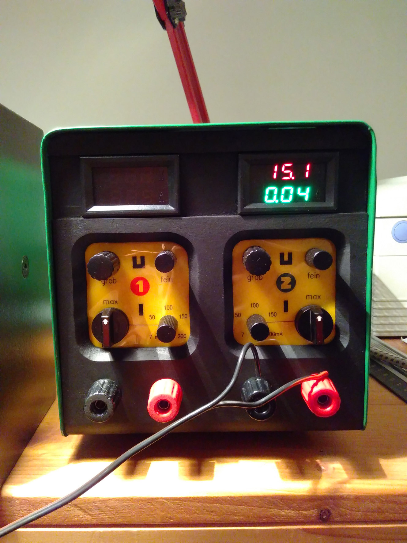

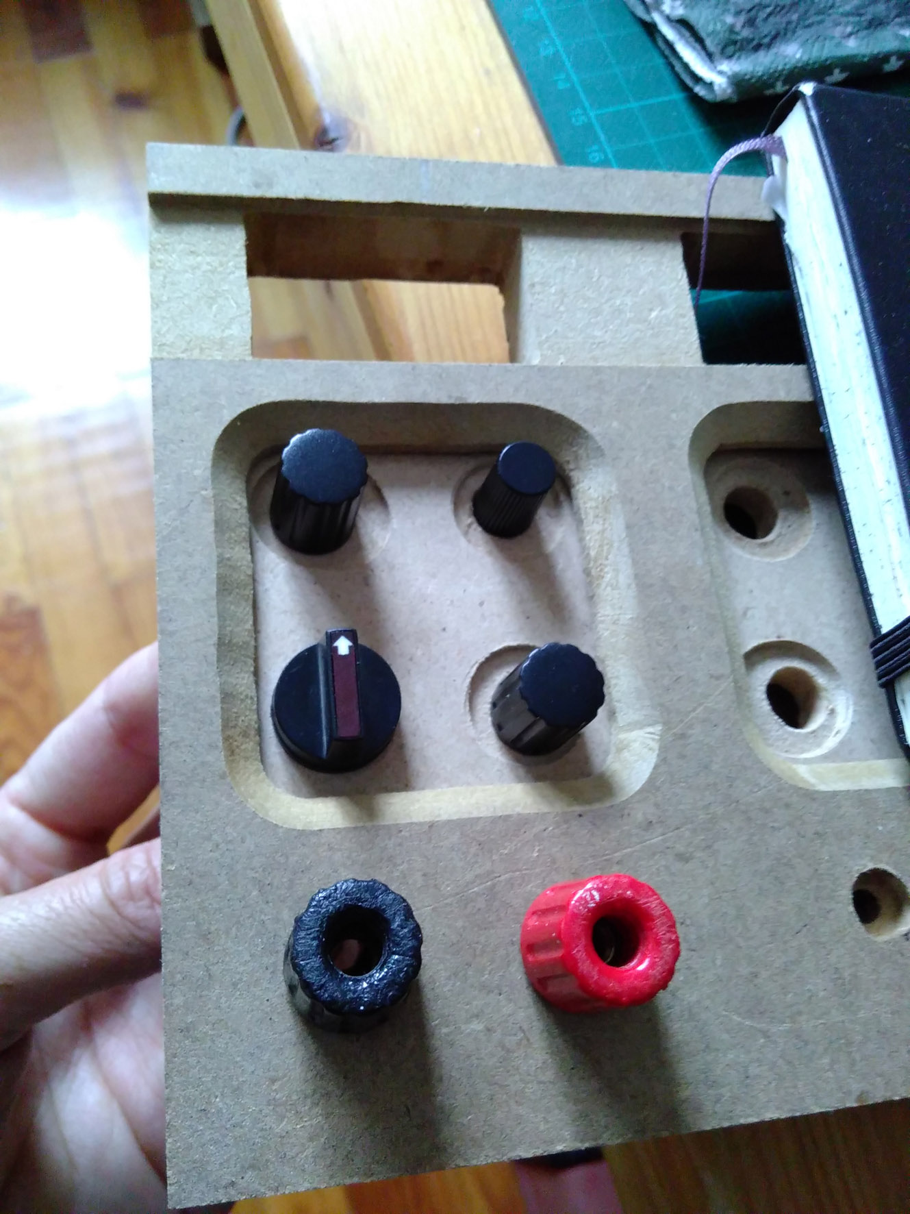

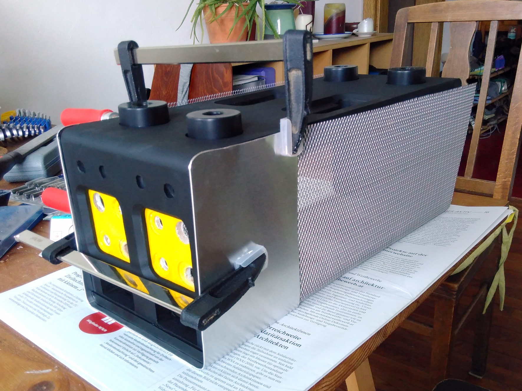

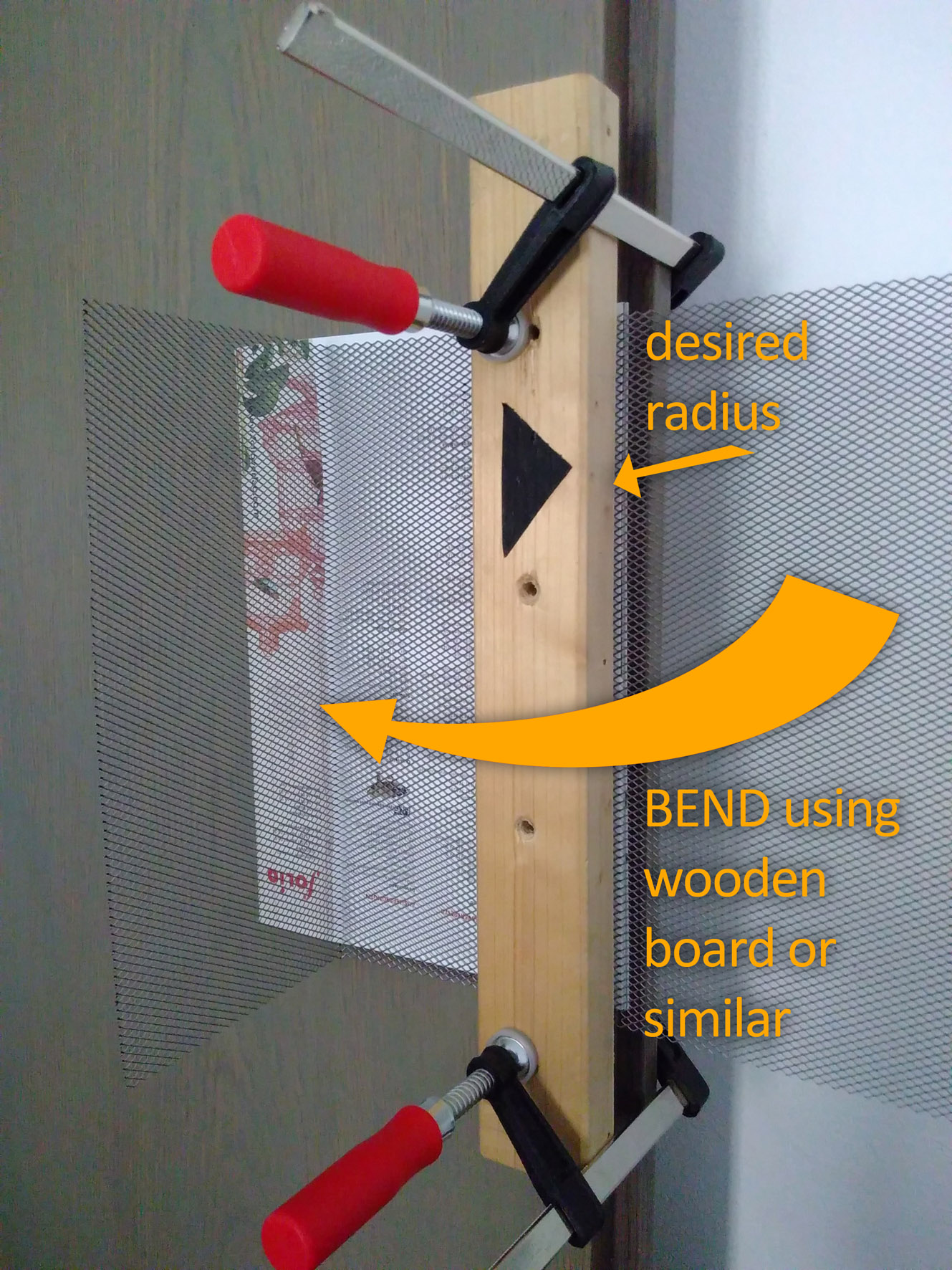

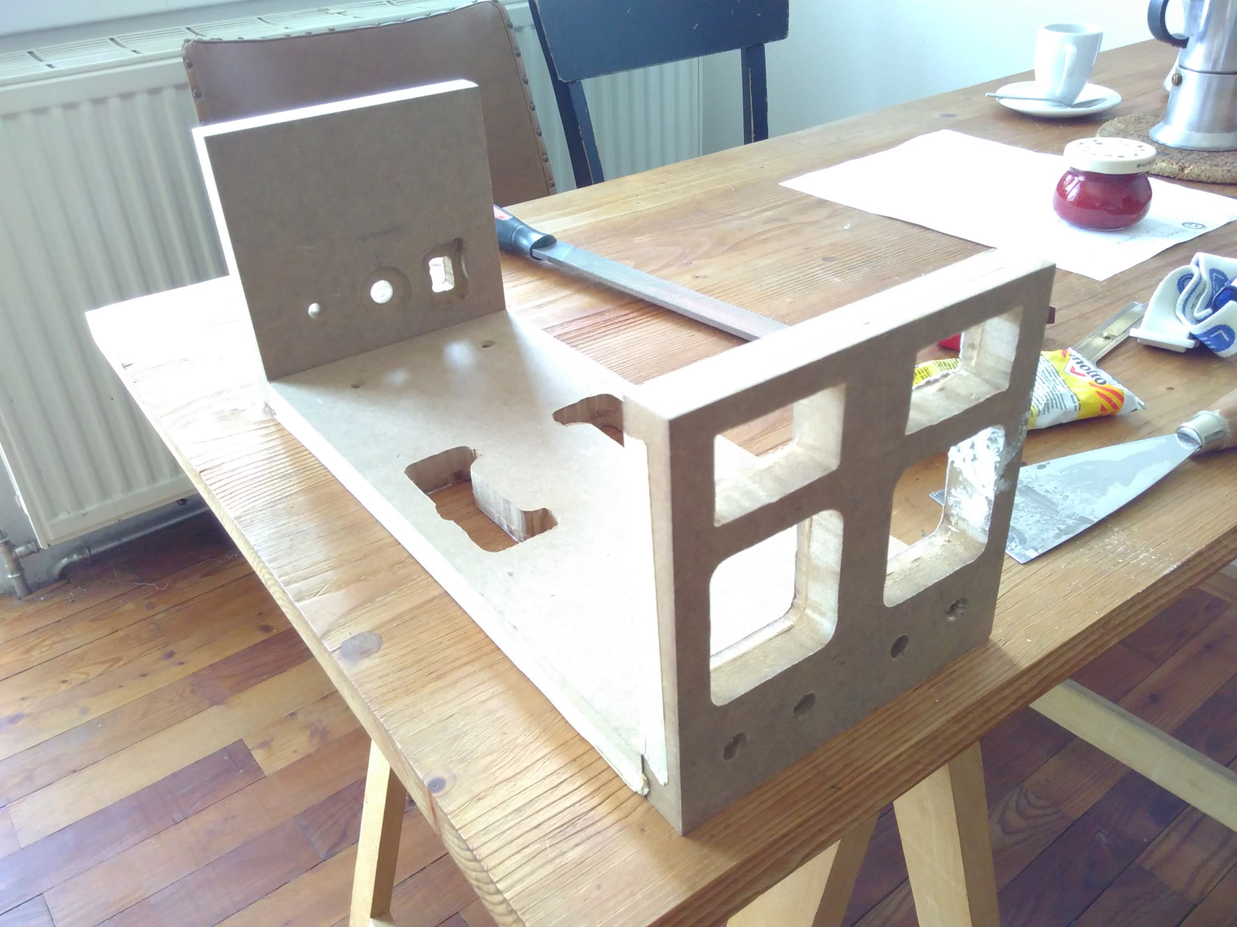

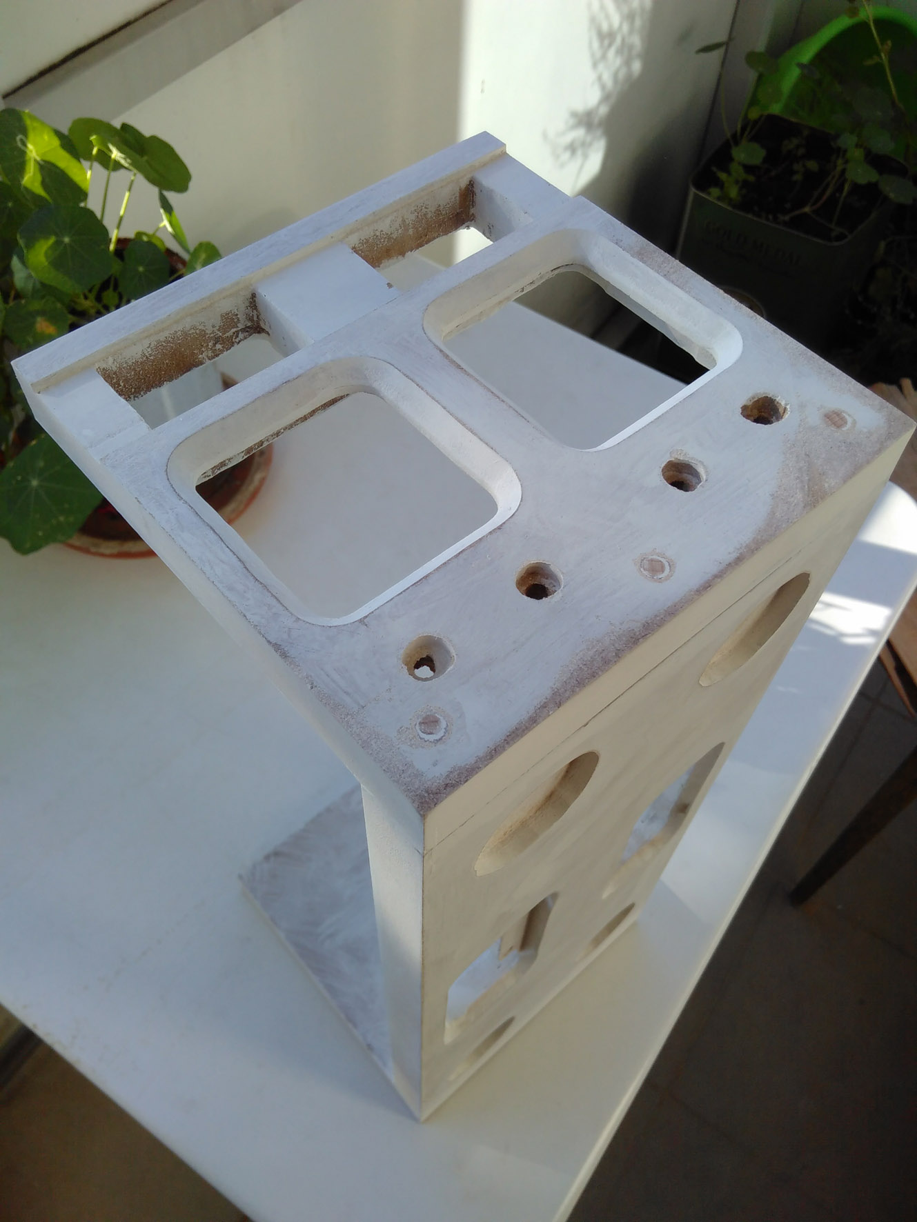

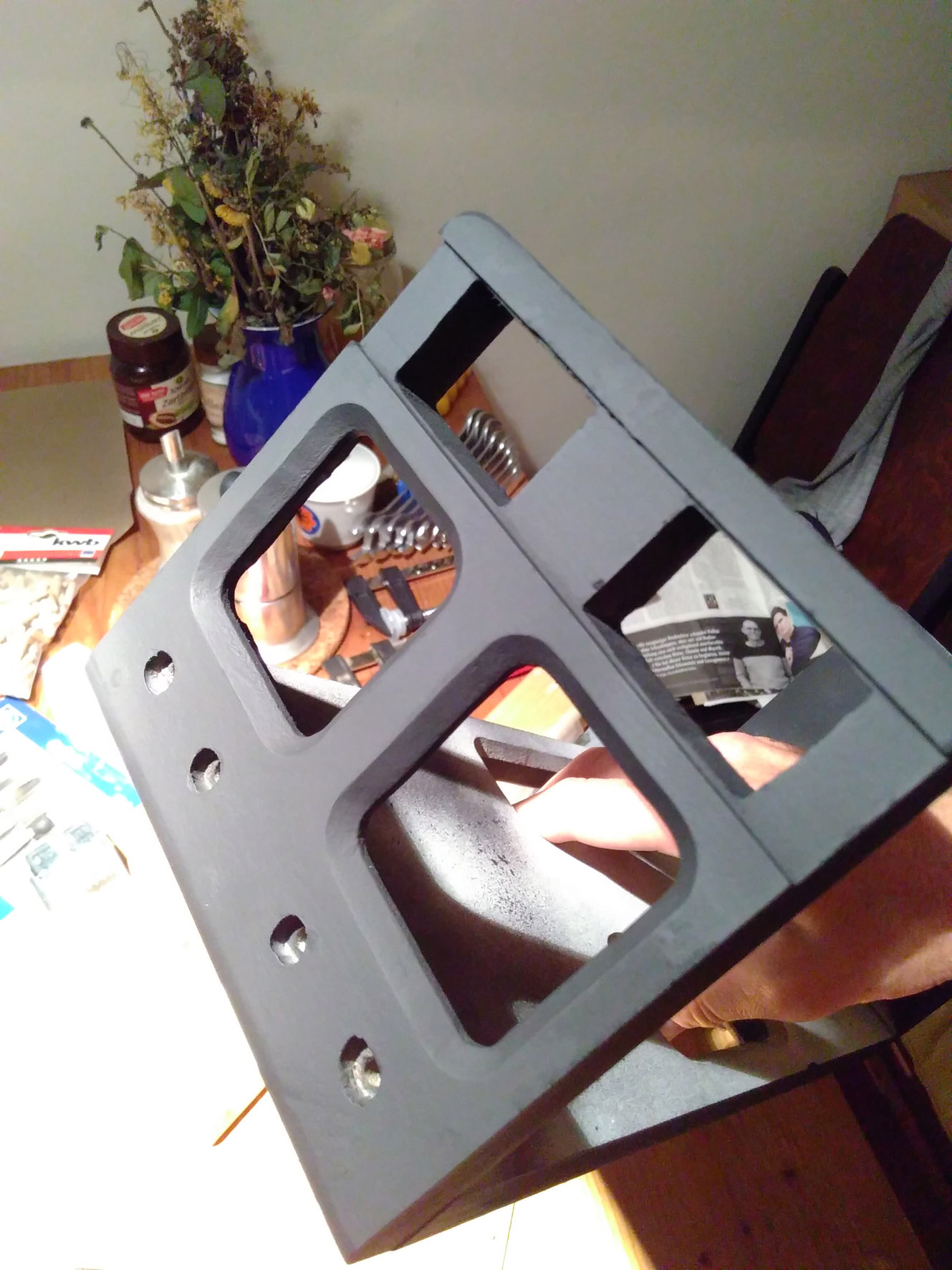

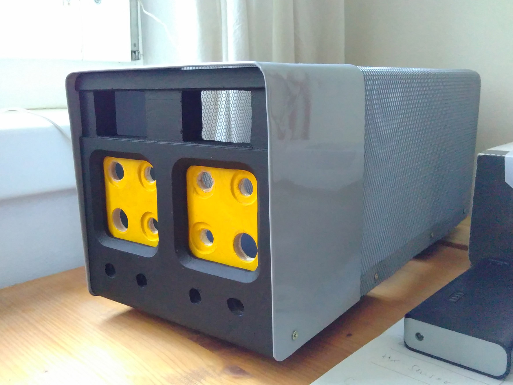

here is my quick and dirty power supply case using MDF and metal sheets, see photos. eventual shielding for an amp would have to be made with metal foil on the MDF. metal sheets in my case are be a bit thin and weak.
