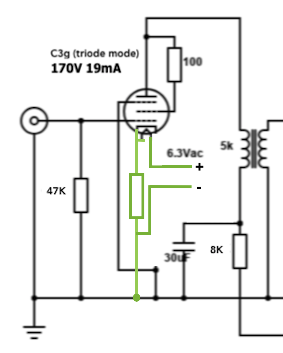

Cagomat - can the IDHT C3g (triode mode) be used with a filament bias? One of the posters on the other thread that IDHT can not be filament biased. Yes, your response on this thread suggests other wise. If the IDHT filament bias can work, please share how the low ohm value resistor is connect (without a bypass cap).
Please confirm that this schematic is correct for heater bias on my C3g in triode mode.
Whatever this is, it’s not filament bias. If it works so much the better. Another way to avoid the pesky cathode capacitor.
I tried this today and it did not work with AC filament supply. HUGE hum. My current chassis does not have enough room for the power transformer needed for the colement filament regulators, so I won't be able to try DC at this point.

Hello Pat,
If you want to try this with my regulator:
1. Change the Regulator's R1 to 2.7Ω 3W wirewound. This will set the current to ca. 370mA at the centre of the trimmer range.
2. Install the filament bias resistor. Buy 3.9Ω as well as 3.6Ω if you can.
Your connexion drawing is correct.
3. Mount the regulator with power transistors cleanly attached to the chassis;
4. Apply 12 to 14V DC to the input of the regulator.
5. Adjust the regulator trimmer to get 6.15 to 6.30V on the C3g heater pins.
If the bias voltage is not quite correct (for heater voltage somewhere in this heater-voltage range), add parallel resistance to the filament bias resistor to get more plate current, or add series resistance to get less plate current.

Trying to follow this calculation of the heater bias R...
Hi Rod, banpuku,
1. O.K.
2. banpuku's drawing in post#9 indicates an operating point of 170 Va-k and 19 mA Ia. Siemens plate characteristics put the bias voltage at -2.25 V, so Vk is 2.25 V, and is the voltage across the bias resistor. Total current through the resistor is 19 mA Ia plus 370 mA for the heater, so 389 mA. Then, Rbias = 2.25/0.389 = 5.8 ohms. No?
3. - 5. No comment
