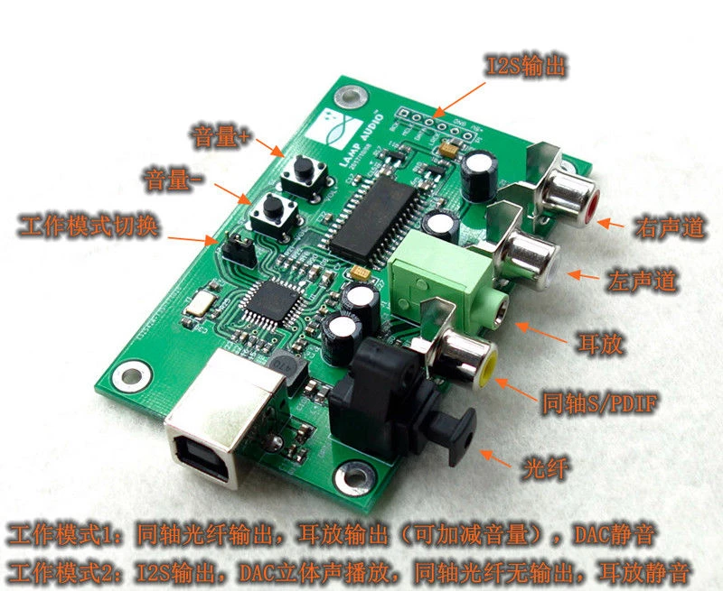

And I have one more question.
https://ae01.alicdn.com/kf/HTB1E7j6...-Decoder-OTG-external-sound.jpg_Q90.jpg_.webp
This board uses pcm2706 as DAC chip. It is sold as a DAC + converter from USB to coaxial and s-pdif. How is the digital signal passed from usb to coaxial? Does it bypass the DAC?

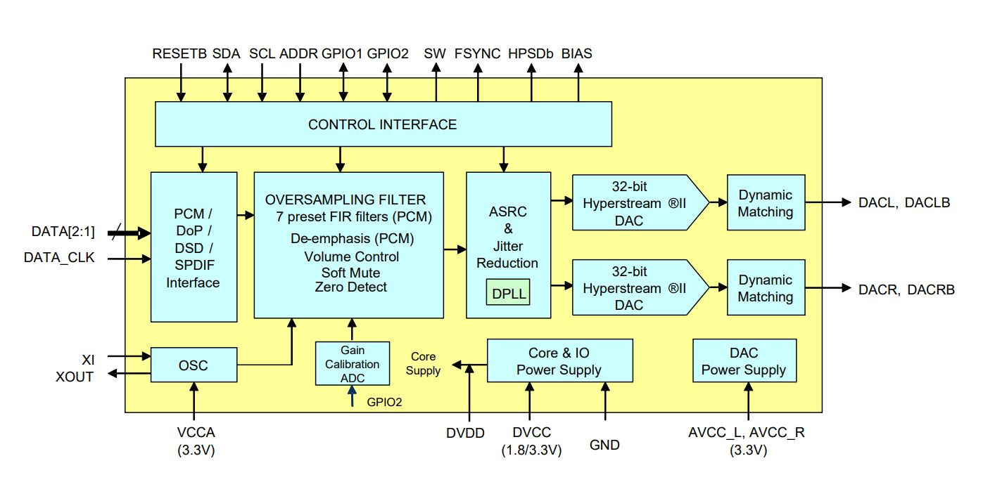

As others have been trying to explain there are delta-sigma modulators, Dynamic element Matching output resistor arrays (or if not resistors then maybe current sources, or maybe scaled transistors), all of which are often included in one DAC chip. Maybe something like this (where 'Hyperstream' is a modulator):...would like to understand how a multibit DAC behaves when it receives information from a delta-sigma DAC.
Regarding SPDIF in particular, it is not really what I would consider to be an ideal digital interface. The above diagram is for an ES9038Q2M DAC chip which includes a SPDIF decoder and an ASRC to attenuate incoming timing jitter from the SPDIF signal. However, this particular DAC chip can be configured to use asynchronous USB, which then can be fully synchronous from the perspective of the DAC itself. In that case the data can remain in bit-perfect form, and without the need for any special ASRC or FIFO buffering (one or the other of which is often used for SPDIF in order to help maintain good sound quality).
Not if by 'multibit' you mean traditional R2R type DACs without digital filters and modulators included, no. ESS is one of the few (if not the only) maker of DACs with an S/PDIF decoder on-chip.
