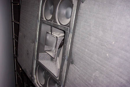

Does anyone know the theory behind the speakers used in IMAX cinemas? I know they are made by Sonics and are designed to simulate a point source. What I want is some information on how such a layout works. The subs used are a massive bank of subs that face into a slot, why? I have included a couple of pictures of their speakers so you can see what I am talking about.
Lots of speakers are also located behind the screen. The screen actually has holes in them to let the sound pass through.
One of the reasons I can think of having bass facing the slot is to let the punch of the subs expand more evenly so that prople sitting near the speakers don't particularly feel the speakers are beside them.

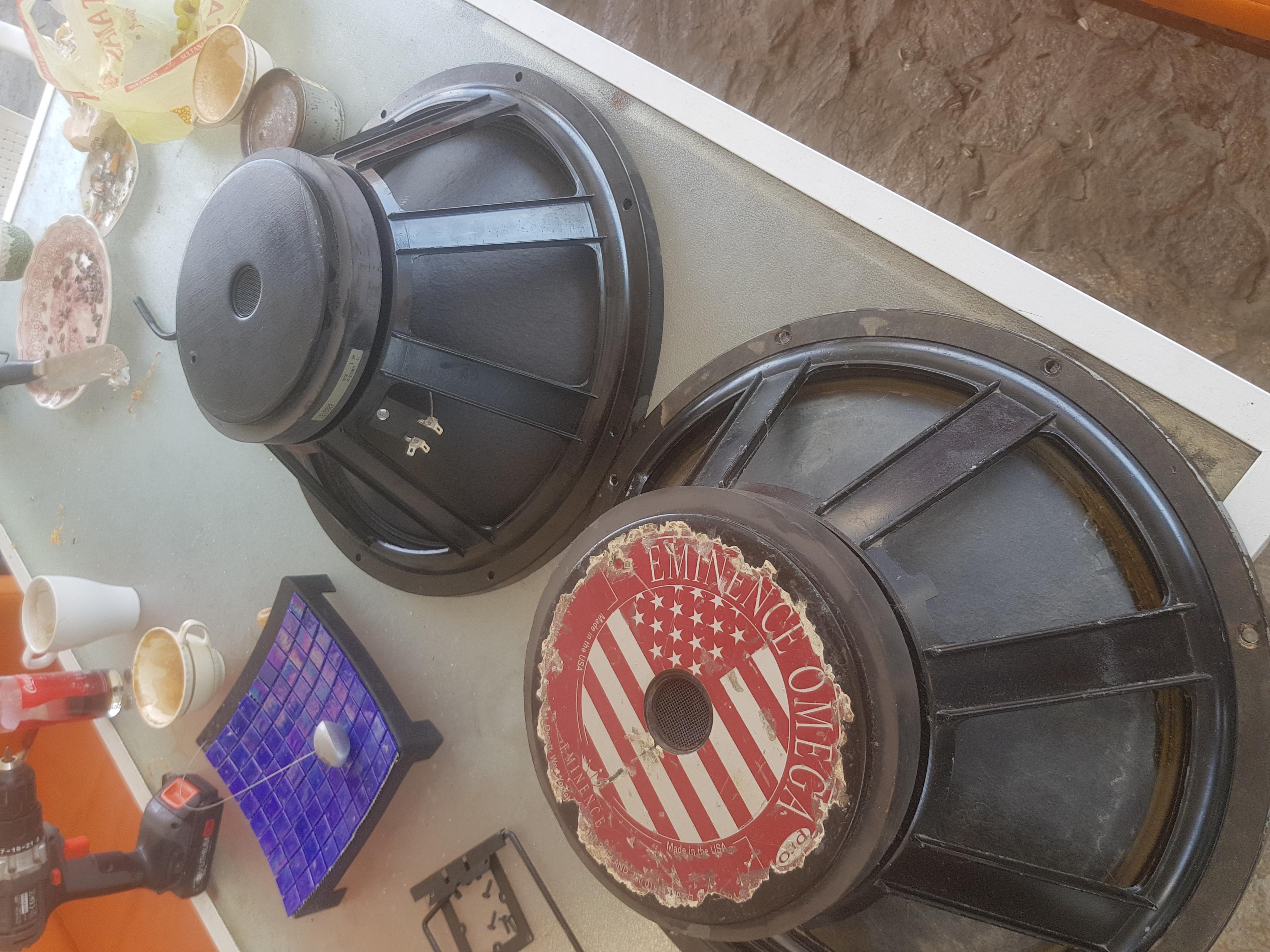

hi friends, i have a question, this is a loudspeaker???

i need a sub and i wanna 1 imax sub
friends i'll wait your answer, thanks

Its a raw 18" driver with no specifications, so generally not a good idea.

I've seen the Imax speakers up close and they have a lot of interesting details and show evidence of good design.
The first picture shows 2 concentric horns, the treble horn is in the center of the mid horn. You can see that the horns are designed to have assymetry with a downward firing directivity. The two units seem to share the same shape, one being a scaled up version of the other. This gives them identical directivity, as you would want. I assume the foam bits help with directivity and response.
Placing the horns in the center of the mid bass, and one horn in the center of the second, is just good practice for maximizing off axis performance (least variation).
Slot loaded woofers don't change performance much but do allow for a lot of cone area in a compact volume.

Hello, I was at a local IMAX and thought the system sounded good, so I got some information from the local technical eng. I recently found this thread so thought I would share. He gave me a printout with this info, it does look like an overview sheet made by Sonics.
Much if this is known already, that the system is "Proportional Point Source" or "PPS" by Sonics.
3-way
x-over points
LF 80hz to 400hz Eminence 12" x4
MF 400hz to 7khz Eminence 8"
HF 7khz to 20khz Tad-2001
Text of interest:
"proprietary horns produce an asymmetric coverage pattern to closely contour with the seating arrangement of the theatre"
"The HF section uses a 1" compression driver produced by TAD (Pioneer)."
"The PPS loudspeakers operate in the frequency range of 70Hz-20kHz. All audio below 70Hz is delivered by the subbass."
I am a little confused by the last statement because of the xover at 80 mentioned in the other specs.
