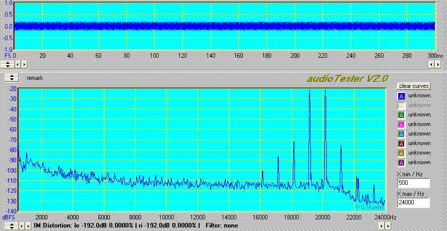

Anyone that could explain how to measure IMD and what levels are "OK"
IMD is measured using 2 frequencies, they can be equal level typically 19kHz and 20kHz or unequal level with one high say 60Hz and one 7KHz with higher level.
The non-linearity of the amplifier produce different products that are the sum or difference between the harmonics of the 2 signals.
2nd order non-linearity produce sum and difference of the 2 original signals, for 19kHz and 20KHz you get 1kHz and 39kHz. 3rd order non-linearities give products that are very close to the original signals, example 2 times 19KHz - 20KHz is 18kHz and 2 times 20kHz - 19 kHz is 21 kHz meaning that these products will be found just outside of the 2 original signals.
The total level of IMD is the RMS value of all products but I think it is of more interest to look at the level of the 1kHz difference tone and the level of the 3rd order IM products, which value is good enough it is for yourself to judge, have a look at Stereophile tests of some amplifiers then you can get some idea of what you should expect.
The highest level that is used for IMD tests are normally where each signal would give an output power of 6dB below clipping, then the amplifier will just clip when the 2 signal voltages add together so the peak power will be the same as the clipping level with one signal.
I measure IMD using a program called audiotester and a PC with external soundcard it gives result like this
