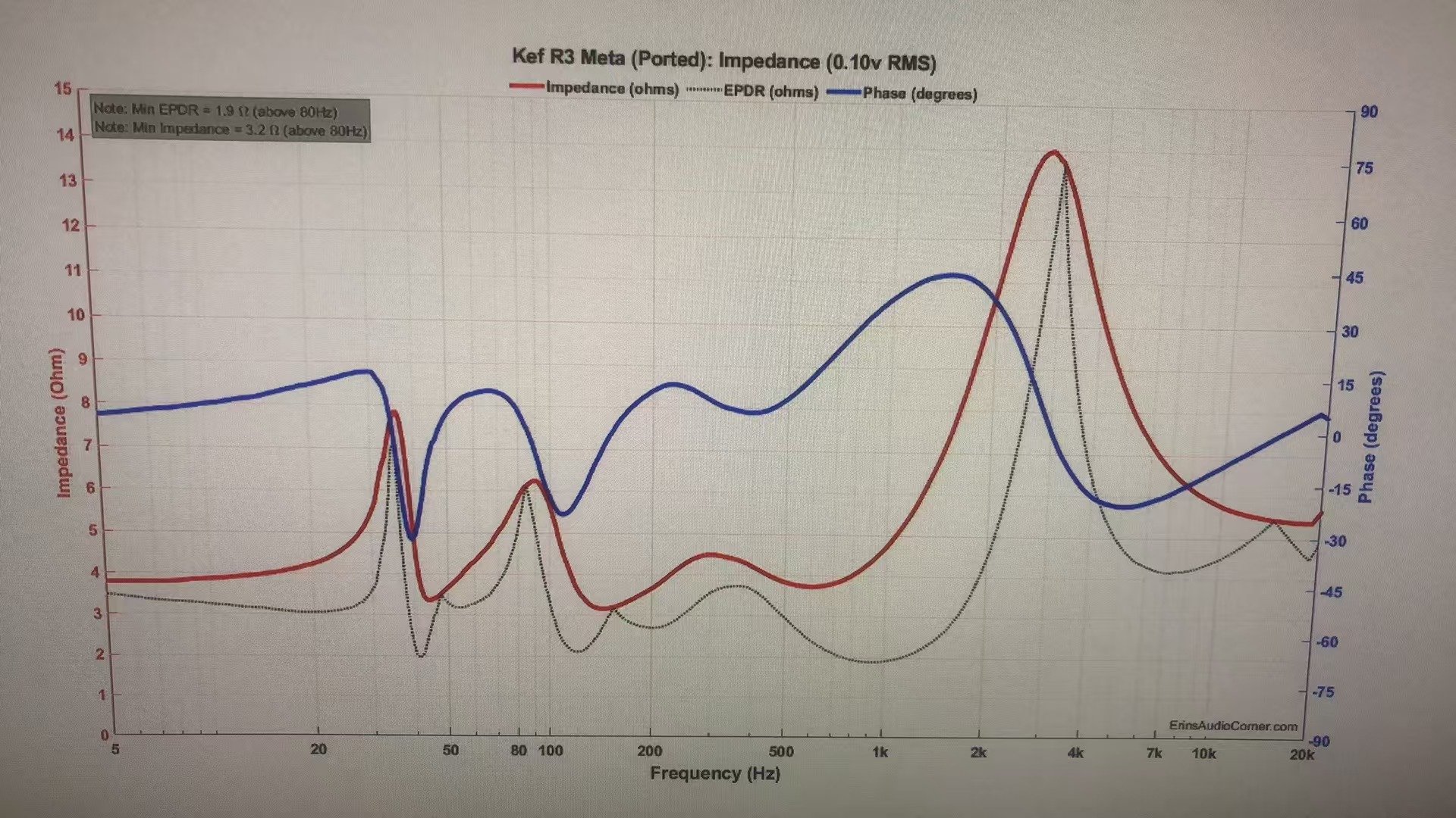

An impedance versus frequency graph would not tell the full story since the effective impedance can dip below the modulus (magnitude) of impedance shown on the graph.
Minima of 2 ohm at specific frequencies are common with 4 ohm nominal speakers, but a high quality amplifier designed for low impedance loads should not be troubled by that.
The technical explanation for this low effective impedance lies in EPDR as described in this article: https://www.stereophile.com/content/heavy-load-how-loudspeakers-torture-amplifiers-page-2
Elsewhere, member supernut supplied the attached image showing how the effective impedance, or EPDR, can fall below the modulus of impedance.

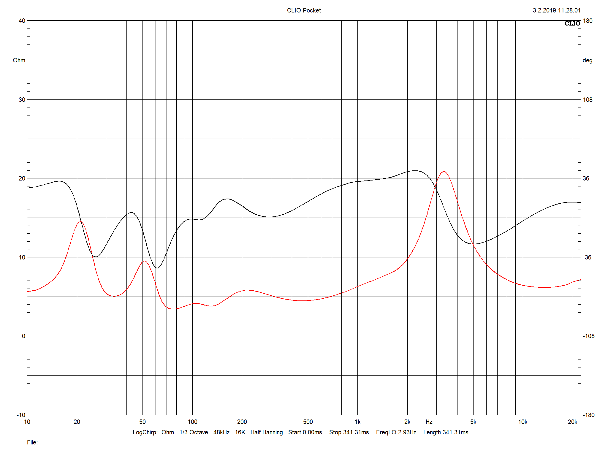

Here you go.I have a pair of Jamo D590s, these have a nominal impedance of 4 ohms, but does anyone have an impedance curve for these speakers? I want to know how kind they really are to the amplifier.
