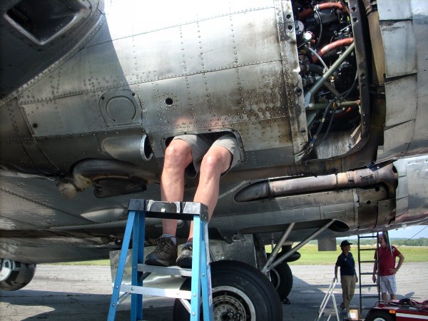

I took a ride on a B-17. Little bit bigger. It needed a "vibrator" serviced before they would fly.I don't know how well the pilot and copilot's David Clarks worked inside the B-25.

So, how did he get through that opening? I'm not very claustrophobic, but.....................................
