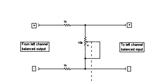

If I don't go wrong you are talking about this type of scheme:I prefer floating balanced shunt to ground attenuation topology. With this you only need one resistive element between pos/neg drive to attenuate, using only one dual deck pot/attenuator for 2 channels. Linear attenuator elements are far more precise at any given level than log elements, but it compromises range.
Simple, elegant, it does not require precision at the potentiometer level at least in relation to the prevention of unbalance between the two poles of the same channel, if anything precision is enough for the two input resistors only, the only disadvantage is that it has a minimum attenuation factor different from zero .
I'd like to know how to calculate it, I'll try this way.

The critical thing to know is that your in line resistance before the shunt becomes the dominant source impedance (including the gain stage output impedance, which would be minimal in comparison considering typical amount of NFB used).
The other thing is the actual application of the attenuator ie. whether its a dedicated volume control or an actual semi-fixed attenuator. This is important because of DC offset or input bias passing through the wiper contact, causing noise every time you touch the setting.
If you settle on actual attenuator circuit values for levels, you'll need to verify whether you have any overshoot or ringing at extreme attenuator settings. You'll be checking up to 100 kHz for even response. This guarantees stability and interconnect compatibility, factoring in wire capacitance and parasitic induction. Sometimes things look great when they're isolated, but as soon as you connect it all together, all havoc breaks loose. I'm likely exaggerating a little, but you can't be too safe with DC coupled gain stages. Sometimes you have to add series resistance to the outputs just to guarantee stability at full bandwidth at all gain setting scenarios. Most of the time, 33 - 100 ohms in series on each leg is enough and won't affect performance, unless of course your picky about resistor brands and types. I'm a Holco fan myself, but its really not that critical in this application IMO compared to NFB resistors in power amps - thats one area where cheap plated steel wire leaded resistors will stick out like a sore thumb.

As far as calculations, the shunt between pos and neg legs gets divided by two for figuring out actual level drop and insertion loss. You can see, there's alot of stuff to consider if you want high end results without any bad surprises.

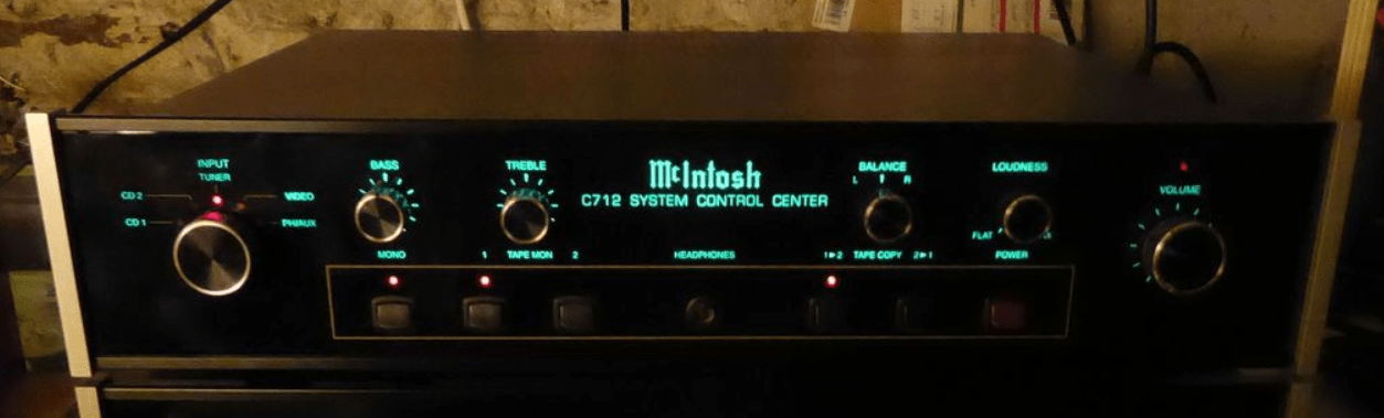

Interesting @profiguy : on my C712 preamp :
I have that kind of slight noise issue when turning the Loudness control, and at a lesser extent with the Bass and Treble controls. I replaced all the 35V electrolytic coupling caps by 50V ones, thinking that some could be leaky : improvement, but no total eradication as I would expect...
That noise is more perceptible if you turn those controls just after the powering on of the preamp, and diminishes afterwards : this made me think that it was a remaining possible leaky coupling cap issue. But where ? I changed all, with the correct value...
Maybe on a say 47µF/50V, there's a remaining leak due to the capacitor technology, even if the cap is new, and this can cause that little noise on sensitive (or poorly designed) circuits ?
T
What kind / brand of caps did you use? I usually recommend the nichicon muse non polars (green cans).
What you're hearing is likely the caps still charging when the control noise is more noticeable. Sometimes it can simply be the design of the circuit too. As long as the voltage ratings are high enough on the replacement caps, there's nothing really else you can do other than modifying the bleed resistors (or installing some to begin with if not so equipped). You could try some metal film 47k - 100k/0.25W resistors across the output terminals to signal ground. That should eliminate most of it.
I don't remember the brand... I chose 50VDC instead of 35VDC, and the exact same µF polarized capacitors values as the originals... I did not thought one second about those nichicon muse non polars (green cans) you recommend, @profiguy !
Yes indeed, I agree with you about the remaining noise and circuit design... That said, I can plentifully live with that noise issue, as it is way far from dramatic !

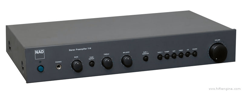

But simply think that my unpretentious NAD 114...
... Is PERFECTLY SILENT on all his pots movements, unlike the much more costy and "tradition of excellence" McIntosh C712 ! Il faut tout de même avouer que cela fait désordre !

You may also have huge channel-to-channel imbalance. The typical pot total resistance tolerance is +-10% or +-20%.Simple, elegant, it does not require precision at the potentiometer level at least in relation to the prevention of unbalance between the two poles of the same channel, if anything precision is enough for the two input resistors only, the only disadvantage is that it has a minimum attenuation factor different from zero .
Potentiometers are best used in true potentiometric (voltage divider) circuits.
The second circuit is therefore better in this regard but both circuits suffers from common-mode voltages not being attenuated at all.
I'd personally choose the simple 4-gang pot standard attenuator circuit, placed near the receiving end. The mismatch in output impedance (from the above value tolerance) and the pos/neg path attenuation mismatch will not be a deal breaker. A proper balanced input is immune to this anyway.
