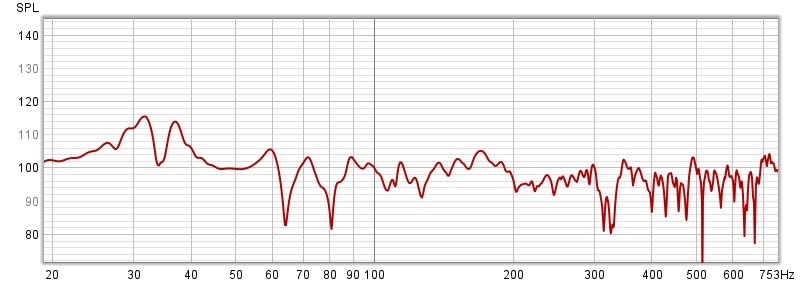

I did some measurements with REW today. I attached the complete set of measurements, but here is an example of the listening position with both main speakers playing.
I also took some measurements in the corners and on the side walls, where I'm thinking it would be possible to place some kind of bass traps, thinking it would show if a certain position is better for treating a specific room mode. Usable corners are RL and the front wall corners, even if there are space limitations.

When shopping some basotect for my speaker build, I also bought some other sound treatment (/insulation) materials. They are all in the 120*60cm format (due to shipping I guess).
So, what I have at the moment is:
2x 'Recycletherm Km0' recycled textile fiber (denim) sheets 6cm thick
4x 'Naturtherm' hemp based insulation 4cm thick
2x self adhesive basotect 3cm thick
One fiber board (porous board, directly translated from Swedish https://www.beijerbygg.se/privat/sv/produkter/byggmaterial/byggskivor/board/poros-board) 120x240cm, 12mm thick. I had some fantasy that this would work for as a porous broad band absorber placed in a corner. Not sure if it would work at all, but it's relatively cheap.
All these are 'natural' materials, I don't want to bring rockwool etc into the living room. I have some allergies since I was young, and I don't want to risk it with those materials.
I have been reading a lot on the internet, and watching some youtube educational videos like this to get some basic understanding:
So, some of the ideas so far:
-Modify the sofa even more, seal the underside to the floor, to make it a porous absorber, utilizing the pillows on top +the
IKEA pillows as the porous absorber, and the floor as the sealed back.
-I also have a 'foot rest' for the sofa (not in the picture above) which is basically a large box with an open bottom, and a pillow on top. The box part could be re-purposed to make a Helmholz resonator or some other kind of absorber. But could only be placed along the left wall.
-Some absorbers in the corners of the front wall (behind speakers). I'm thinking porous absorbers making a 45deg corner, possibly a small helmholz resonator built into it using cardboard pipes (the type used to make concrete pillars') However there does not to he high pressure of the main 35Hz mode there. My understanding it that it's best to treat the modes at their pressure maximum. Seems better in the rear left corner?
-Make some kind of removable 'head rest' for the main listening position to dampen the reflection from the rear wall / windows behind the sofa.
-Make a small Helmholz resonator (or two, maybe tuned to different frequencies) to put in the corner behind the sofa. Small one will probably not do much for the overall room, but maybe it could improve the situation when sitting in the corner? If so, I could put one behind the main listening position too. I'm thinking carboard pipe with sealed ends and a single 'reflex tube' to tune it.
-Some absorbers in the ceiling to take care of the first reflection. Maybe the hemp-based insulation with some fabric around it.
-Some absorbers to take care of the side wall first and maybe second reflections.
-Possibly some better absorbers on the front wall behind speakers.
'Next level fantasies'
-Multiple subs (not so keen on it due to space restrictions and cabling needed). I have the sub for the TV, but since it's behind the right speaker, it probably would not improve things to connect it to the stereo.
-Active absorber, basically mic and sub with some filtering. Played around with this earlier, but it was hard to get right, and it would amplify at LF due to phase margins. Same applies as above when it comes to space.
Hoping for suggestions what I shod concentrate on, and if there is something I can strike off the list right away maybe?

I found I did the measurements with the DSP optimized for the corner (left channel delayed), so I re-did the listening position.

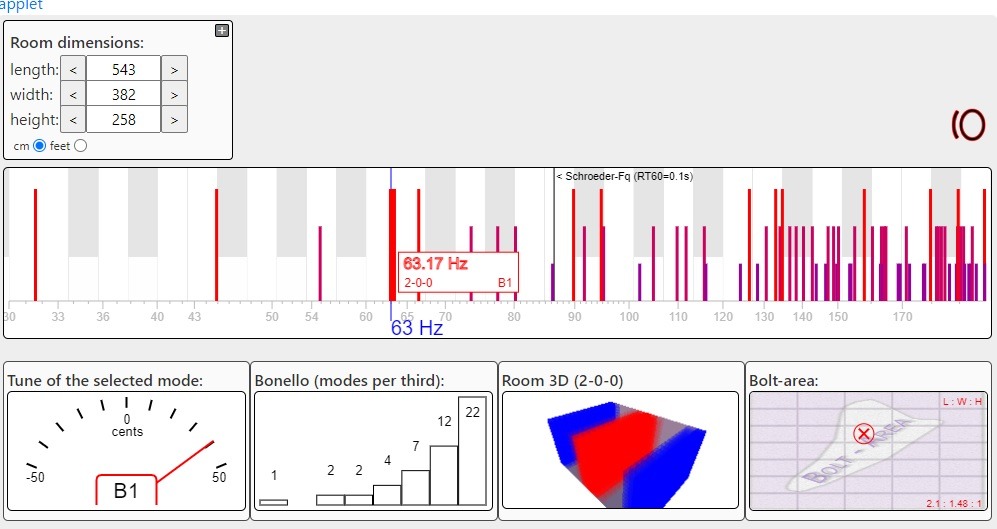

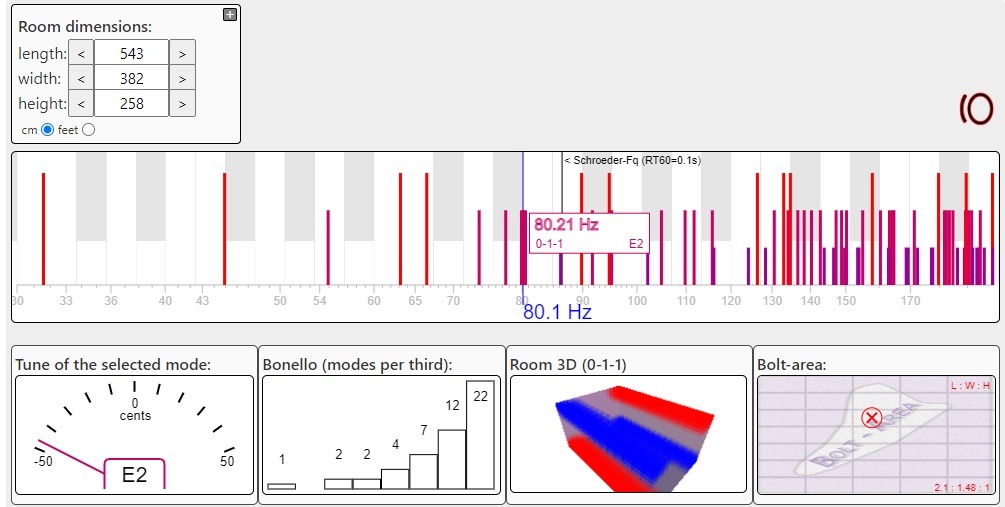

It seems that looking at the FR, the nulls at 63 & 80Hz are the worst, and these are more even in the corner(with the delay active), and it sounds a bit better. I'm guessing the asymmetry and compensating delay make it more even in the corner?
Here are some screenshots of that, also showing where the nodes are:
Link: https://amcoustics.com/tools/amroc?l=543&w=382&h=258&fo=200&fu=30&r60=0.1
So, there are these nulls in the frequency response, and also the ringing from standing waves. I have a feeling these are the biggest issues in the subjective bass 'quality' when listening.

Bass is not good, so I would like to improve bass in the listening position. I don't care much about even bass in the whole room though, like with home cinema with a lot of seats etc. I would also like to improve clarity in the midrange, and for that I was thinking something for the walls and the ceiling to take care of some reflections (and flutter). I think the bass is the biggest problem both sound quality-wise, but also the most difficult to solve.
Looking at my example in post 10 above, I think I have identified two serious nulls at 63 & 80Hz in the listening position. Looking at the room mode sim, it looks like the 63Hz is a multiple of the standing wave between the front and back wall in the room, and pressure maximums should then be at the back and front wall. To my understanding, the treatment should be put in those positions to be effective? So I'm thinking some tuned resonator could do some good if placed close to the wall, and possibly close to listening position too (since listening position is close to the back wall).
The 80Hz seems to be a diagonal wave between left upper and right lower corners along the room, so the most effective places to put some treatment would be somewhere along those corners? I'm thinking maybe try a resonator in the rear left corner for that?
When I'm talking resonators, I primarily think of a small Helmholz, in principle a 'reflex box without a woofer' placed somewhere were the SPL for the problem frequency is relatively high, what I would call a high pressure node(?). Using some smaller 'sonotube' and some pipe, I should be able to make some resonators pretty easily to test out. I also simulated the placement of the damping in the resonator, and that seems to have an effect on the Q, and also some on the tuning frequency, so I'm thinking of attaching some damping to a stick poking out of the reflex pipe, so I can slide the damping back and forth to vary the resonator tuning a bit.
I have no idea what a small Helmholz resonator can achieve, maybe it has to be enormous, but I don't have the space for that.. I guess I would just have to try and see if it makes things better.
I know I can't aim for perfection, only improvement.

Yeah if I had some acoustic panels and would need throw them quickly somewhere I'd put those on the back wall behind listening spot, kind of "between speakers", ear/speaker height. Also some to first reflection points on side walls, again at ear/speaker height, basically from your doors towards listening position as many as you have. Ceiling if there is more.
Yes resonator would work at pressure node and absorber would be most effective at velocity node.
