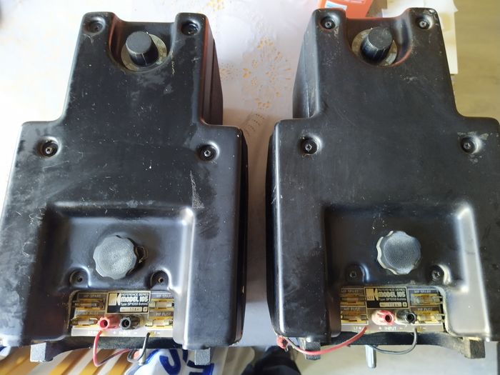

Hi Members,
I bought last week a pair of Kef speakers, type 105.
Type SP1059 is mentioned..but furthermore I might had done a little bit more research before buying them (read: older speaker/ availability of parts)......(hopefully I attached the pictures correctly)
I still need to pick up these (most likely next week) and would be nice if you are able to give me some information:
- Which series are these 105 series 2 ??
- I will listen to these (most likely) next week.. what are the main point of attention (besides not blown up woofers or other strange noises)
- Cross over filter - needs to be recapped ?
- It seems like a relative original speakers, most likely I will try to refurbish them cosmetic - any good (online) stores for parts ?

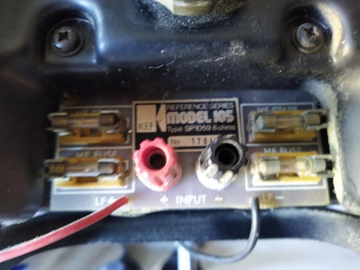

Details of speaker are here: Reference Series 105 SP1059 Speaker-P KEF Electronics ,
Brochure and manual here -
105
KEF - Reference Series Model 105 (1977-79) - United States
105.2 (SP1118) has “series II” on the rear plate.
KEF - Reference Series Model 105.2 (1979-87) - United States

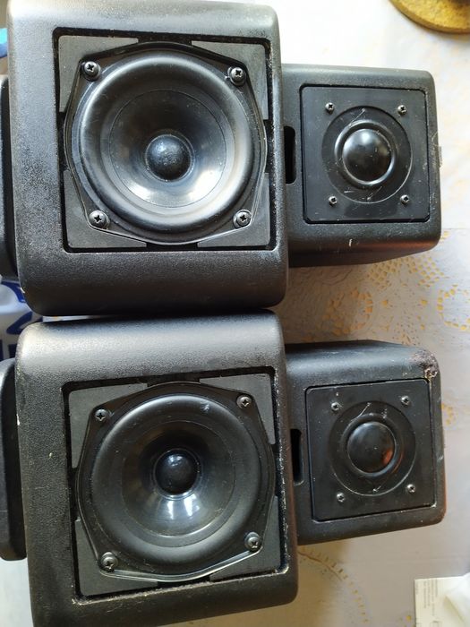

Cool speakers! Woofer dust caps looks dented and they seems to have been stored in a none heated storehouse based on the look on metal parts and some cracks in some wood
These are Mk 1's. Mk2 had B300's front mounted. The dustcaps of the woofers have been pushed in obviously. The B110's often do last long, but try pushing surrounds gently to feel if they've become brittle or hard. All cone units should move freely when pushed.

Old Kef reference are good speakers.
First things you must do is to gently dismantle the tweeter if it is a ferro fluided that have dried. 15 GBP fot two drivers.
Then try to vaccum the bass dust cap that suffered to give it again its shape.
Then try to measure the capacitors when you will have some time...Falcon Acoustic have some values. You can for instance try to swap the medium serie caps to see what you hear and if the resistance serie of the former caps has increased too much.

I rebuilt a pair of R105 several years ago. My domes were in a much worse condition and took a lot of work to fill gaps, sand, prime and paint.
The crossovers from that era seem to show noticeable drift in the capacitors and they will really benefit from a recap. As KEF told, they matched the parts and drivers and that certainly has expired for these so best bet is to aim for the nominal values on the capacitors.
The bass enclosures do have a diagonal brace back to front but not cross-bracing between panels. Also, they have pieces of bitumen sheets in places, but that has hardened perhaps to the point of ringing. I carefully removed these pieces on mine and glued fresh pieces to the side and back panels. 2 layers of 3mm bitumen sheet.
Also, one weak point is the binding posts on the domes and the fuse holders. Corrosion needs to be removed or the fuse holders replaced with fresh. I've read about some opinions about removing the fuses altogether. I, personally, wouldn't go that far.
The T52 isn't ferro-fluid cooled, so one less point to worry about. The B110 IS NOT the SP1003 that is very common but the less widely available SP1257. There is some difference between the two. A slight but audible one.
The B300 is pretty robust in this series and you might need to rotate it 180 degrees, if they have been stored idling for years.
It appears that they don't come with the hoods. That's a shame and a blessing. If you work on the cosmetics, you can re-finish the domes and bass enclosures so they are presentable.
There should be a thick (~1inch) foam pad on the top of the bass enclosure around the dome. Better to make one for them as I would consider the reflections to make audible contributions.
