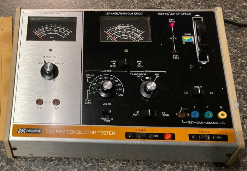

They have been around for decades and they do work if the associated circuit is no too extreme. I have a B&K 530 http://bee.mif.pg.gda.pl/ciasteczkowypotwor/B&K/B&K 530 Semiconductor Tester.pdf that can test transistors in circuit, identify them etc. Out of circuit it can even check the Ft of the transistors.

....I have a B&K 530 http://bee.mif.pg.gda.pl/ciasteczkowypotwor/B&K/B&K 530 Semiconductor Tester.pdf that can test transistors in circuit, identify them etc. Out of circuit it can even check the Ft of the transistors.....
I used one of those along time ago (in the 1970s) & it worked much better than I expected it to.
B&K Precision 530 Semiconductor / transistor tester | eBay

The picture bought back memories a useful tester.I used one of those along time ago (in the 1970s) & it worked much better than I expected it to.
