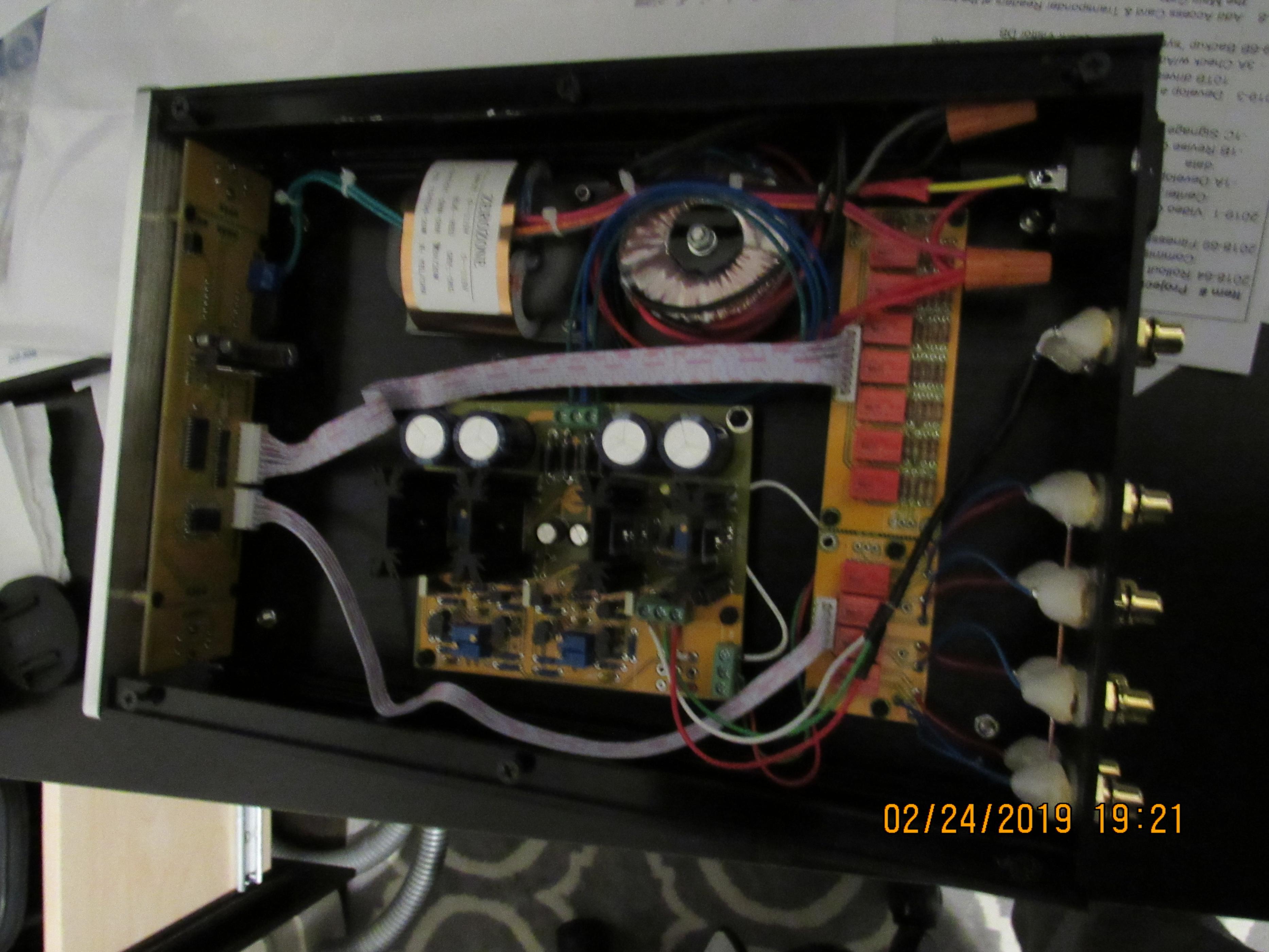

I prefer the version with a larger enclosure.
Finished HIFI Remote volume Controller 128 steps /4 way input + display | eBay
After I received the item, I used remote controlled selector and volume control alone for several week, essentially as a passive preamp. It is one of the best e/bay value that I got in recent years. It is completely quiet and perfectly neutral as it should. No switch noise that I can hear. I have 3 inputs connected. The Harman Kardon AP2500 used as a phono stage only, a Marantz ST7001 tuner and a modified ES9038Q2M DAC for cable TV box and Blu Ray player (also for streaming). The aluminum cased remote is heavy and the shape is awkward, but the control bottoms are responsive. The preamp output is routed to a rack housing the 3-way Linkwitz-Riley Crossover and the 3 stereo power amplifiers.
I added an output buffer and removed the AC switch at the back.
After adding the JC-2 board, the sound remains neutral and musical. After 6 months, I have one complaint against this JC-2 board. It is very good 90% of the time. But if I listen to music with exceptional dynamic range and want to turn up the volume more, I can hear a faint noise in the background. The board is not extra noise, Just the combined result of a simple JC-2 with a simple power supply. The noise may not be noticed by most users. I do not have enough skill and experience to improve the noise performance of this box. I used an shielded twisted wire from the buffer board to output RCA, but I did not change the input wires thinking that they are short and away from the main. Hopefully, some one may see it as a good DIY project to improve the noise, then, I can copy. 😉
