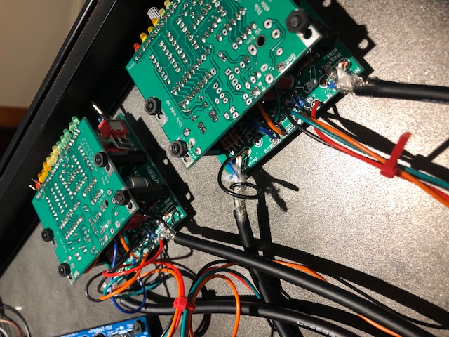

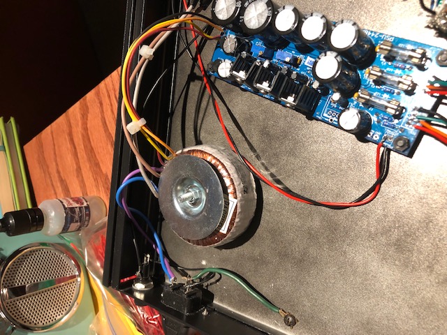

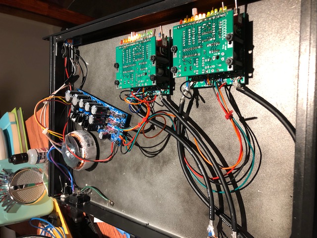

Hi, all, I hope this is an appropriate subforum for this. I've put together a mic preamp that utilizes the TI INA217. The power supply kit comes from FiveFish Audio and I've set it to supply 15v on both rails. Everything powers on just fine, but after a short while, some strange feedback starts happening that I can't control with any of the switches and doesn't go away until I power the unit off. I'll include some pictures of how I have the thing assembled so far. Any help or clues would be very greatly appreciated!
Also, how can I attach a sound file? I recorded the feedback that's happening; it sounds like low-frequency oscillation. When it starts happening, my LED under the V+ rail dims considerably and the LED VU meter on the preamp channel lights up in time with the noise.

If LED's are dimming then that points to a rail dropping. Before worrying about whether its an audio fault or not, monitor the rails and see what happens. Do the regulators get hot? Do any of the electrolytic caps get hot (one fitted wrong way around)?

Okay, so I just checked the V+ rail when its making the noise, and the voltage jumps up to 33V and up. So it starts at just below 15V where I calibrated it and it just goes up. Nothing seems so hot that it's worrisome.

Bad solder joint. Start near the regulator, but could be elsewhere.

PRR's suggestion is a good one, if there is a bad connection on a regulator then it loses its reference points and the output can shoot up.
I'm assuming this is a dual rail supply with plus and minus 15 volts?
A diagram would be a big help in diagnosing this and in helping you pick test points.

Hey friends, sorry for the delay. The VU meter boards on both channels were acting up, so I disconnected them and the problem went away. The only thing I can think of was that I had to substitute a couple of transistors since the ones listed on the BOM were obsolete. I still wonder how the voltage could have gone that high...
