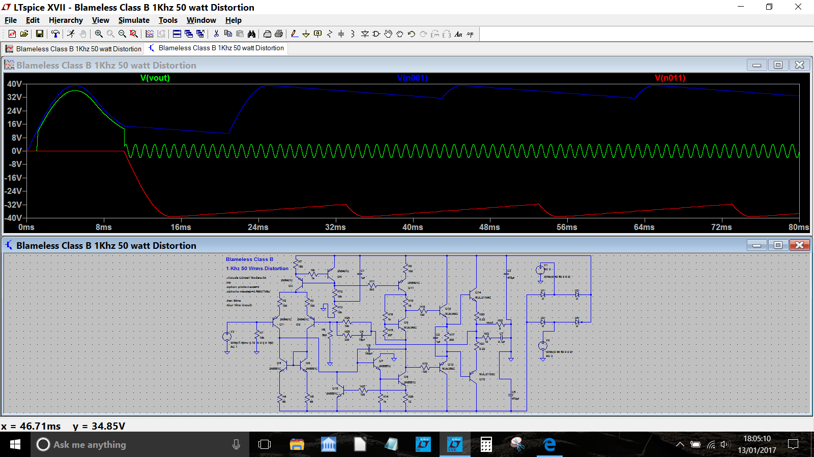

Have a look at this I cobbled together. Proper PSU (you would add any series resistance needed) and very small reservoir caps.
  • Blameless Class B 1Khz 50 watt Distortion PSU.asc

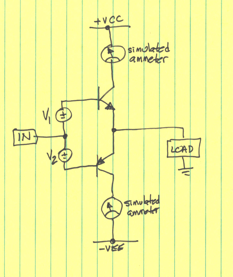

Build a phony baloney output stage consisting of a pullup transistor (NPN? NchMOS?), a pulldown transistor (PNP? PchMOS?) and two ideal voltage sources, one in series with each base or gate, which emulate the "Bias Spreader". Fiddlefart around in .DC analysis, changing the voltage sources values, until you get the desired amount of DC bias current in the output transistors. Now switch to .TRANsient analysis and apply your music waveform to the bias spreader. Done.

I was thinking it ought to be considerably simpler than modelling an amp. I merely want to model the sinusoidal current waveform 'split' between the rails (if that makes sense) but can't see how to split it. I'm not even so much worried about the DC bias draw as it likely rounding error for what I am currently looking at but that could be added. I'm most focused on checking cap ripple, RC resistor power dissipation etc.
EDIT: I've just seen Mark's post. Seems like a good 'halfway house'. Thanks. I will take a look.

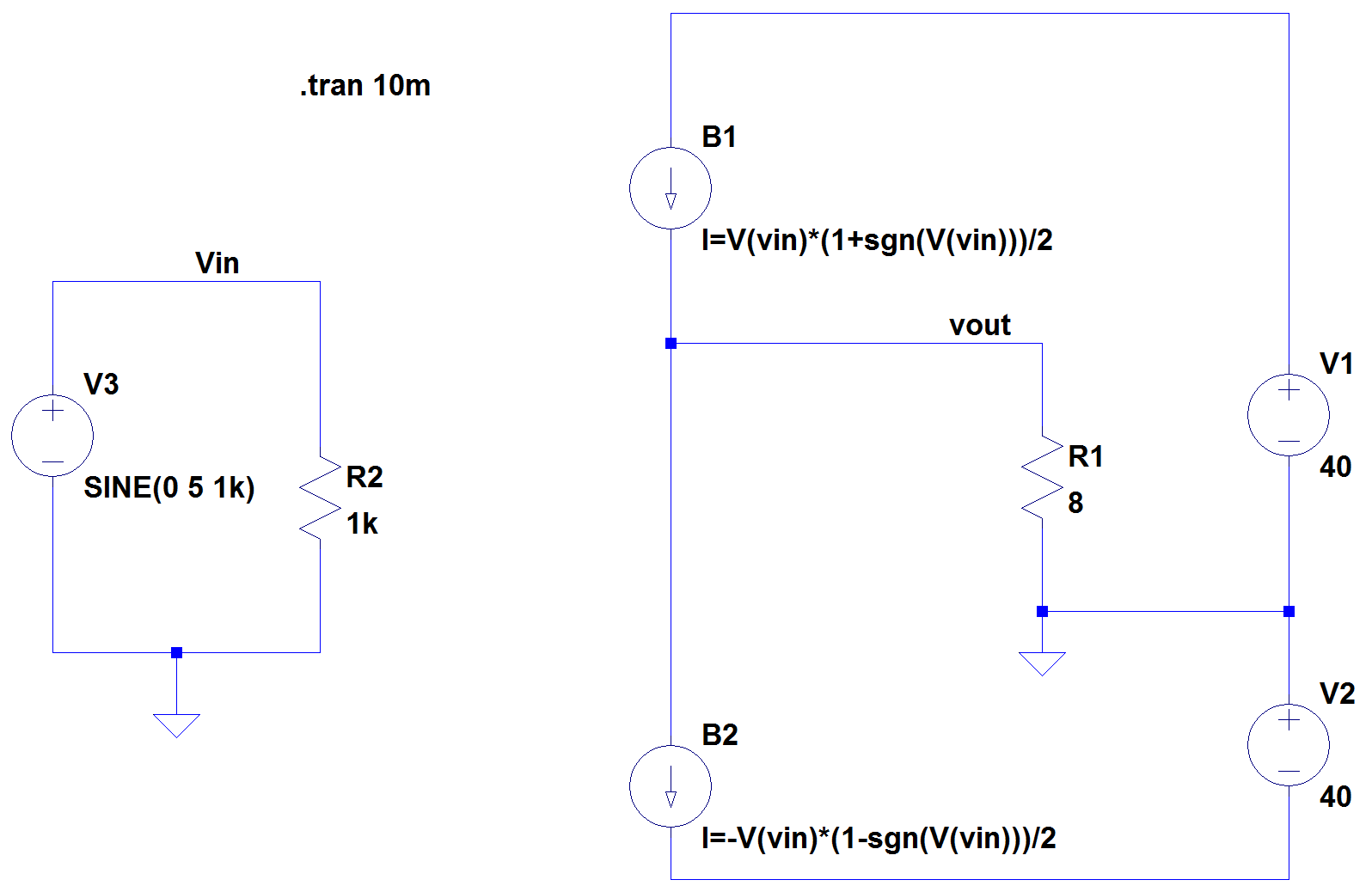

And a behavioral model approach
If you're really look to concentrate on the power supply, you can use a behavioral model of the power amp current drain. Note that the model becomes a bit unrealistic if you make Vin large enough so that max(Vin)*R1>V1, but otherwise, it is a reasonable representation of the load current taken by a class B amp.

Good! The post#5 circuit uses 4 components (V3, B1, B2, R1 ... R2 is not strictly necessary) while the post#4 circuit uses 5 components (Vin, V1, V2, Q1, Q2, LOAD).
If you inserted the sinusoidal stimulus directly into the B1 and B2 equations, you could get it down to 3 components. Maybe somebody will discover how to get it down to 2??

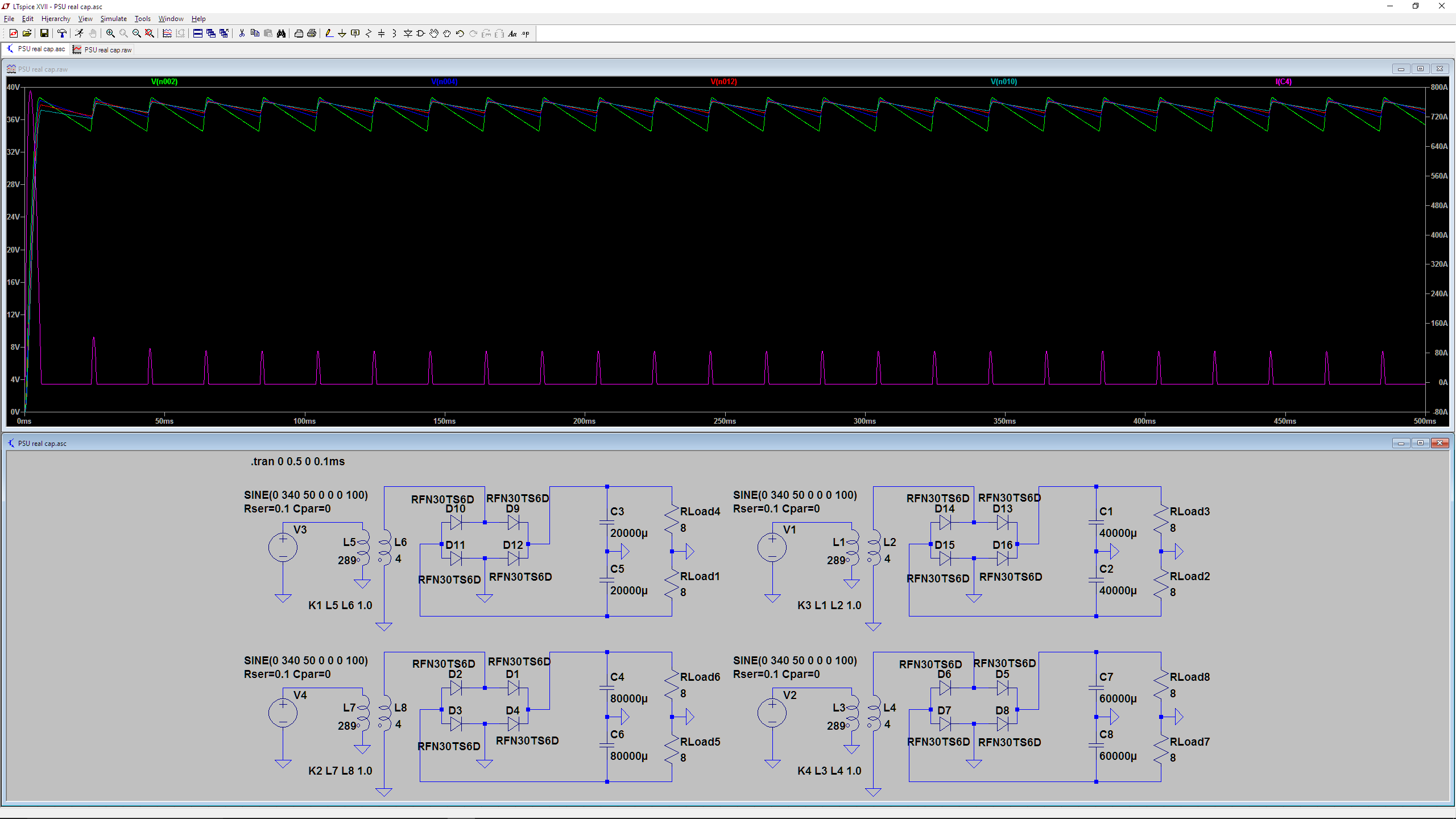

I think the attached works well - following Mark's suggestion. Now the challenge of finding caps with sufficient ripple rating. (Or perhaps in the example posted I need to shift the 0.47 ohm resistors one cap to the right.)

djoffe/Calvin, thanks for the suggestion regarding using a behavioural current source. I will study djoffe's example as I am unfamiliar with using this LTspice feature. (A simple current source did not work - see post 1.)

  • Amp PSU.zip
    Amp PSU.zip

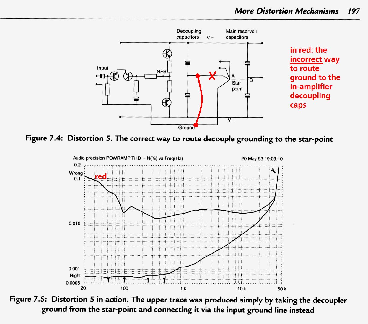

Mark, I read that to mean decoupling capacitors on the amp PCB itself (output stage) i.e. decouple to a "PWR_GND" and wire from amp PCB PWR_GND to star point. Also connect PSU PWR_GND to star point with separate wire. Signal GND kept separate from PWR_GND and wired separately to the star point.
The use of decoupling on the PSU itself was something I debated briefly with diyAudio member astx. I had feebly suggested that decoupling on the PSU did not help much. He argued you can never have too much decoupling (C5 and C6 in post 12) and that the 1uF caps were there to deliver peak current and short circuit HF ringing from outside the PSU. We also discussed the purpose of the Zobel something I had not seen in such PSUs before but have since. Are you suggesting any decoupling on the PSU should be separated yet again?
