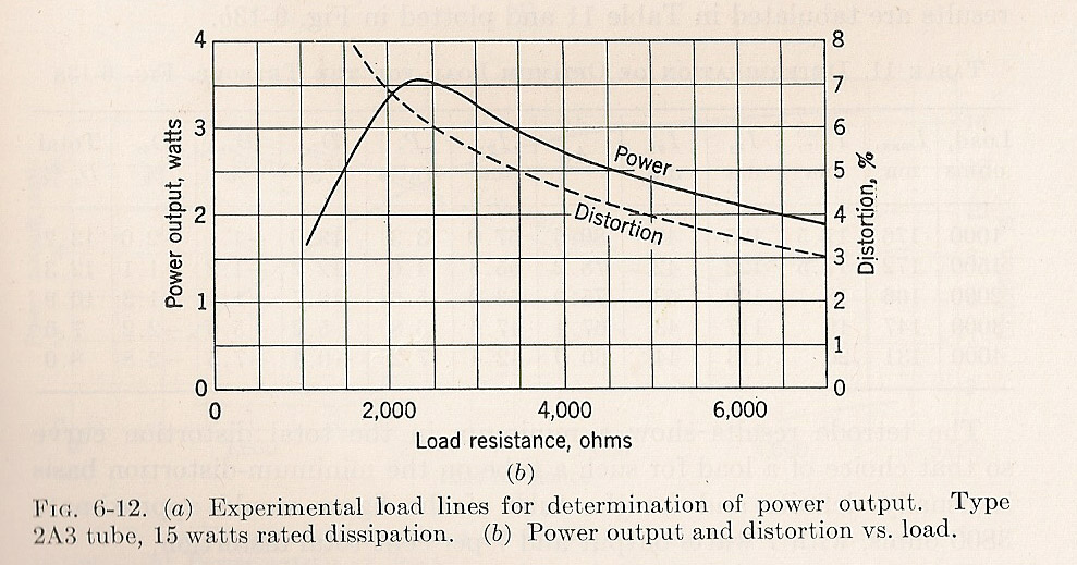

For a triode, theoretical max power occurs when the load equals 2rp. In practice it is more like 2.5rp. But at that loading D% is high. So good design at a load of 3-4 rp results are better. No need to do the unloaded OPT thing as long as the triode rp is known. Unless you are curious to try the test.😀 Worth trying for your own experience.

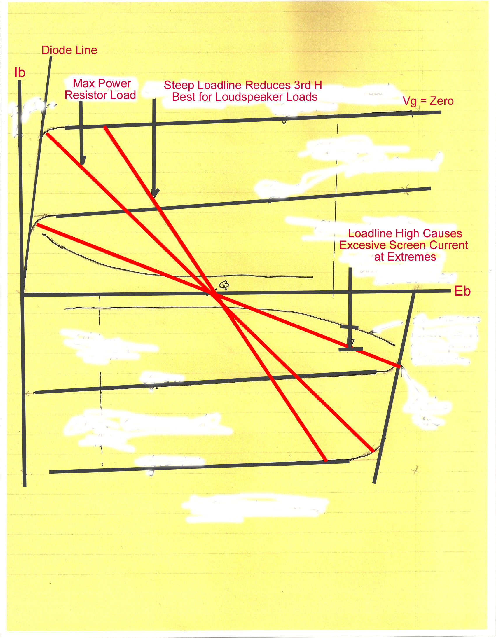

Load for max power in a pentode stage is a lot more critical. The objective is to get the loadline to run up into the knee of the plate characteristic curves. Any deviation from that & less power is available. A speaker load will reduce the power available simply because the loadline resulting from the reactive load is not a straight line. And at any moment it is a rather complicated ellipse.
I design a PP Pentode stage so that the load Rl is less than optimum. One reason is that speaker published impedance is a target. For example an 8R speaker measures more like 6.5R at the mid-band. But could be anything at 400 Hz & 10 KHz, usually higher. Another reason, a steeper loadine results in lower 3H harmonics.🙂
All I'm saying is that if you have the primary of the output transformer in parallel with a loading resistor, then AC current being produced by the finals will go through the OT and the loading resistor, and whatever current goes through the loading resistor isn't going to hit the voice coil.
If, for example, we decide to operate a 2A3 at the book operating point for a 2.5K load but we use a 5K output transformer and a 5K resistor, we will only get about half the power we otherwise would(assuming an ideal OT and resistive load). If the 5K transformer is allowed to run on its own, we get a little more power than with the resistor, more damping, and less THD.
For the pentode scenario I would wonder if you're throwing away enough power that you're back at triode strapped numbers in an effort to present more of a resistive load line.
