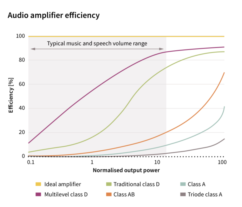

Uses the so-called Multilevel Class D topology for the highest power efficiency, greater than traditional Class D - whitepaper:
https://www.infineon.com/dgdl/Infin...N.pdf?fileId=5546d462696dbf120169b4f8f7524db9

Multi-level switching technology with 3-level and 5-level modulation
2×80W peak output power (26V PVDD, RL = 4Ω, 10% THD+N level)
Supply voltages: +4V to +26V (PVDD) and +5V (A/DVDD)
Suitable for 2.0, 2.1, 4.0, 1.0 output stage configurations
4th order feedback error control
<160mW Idle power dissipation (26V PVDD, all channels switching)
>80% efficiency at 2W power (1kHz sine, 8Ω)
>91% efficiency at full Power (1kHz sine, 8Ω)

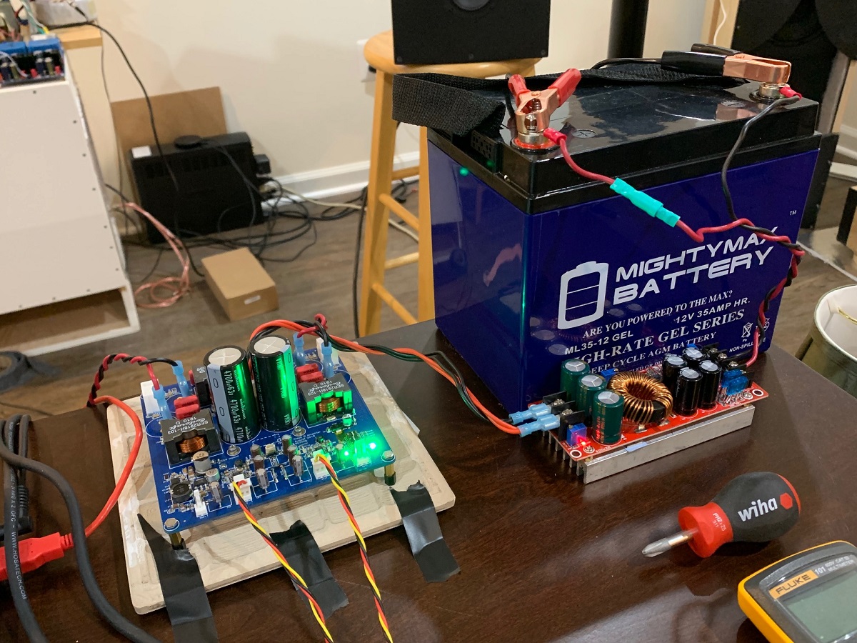

Imho, this chip is impressive for battery operated as it's a very efficient chip.
If looking for powerful chip and not battery operated ,I will stick with TPA3255

Depends on what battery, I can run 7hrs at 100wrms with a couple of big gel cells and DC-DC step up. Here is my 3255:
