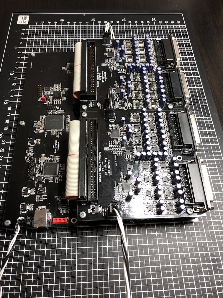

Hi Folks,
i'm currently soldering Infinitas and AnalogIo-x8.
Just wanted to ask if anyone here has already done this, or if anyone is interested to exchange experiences in this regard.
It's pretty demanding to handsolder 0.47pitch and 0402 caps...

Trouble Flashing the lattice
Rehi,
as noone requested any info on my experience buiding infintas, i left that alone.
Anyway, now I'm running into trouble flashing the lattice:
I built the ftdi-cable, intsalled diamond studio, checked vcc and gnd on the latice-chips pins, seems ok. when i measure voltage over the xtal-pins, i get two different ones... one siginificantly lower than 3.3, one unter 1V.
when i start the programming, i see the TX-led on the ftdi flicker and get some voltage on the pin on the lattice chip, after 2 flicker-sessions, diamod studio tells me there must be st. wrong with the cable.
i assume, i have to power the infinitas, and thus i have no connection in the 3.3V pins on the jtag-pins.
any hints? what can i do to debug some more? i have an ancent osc here, so i could check quite a lot...
thans for any help,
ralf

rehi,
in the meantime i could figure out that there is signal at the OSC-pin of the lattice-fpga, which disappears when i shot the ENA pin of the oscillator to GND, so that should work. (would expact a square, but get a pretty sine, but that migt stem from the 20MHz Bandwith of my old HAMEG...).
I checked continuity from the FTDI to the pins on the FPGA, no shorts either...
Still: Diamond studio does not connect to the FPGA.
Any Hints?
@raphael: in another thread you mentiioned a german forum. Do you have a pointer?
best,
Ralf

Sorry for the delay. Somehow I did not recognize you. Sorry.
Anway, can you post a screenshot of the configuration page for the programming cable in Lattice Diamond?
The oscillator has nothing to do with the JTAG configuration. Even without it you should be able to talk to the MachXO. The makes me thinking that there might be a wrong configuration or a driver issue.
Raphael

Hi Raphael
I am currently building the infinitas board, and one of the last components missing is IC202 (NCP4681DSQ25T1G). I can't find this part (farnell, mouser, digikey) or any compatible one (the NCP seems to use an exotic pinout configuration)
Because I already have soldered most of the parts, it is not feasible to change the board layout for me.
Any suggestions (where I can find the part, or do you know of any compatible ones)?
Regards
Godfried

How about this one:
https://fi.farnell.com/on-semiconductor/ncp4620hsq25t1g/ldo-volt-reg-0-15a-2-5v-sc70-5/dp/2464263
NCP502 and NCP 512 and many other seem to use the most common pinout (1=input, 2=GND, 3=EN, 4=PB/N.C, 5=output). Maybe next rev. boards should be changed to use that one, too?

Thanks. This one is not available at farnell Belgium (doesn't even find the order code). Apparently, it is available in the UK. I'll see if I can order there.
