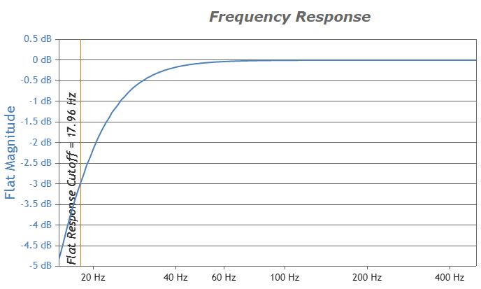

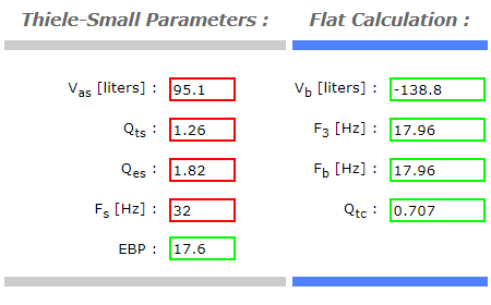

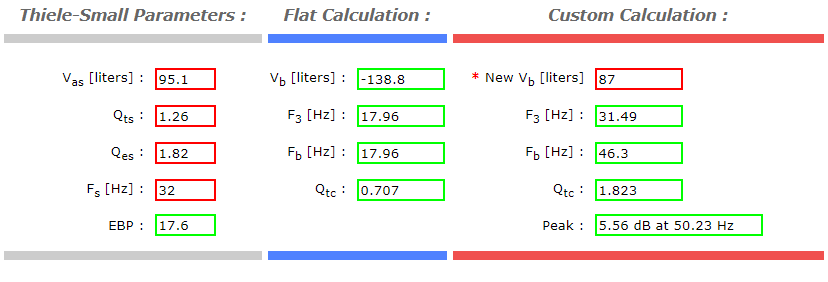

Ok, I have used online calculator to simulate my woofers in a closed box. The pictures are shown here.
First calculator, I entered all parametres in it and it showed incredibly result when it said that the box volume suggested would be -138.8 litres! with Q = 0.707 claimed its a flat response calculating.

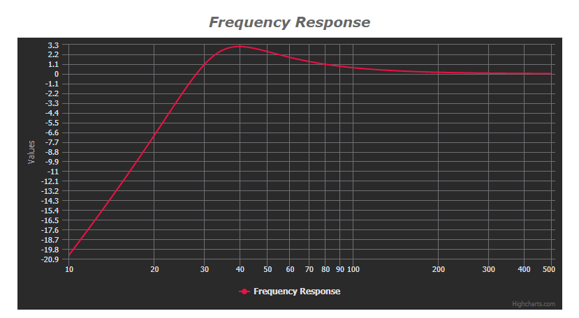

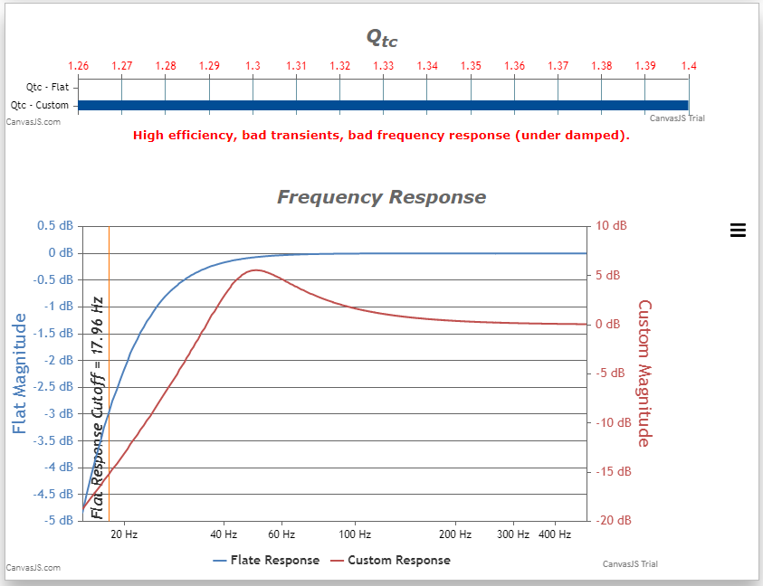

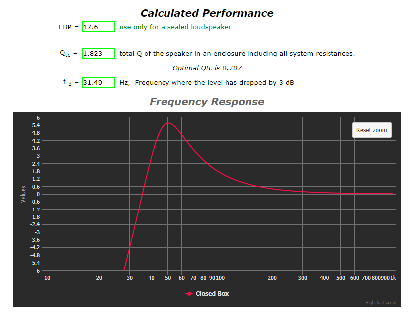

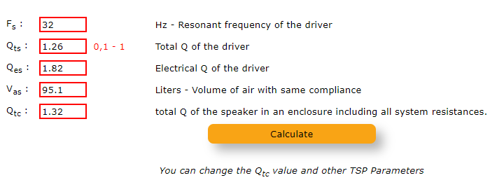

Second calculator, I entered the parametres again but now I selected my own Q. I chose Q = 0.707 as suggested by the first calculator. Yet, I couldn't obtain the result as it automatically changed the Q to 1.32!, I guess it's a recommended value, and couldn't be lower than this, only higher is allowed.
It surprises me again as it suggested that the recommended box volume is 975.33 litres!, remember that this is with Q = 1.32!.

Right, the lowest possible Qtc = Qts and results in an infinite box size [Vb], hence the negative calculation. Factor in some wiring losses and Qts rises a bit more to Qts' = [Qts']: [Qts] + any added series resistance [Rs]: Calculate new Qts with Series Resistor
[Rs] = 0.5 ohm minimum for wiring, so may be higher if a super small gauge is used as a series resistor plus any added resistance from an XO/whatever.
That said, if you had the budget for a fairly large cab, a well stuffed TL tuned to ~21 Hz will damp it flat across it's entire usable BW, so one tuned to [Fs] would tune it mostly flat, but still a bit big, but if you make your 3 ft^3 sealed cab a tall offset driver column 1/2 the TL's length and stuff it like the TL you'll get most of the benefits of both with the main difference being it won't have the TL's mid-band gain, which according to HR isn't that much unless it's really large like its specs dictate for optimal LF gain BW.
