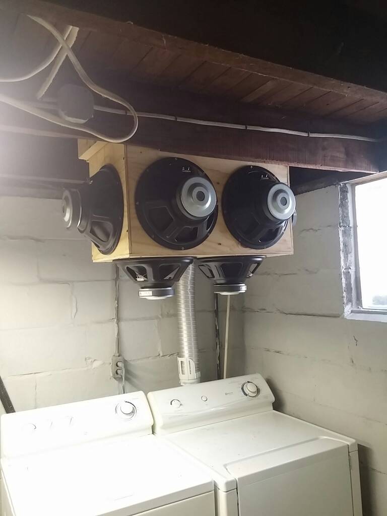

SIM 6 of these bad boys in winisd pro. You can see my manifold below. These drivers are the GRS 12sw-4 on PE. They are a gem and only $20 each. I can't believe more people don't use these!
