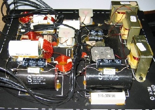

It seems a fairly serious attempt already at crossover quality.
The bipolar electrolytics should be replaced if > 20 years old.
They are all bypassed, replacement seems the best option.

In my experience (and others) with quality speakers changing
bipolar electrolytics to other types can unbalance the speaker
if the electrolytic is in a critical position, if it is not, why bother ?
As they are old the electrolytics should be replaced, the other
capacitors should be fine. If upgrading the network is wanted
the position and purpose of each capacitor should be found,
and then possibly "upgraded" accordingly.
Usually more attention is made to series rather than parallel
capacitors, e.g. take a parallel zobel network, try and work
out how a higher quality capacitor would improve matters .....
🙂/sreten.

Thanks for the input everyone. By good bang for the buck I mean maximum return for each dollar invested. Like most things in life you reach a point of diminishing returns, and you end up paying a lot more for just a little more gain. I figure my weakest link right now is probably my cd player, an Arcam CD73T. Although a decent sounding unit for it's price, I would not consider it a high end unit. Other equipment includes a Threshold FET10 preamp, Threshold S/500e to power the bass towers, and a fairly modified Hafler DH200 (as per Pooge article mod from the 80s) with WonderCaps/Bypass caps, metal film resistors, large outboard power supply with torroidal transformers, large PS caps etc. I wouldn't mind upgrading the caps in the Hafler as well, one of the reasons I was asking about Sonic caps or whatever brand might be of benefit and cost effective. I have heard a little bit about special diodes and rectifiers for amplifier applications, but it would be nice to hear from someone who has actually had hands on experience with them. I am currently using Audioquest Midnight speaker wire on all towers, and custom made interconnects based on RG174/U cable. I haven't even opened up the bass servo box yet, but I imagine it has components similar to the speaker crossovers. It looks like winter has set in here, so its a good time for some nice indoor projects. 🙂

My Beta schematic is exactly the same as that listed on the following excellent site, just add the www

As I was suspected,
The Low enim have 2 NP caps in series and iron core in series also 🙁
Imho the schematic have something of wrong. 600 microF MKP in series to the ENIM is not possible. Check your value please and report us.

You are correct, the diagram does not show the proper values for the min midrange caps. The one listed as a Solen 500 ufd cap appears to be a 50 ufd cap according to the silkscreen on the backboard. The cap itself is securely glued in place and the specs are not visible but it is at least 1/3 to 1/2 smaller than the 100 ufd Solens so that should be accurate. The one listed as a WonderCap 100 ufd cap in parallel is actually a 10 ufd cap, and the markings are plainly visible. There are only 4 NP caps per speaker, a 20, 35, 150 and 300 ufd cap, the only markings visible on these show T.I. Any recommendations for good replacements for these? Consensus appears to be that the Solen caps are decent, can the same be said for the WonderCaps or are they also worth hanging on to? I don't mind replacing the caps if it will make a noticeable difference. The same applies to the caps in my mid/high amp.

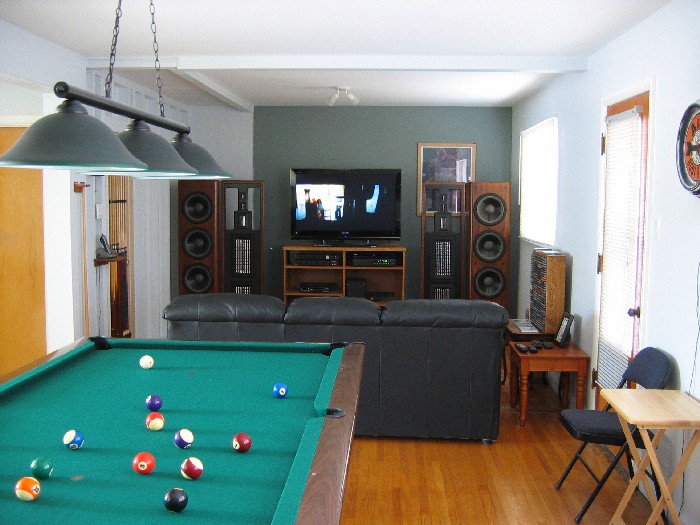

Here is my current layout, sure wish I had more room width. There really isn't enough room to do the speakers justice, but it is all I have to work with right now. My goal was to set up a decent sound system, but have it so that others besides myself could enjoy it too. I ended up tearing down 3 walls to make enough room for the table, and installed an engineered 480 lb beam to replace the main support wall. I also tore out a bedroom and my last 2 built in closets to give the audio equipment more space as well. It is still a work in progress with a long way to go, as time and funds permit. All work has been performed by myself so far, other than assistance with the painting. None of my pool playing friends have complained about the sound quality yet 🙂 Thanks everyone for your helpful input.

Imo Solen are ok, wondercap are hiend-caps, but I must insist: those 4 NP are "junk", swap with at least Bennic MKT, they are special offer at
www.solen.ca . ( the two biggers are in series on the LEMIM
; the 2 little are so little you can sure afford the little cost ).
One of the most venerable Hi-end speaker system of 20 years ago( in italy they costed a lot of money) sure deserve this little upgrade!
