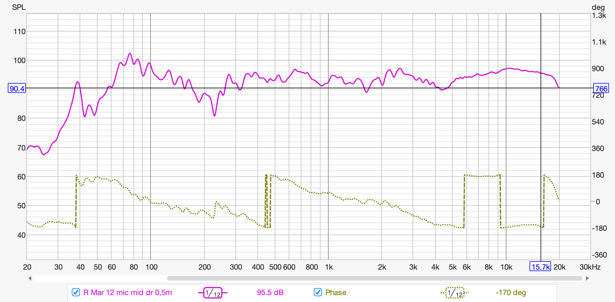

I did REW measurements and got following results. Mic is calibrated SoundID reference. Mic placement was 0,5 meters away from speaker and positioned to the midrange level.

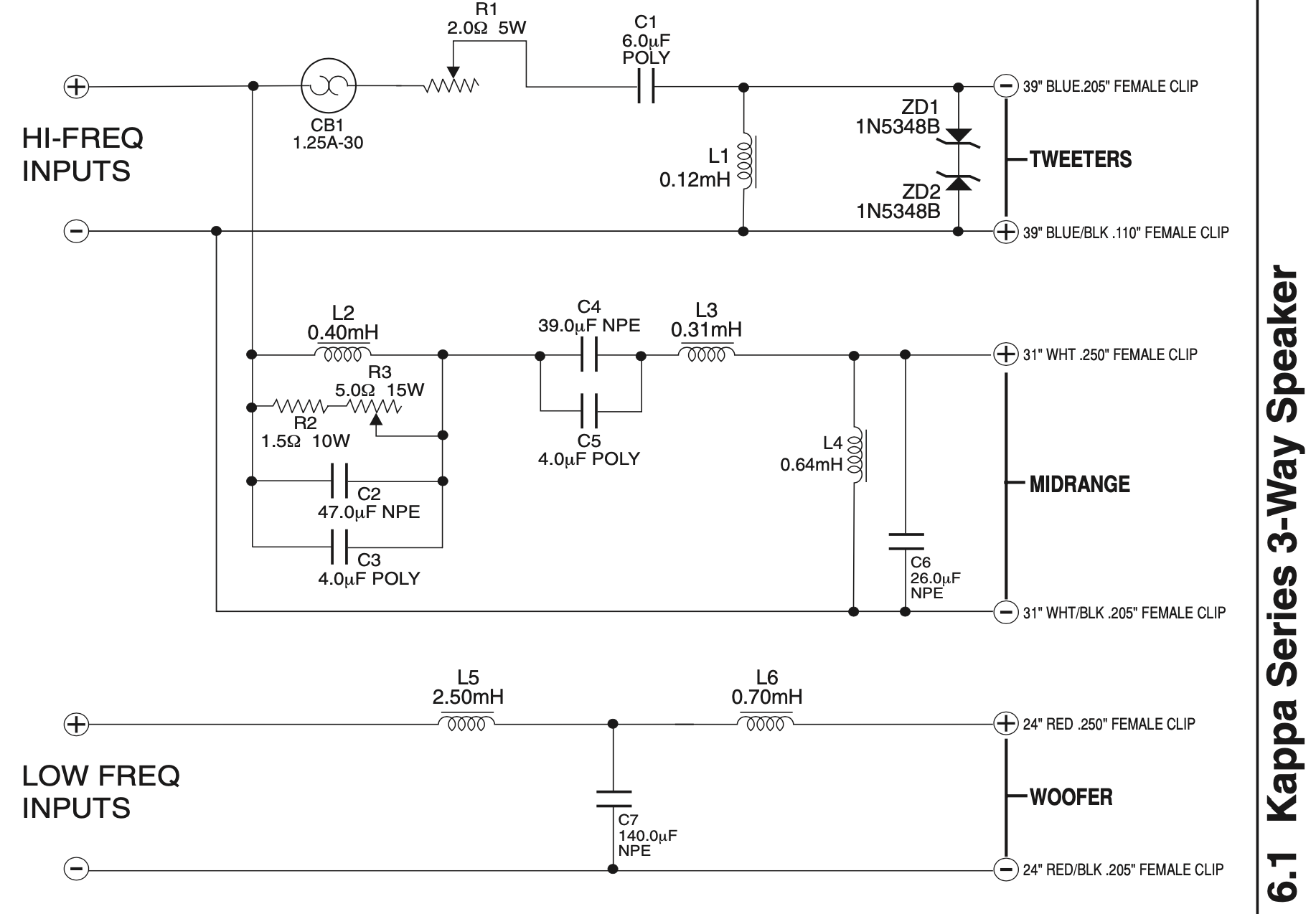

I will insert crossover schematic that I found from internet. If you are looking my rew measurements and this crossover schematic then what crossover changes would be good to try out for better frequency range? Kappa crossover frequencies: 500hz and 4,5kz.
DMM shows for the woofer driver 3,6 ohms. Do you have some reasonable woofer driver in mind to fit here?
Even if the frequency response doesn't look too bad, this has not much to do with reality. At 0.5 meters in a room you don't measure anything usefull. Change distance of mike position and you will see something completely different.
In room you need gated near field measurments for every driver to get something to work with.
Choosing another bass driver will need calibrated SPL and TSP measuring of the actual driver.
Better keep it for now and look for other options, like damping and, maybe, a closed or longer vent.
The x-over looks like someone knew his job, but maybe had a bad taste in music...
