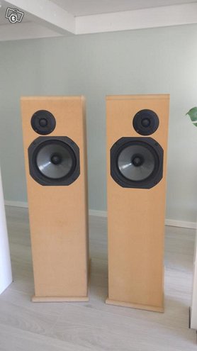

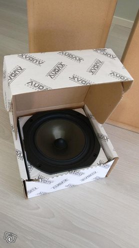

Hi. I'am thinking of buying these KLS9 speakers from a local seller for 150e and they come with 2 new spare audax elements. I ve seen those elements alone go for like 100e a piece. I really like the look of those but no idea how they sound. How do they compare to my KEF 104aB and wharfedale 225's. And are they worth buying? Thx

I think it could be safe to say different. Not bad but different. Which is of no real help.
Can you have a listen to them in your own home?
Failing that and if you don't like them you should not loose anything or maybe make a profit.
Nice cabinets and good drivers!
But USELESS crossover... like the old SEAS Njord.

I'd pass that one up. Won't be better than your KEF 104ab.
I remember this design from the original magazine. I still have the paper supplements from most of them.
If these are 'your type of speakers' then buy them and tweak the xo if it really is that bad.
The mid driver looks to have a very benign top end roll off which would seem to work well with a 1st order slope. Don't know much about the tweeter but they add a 1st order to its natural 2nd order slope to give an acoustical 3rd order slope at 3kHz.
If the spare drivers are worth 100 each buy the lot and sell the spare drivers and you'll be in profit and have new speakers to play with.
