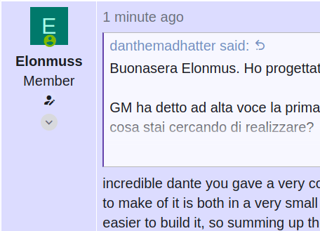

incredible dante you gave a very complete answer ache do not know the formulas well but in math I am fine. however ip I would like to reach 10 hz, furthermore the use I would like to make of it is both in a very small room (10m ^ 2) and outdoors, but the most important thing is that the infrasound generator can be very close to me about 1 meter away, so it is easier to build it, so summing up the generator (pipe or speaker) must not be far from me, but close to 1 meter away, unfortunately the construction of the speakers with subwoofers is inconvenient for me also because I would like it to be a minimum transportable, and therefore I believe that the tube is the best choice. so knowing my needs and that the generator must be 1 meter away from me, which choice is the best? i am more for the tube
