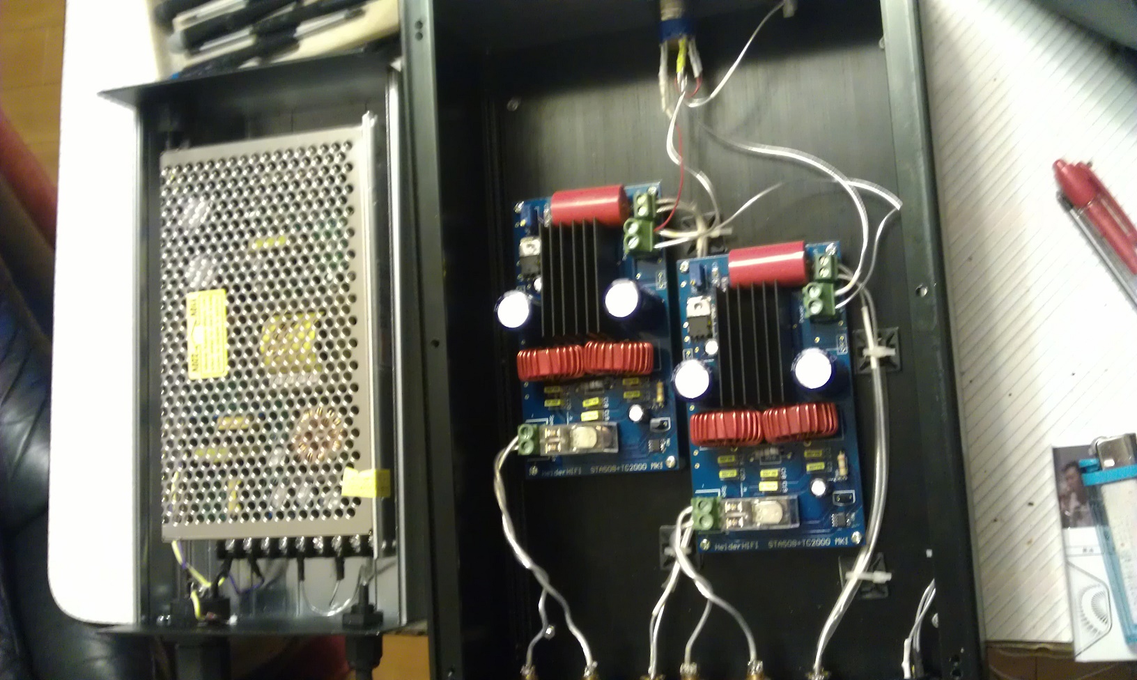

Ok so what am I looking for in the power amp circuit to check the bias?
I built the preamp, but not the power amp so I don't have a schematic. Does this pic help at all?
There appears to be some confusion here. The 1 meg is only for the output cap of the power amp. The power amp most likely will have a 22K resistor at it's input . So the 1 meg and 22k will come in parallel with each other. That will result in a load of 21.5K to the preamp.

No confusion. I agree that there probably is a 22k resistor providing bias, but we don't know without seeing the circuit diagram. Hence I saidashok said:There appears to be some confusion here. The 1 meg is only for the output cap of the power amp. The power amp most likely will have a 22K resistor at it's input .
DF96 said:It depends on the input bias details.
Personally, I would leave things exactly as they are.
It's good to know what we're dealing with......it's a tube preamp so I am not keen on having 150vdc in the rca cables betweeen the preamp and the power amp....
I still wouldn't remove that input cap unless it's an absolute certainty the 2 units won't be separated or you bolt them together, because modifying the input in an attempt to match it to an oddball preamp means it will likely need to revert to the original design to work with say, a commercial solid state preamp. As far as I know, up-market preamps may have line outputs specified as low as 200R.
As DF96 may be advocating, if this valve preamp is more or less "standard" in it's output parameters, then you don't need to do anything, despite the opinions we read about 2 caps being so much worse than 1, superfluous etc.
