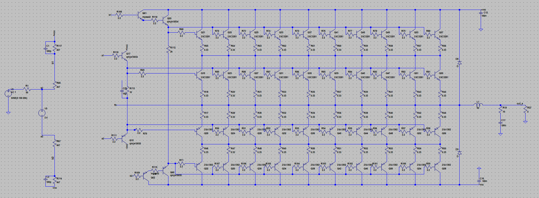

The story is as follows: I managed to get an excellent deal on two used 1600va 2x115V secondary toroidal transformers and right now I'm contemplating building a very large amplifier around these two.
Unfortunately there are no additional secondary taps available and thus the amplifier will have to be class B with no sliding rails.
There are complementary 350V bipolar transistors available from On-Semi, but the problem with these is that they're almost useless at these voltages due to SOAR limitations. I thought the next best thing would be to connect the output transistors in series just like in the "low-end zesilovac 1kW" from Alan Kraus. Czech magazine "amatorske radio" published this design back in 2000. I don't think it is worth the effort to build this design as both input stage and VAS are very simple and I assume that the performance won't be very good. In any case, I have a pdf available if anyone is interested.
I did like the output stage however and I tried designing something similar using more modern plastic-cased transistors. However the problem with this type of design is that I cannot get it running stable. I've run many simulations over the past weeks and I think the instability issues can be really narrowed down to the output stage itself.
I've attached a stripped-down schematic which shows just the output stage with 'ideal' VAS and bias generator. The circuit appears to be very sensitive to changes in R1 and there is significant gain above 1MHz or so. This could explain why even minor changes in the VAS stage make a mess of everything.
I've read critical comments about power cascades or totem pole arrangement output stages and I'm not so sure what to do with this information. I haven't seen this kind of arrangement anywhere except with the Alan Kraus design and the Leach Superamp and those two were using older and slower power transistors.
Right now I'm not sure if a complementary bipolar power stage is possible for such high supply voltages. I would appreciate any input or perhaps schematics for similar designs.

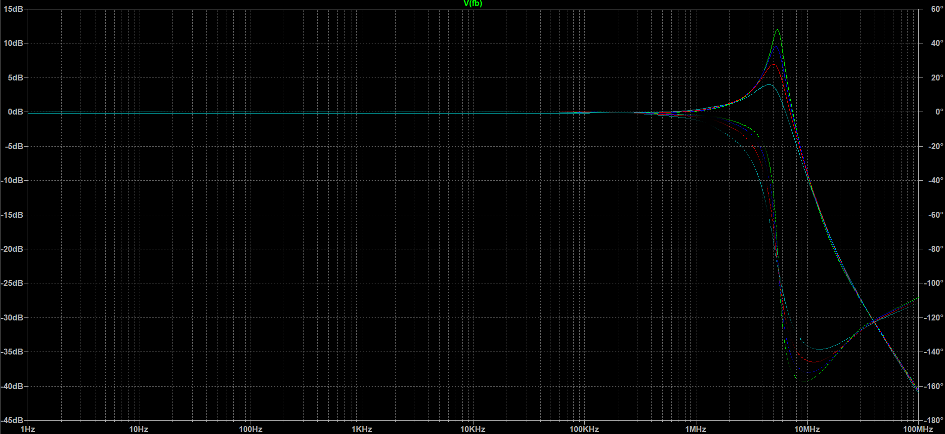

I have found two areas that can cause instability in these kind of amps.
1/ The VAS stage capacitor needs to be just right. Usually 100pf
2/ The resistor between driver and output transistors needs to be right too. I put 10R in series with each output transistor base.

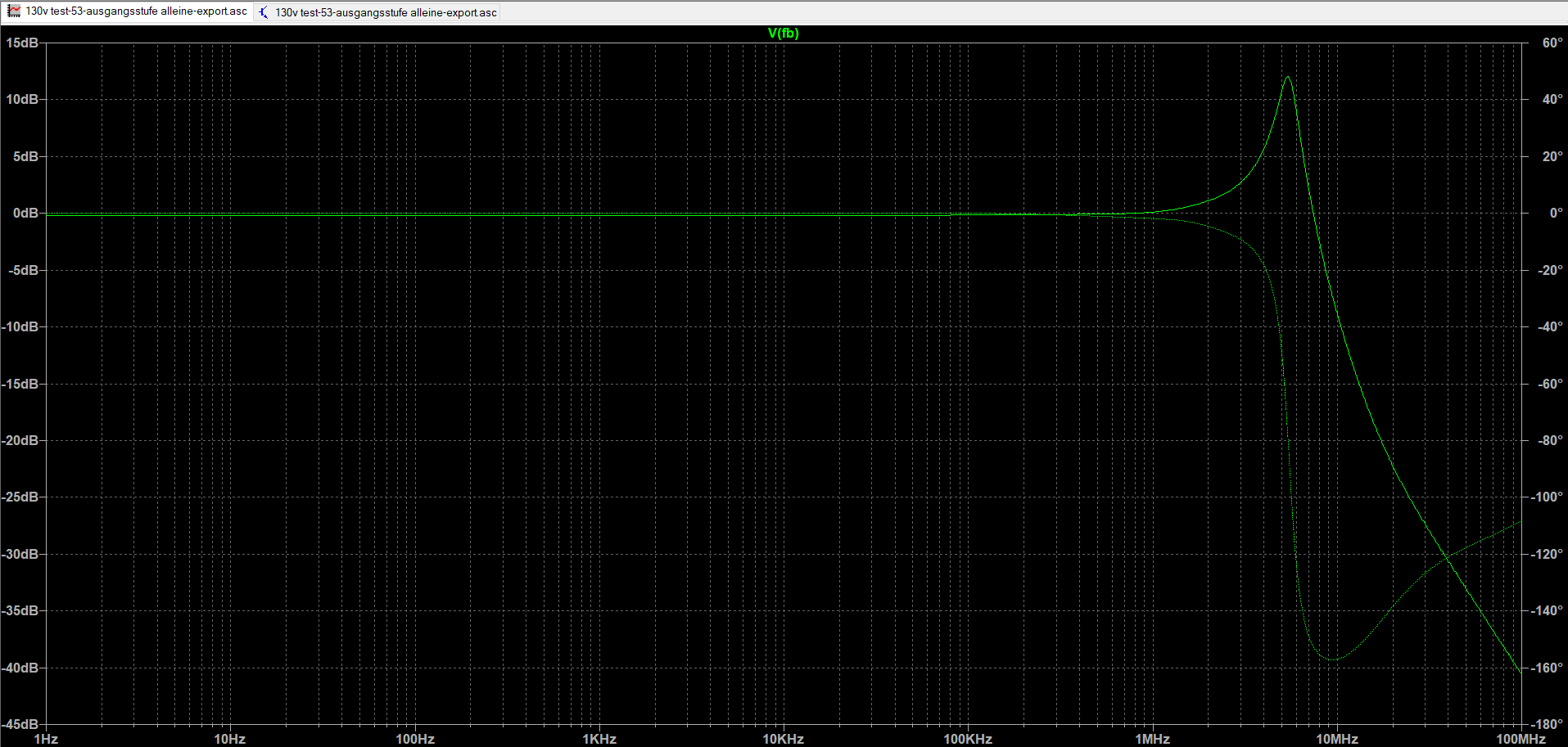

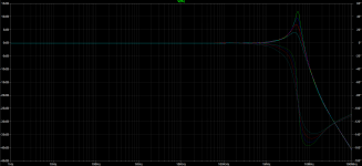

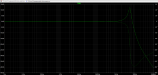

You do have a point there. Stepping the output transistor base resistors does make a significant difference here. Didn't expect the difference to be that large to be honest.
One more consideration, if I may - with such a big number of the output pairs (10 pairs in each "barrel"), considering the sum of the base currents and total capacitance - I would either use something like njw0281/0302 (or even 3281/1302) for the drivers, or split the output pairs into two groups, 5 pairs each, having the separate drivers for each group.
This may also increase the "speed" of the OPS, positively influencing the overall stability.

Something is off with the biasing.... getting a lot of DC on the output.
Try using two 1.2V sources in series instead of the 2.4V, and connect your signal to the center of them.
The signal source acts like a DC short and is keeping the top of the 2.4V source near ground potential.

If changing the base resistor *radically* changes the frequency response (as it seems to do), then the amp is VERY load-sensitive and will probably go crazy on a real loudspeaker load.

Even if you manage to get simulations stable, the real thing will be difficult to stabilize. Parasitic capacitances and inductance which do not show up in your model start to get significant when you parallel that many devices. Don't try to get a crazy amount of open loop gain. Use local feedback in each stage like Leach did, then the overall loop has a chance of being stable. Local instabilities in the OPS will have to be dealt with separately. I only built a 5 pair per barrel and found that base stoppers on everything and zobels for the upper banks were necessary. As well as tinkering with the values of the base to base resistors on the outputs and drivers. Any capacitance to ground at the node between master and slave banks creates a parasitic colpitts oscillator (negative R at the base). You have to de-Q it. Output stages are much more unstable at high vce, regardless of whether stacked on not. When testing on a dim bulb or variac it may be perfectly stable, but fly when given full voltage. If you could do class H it would mitigate that - because vce is never crazy high if the transistor is conducting. Would it be possible to add a pair of 55-0-55 secondaries at half the VA rating? If the window is large enough you can get more copper in. Another possibility is to use the Yamaha EEEngine output stage. It has sliding rails but doesn't require extra taps because it is switch mode (and relatively simple with no critical dead time requirements). Of course you could just buy a 1000 va 55-0-55 and use it with the 115 (two different transformers). Then you could build a pair of amps which would be easier to design/build. You could clone the amp circuit of the Crest Pro 9200 which is proven and runs off +/- 80 and 160.

... I've run many simulations over the past weeks and I think the instability issues can be really narrowed down to the output...
Dennis Feucht has written a classic analysis of Emitter Follower stability, well worth the effort to find on the 'net.
Make each transistor ideal, infinite Ft, zero capacitance and see which is the problem as you systematically move towards reality.
You have Q61 and Q62 for the "outside" half but no equivalent on the "inside", is that deliberate?

Well, sort of. One of the earlier iterations of this circuit had the voltage dividers connected to the output and these transistors seemed necessary for clean output wave forms with large voltage swings.
