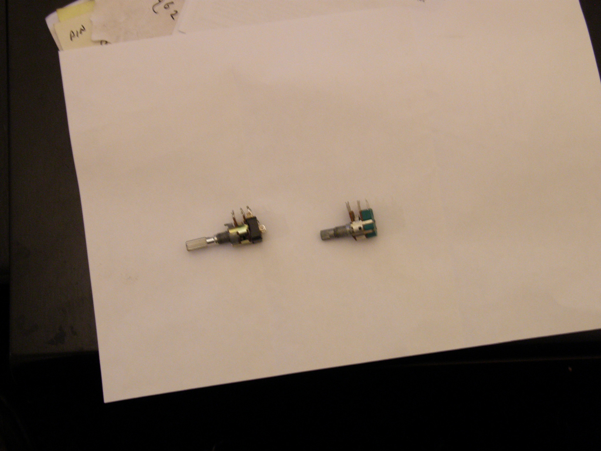

I have a Canterbury phonograph with mw/fw radio ,cassette,&3 disc cd player which the on/off volume control switch has stopped working ,my problem is I can not find the potentionmeter on/off switch. the radio cd init sits inside wooden cabinet I have taken the unit out and un soldered the on /off switch off the pcb board ,but there is nothing to tell me what switch it is ,I have looked on net for something that looks similar ,I bought 1 but it now turns on and off but no volume any advice

no the switch does both on and off and volume the old 1would turn on and soon as you turned the switch any further it would stop working the new 1 which is not identical turns on and stays on when you turn the switch but there is no sound .I do not know how to attach a picture of the switch

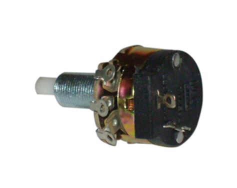

This is the kind of thing I always think of for a volume control plus switch. This is just a normal pot (single gang here) with the switch on the back. Very common years ago on TV's and radios.

guy in maplins said old 1 has 2 eath bits on bottom which green 1 does not have and yyou need to know the size of ,power of it
Well that looks the right sort of part you have. If it switches on and off OK then you have wired the switch correctly.
No sound... it can only be either something you have inadvertently done or something strange with the pot. Is it the correct value, although anything even remotely in the ballpark will work. Is the print OK to the pot (if its PCB mounted) ? The pot is simple in operation, one end will be grounded, the other end will have the audio input applied and the centre pin is the variable output.
the value thing guy at maplins mentioned something about that saying the green 1 had value on it B50k but old 1 only has B503 on it ? maybe have not soldered the joints well enough
