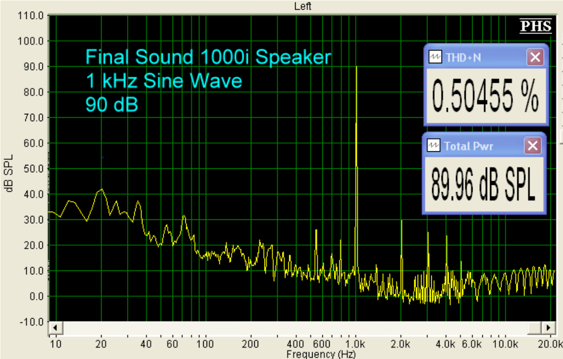

This is from a review of the 1000i which uses the inverting configuration: https://hometheaterhifi.com/volume_14_3/final-sound-1000i-speakers-8-2007-part-4.html
If I read this correctly, this was 90 dB at 12 in from the membrane, so more like 80-84 dB / 1 m, depending on the radiation pattern. The second harmonic is exactly 60 dB down from the fundamental at 1 kHz (0.1% of HD2 - the 0.5% THD+N is probably owed to the LF noise in the measurement). This is lower than what good cone drivers can achieve, even if not at the > -70 dB level of the ESL 63 and its successors.

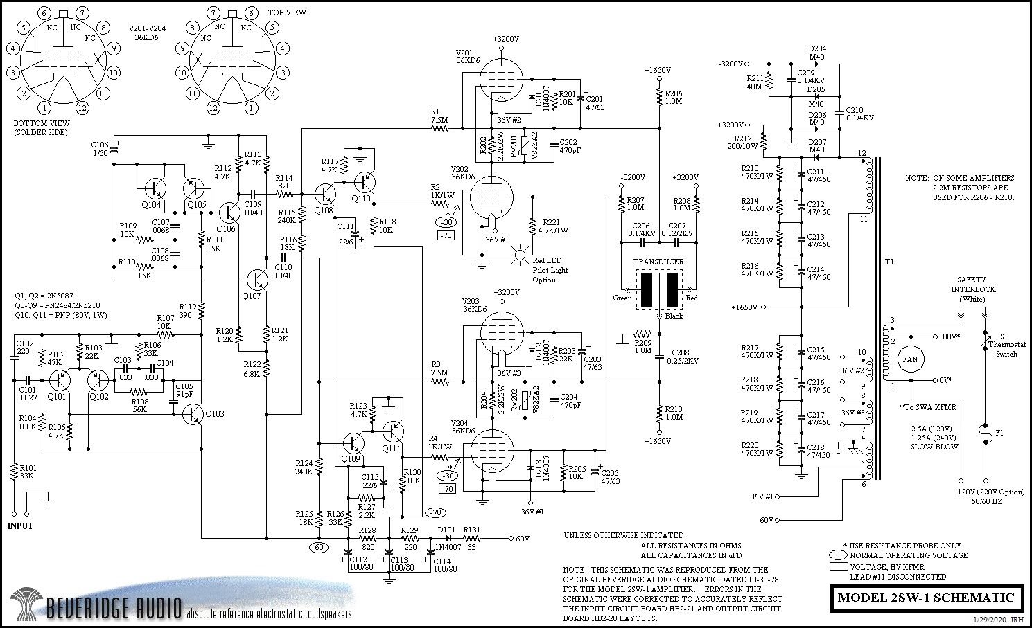

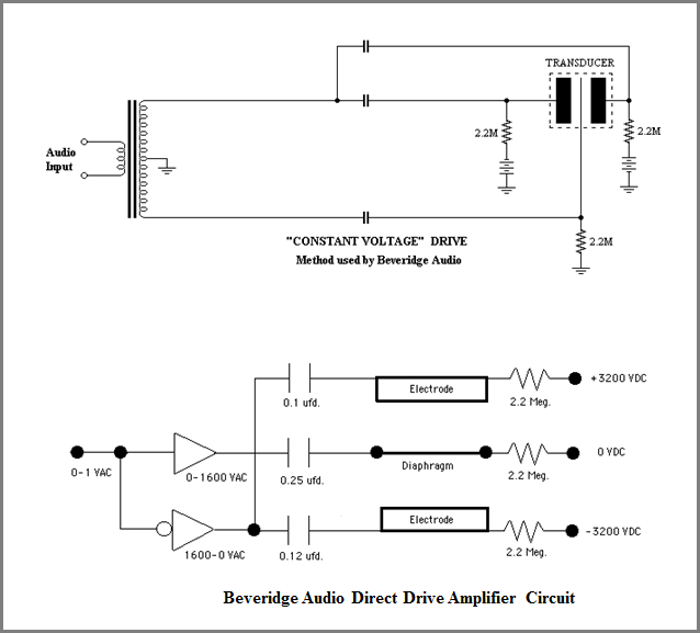

What are your thoughts about the Beveridge inverted drive method posted elsewere on this forum, where stators are also part of the drive system ?
The 2SW's are one off the best sounding electrostats i ever heard on high volumes, and use very low resistance diafram.
Of Course completely different animals, but still.

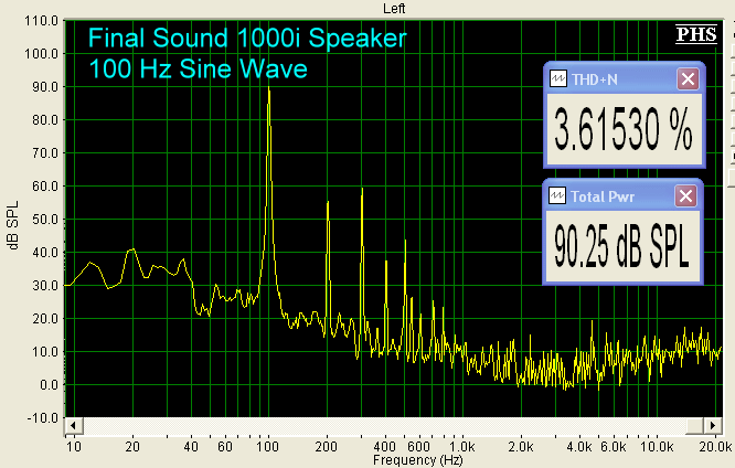

There are two closely related distortion mechanisms in the inverted ESL. Both are described well in Baxandall's paper.
One relates to the changing capacitance of the system with the displacement of the membrane from the central position, hence also there is a change in charge on the membrane when driven at constant bias voltage (voltage = charge/capacitance) hence change in the forces on the membrane. In the usual ESL, this problem is solved with a high-value series resistor between the HV source and the membrane preventing the change in charge on the membrane. This option is not available to the inverted ESL.
The other relates to charge migration on the membrane itself - if the membrane is not perfectly flat when displaced from the central position, charge migrates to the place on the membrane closest to a stator. In the usual ESL, the problem is solved by using the high resistivity membrane.
This distortion can be quite high, and almost entirely second order, so not especially irritating. I recall seeing a review of a Final Sound ESL exhibiting 8% distortion at high volumes (sorry, I didn't keep a copy), but I imagine it would still sound pretty good.
