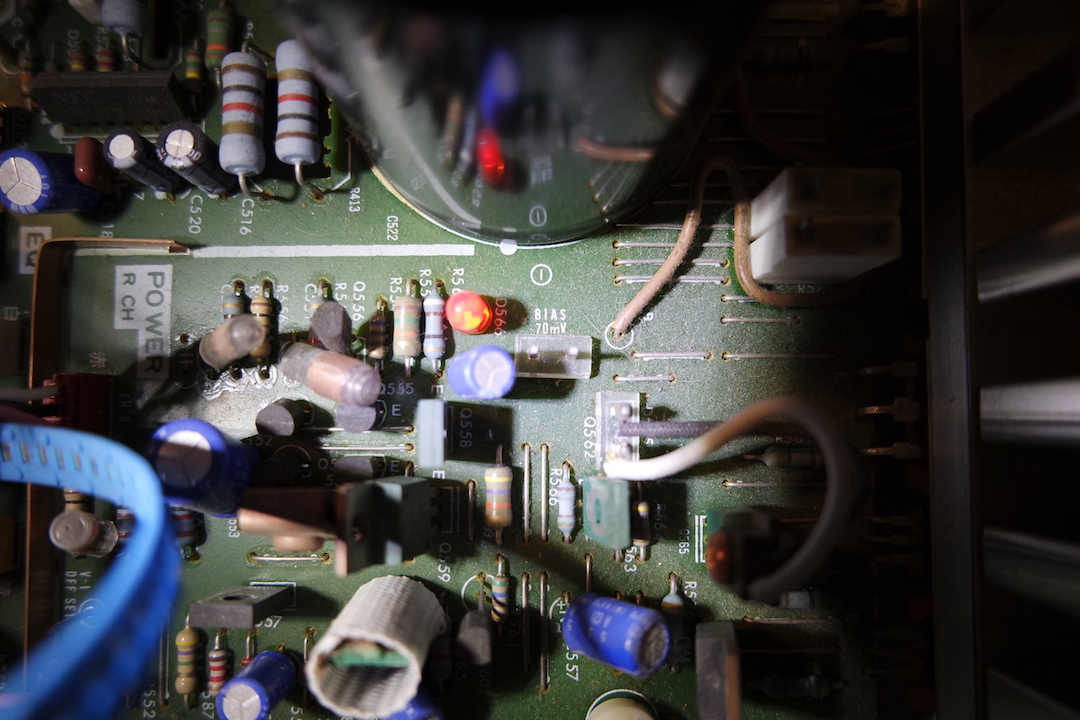

I picked up a Sony TA-F444ESII integrated amp yesterday, and after checking for DC offset (good at 5mv and 0.2mv), listened to it through a pair of BA A60s. Sounded good except for some scratchiness/weakness on the left channel, which kept improving as I exercised the balance knob.
This morning I opened it up and cleaned the pots. I also wanted to check and adjust the bias. The bias pots were well labeled on the main board, as were the bias test points, as shown in the photo. The TP are well labeled as 70mv, which struck me as quite high. I measured across the TP, and presently there is only 3-4mv of bias. The amp does run fairly cool at this setting.
Not having a complete service manual for the TA-F444ESII (I have the circuit diagrams but no layout diagrams or the section on setting bias), I'd appreciate it if anyone can confirm and/or comment on the 70mv bias setting

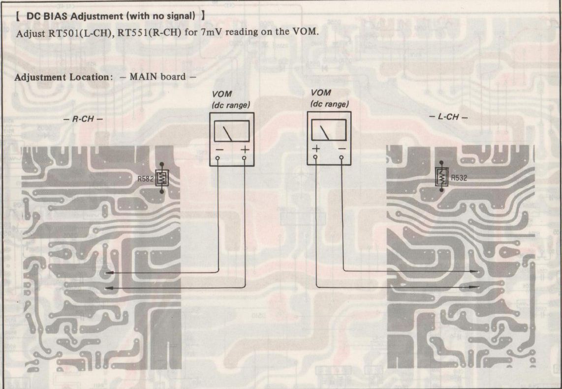

I could find service manuals for TA-F444ES, and the ESX model, but both are quite different from the TA-F444ESII (e.g., there are only 2 large PS caps on the TA-F444ESII, not 4, and oddly, there appears to be no provision for DC offset adjustments on the TA-F444ESII). For supposedly similar models such as TA-F333ES and the higher-powered TA-F555ESII, the service manuals specify bias at much lower levels (7.5mv, 15mv, and 35mv). That is why the 70mv bias struck me as unusually high.

Thanks so much, John, for the info and the scan. Greatly appreciated. 7mv makes a lot more sense.

As it happens, I'm also working on a TA-F444ES II at the moment, and can confirm the 7mV is correct - I've obviously got the same hardcopy manual.

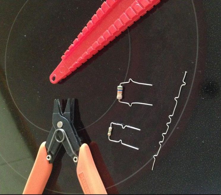

What I do is space them off the board about 5-10mm so if they attempt to fuse, they won't char the board.

I use this Xuron 573 to give any heat producing resistors an opportunity to 'breathe' by spacing them consistently and securely above the PCB:

For Sony - and all other manufacturers really -a 'critical' resistor is one whose specs must stay the same as in the schematic. Mostly this has to do with size. This is because in 99.99% of other cases, you can replace a resistor with one of 'the next size up' without a problem, or a carbon one with metal film (or the other way around), etc. Not so for positions where fusibles were used unless you want to risk other damage.(2) As Goldie alluded to, Sony seems to believe there are safety considerations that dictate the use of fusibles in those particular circuits. I take this to mean that if a standard resistor is used, the damage created elsewhere could create a dangerous situation such as a fire, as you alluded to.
That being said, if you looked at other service manuals, before or after the time fusibles were widely used, you will find all the same resistor positions (amp circuits are not that different, in some cases carried over 99& or even cut down in newer devices!) just with regular resistors. They will still be specced as critical, and it will usually be the size that matters. In the olden days, they would sometimes use a regular carbon resistor just enclose it in a small glass weave tube so it could not flame out. Today they use small metal film ones. Many ways to skin a cat, and the cat has been around a long long time.
So I'm not sure if you are advocating the use a standard resistor instead of a fusible (but what other alternative would I have if a fusible is not to be used?), or if you simply wished to point out the pitfalls of designs based on fusibles, which you have done very well.
Both, really. If you can find fusible replacements for a reasonable price, modern ones will surely be better than old ones. However, they will always be more expensive than regular resistors. And - the latter is what the industry now uses in those places 99.9% of the time. Again, if it was me, I would not even bother with fusibles unless they were really, really, really needed (have not yet found such a situation, though)
If I were to use a standard resistor in place of a fusible, do you have an opinion about whether I should (or need) to do anything else to mitigate the safety risk, or is that risk no worse than the risks present in the use of all the other amps out there that do not use fusibles at similar places in their circuits? That is, has Sony used fusibles in place of other means of insuring safety, such as internal fuses? I know my Adcom and NAD amps have quite a few internal fuses, but the only fuse I've noticed so far on this Sony is on the power switch. It does have some other protection circuitry, but I am not knowledgeable enough to understand/evaluate its role vis-a-vis the circuits with the fusibles.
I note that restorer-john seems to take a middle ground in the replacement of fusibles, by using a low-watt carbon resistor that is capable of failing in dire circumstances, but otherwise does not drift on its own.
Thanks again for your comments. They are very useful.
Nothing more should be needed except for rising the resistors off board, such as restorer-john does. I would not use carbon films in places where the possibility of flaming could be an issue (as I said, in the old days they would put a small piece of glass weave tubing to prevent full exposure to air so pxygen supply would be limited to prevent flaming of the carbon), and I would (and do) use metal film - however it is sometimes difficult to find them in anything less than 0.5W size. This size is actually the same a 0.25W or sometimes 0.33W carbon film, simply because the former can work at higher temperatures. Still, in the case of failure, one is looking at much more than the usual extreme of the spec so in most cases 0.5W metal film will do (sometimes 0.33W can be found as well). Check the current rating and calculate with the specified resistance to get approx. size (current rating will be much higher than actual current, by 2-3 times), i.e. W equivalent of the resistor that replaces the fusible. Usually the size is a good clue - it should be approximately the same or one seze smaller (metal film...) as the fusible it replaces.
You have also given an example of internal fixed fusing, which is the way to handle protection of fairly high current circuits - but this was never the realm of fusible resistors in the first place, so you should be OK there.
Many thanks ilimzn - I appreciate the extra info / details - as a relative newcomer, I've read numerous posts citing the unreliability of fusibles etc., but few that have bothered to go into much detail or explanation. It's good to find someone prepared to spend the time to explain things.
I'd realised from the datasheets (specifically, the times to fuse) that the fusibles were not being used to protect components, but were to limit current in the event of other failures. I assumed the safety reference from Sony referred to the fusible characteristics of always failing 'open' and / or being 'flameproof' - so, in looking for suitable replacements for the fusibles in my amp (where 14 out of 22 were already so far out of the spec., the amp was unusable), those were the features I concentrated on. With limited experience - I tend to go with what's in the manual... usually.
As I could readily obtain 18 / 22 of the necessary values as new, replacement fusibles, which I assumed would be at least as reliable as the originals (but probably better), that seemed like a no-brainer, and still does.
Where I had more difficulty was specifically for the 180R 0.25W and 91R 0.5W items - for which I've not seen new replacement fusibles anywhere, only the (not so) old stock 180R / 0.25W items from Cricklewood Electronics. I did consider metal films at the time, but didn't find those values in a 'flameproof' grade - so opted for the new old stock items instead, especially as I could just use them directly for the 180R positions, and put a couple in parallel for the 91R 0.5W positions - 2 birds with one stone as it were....
Again, with limited experience, I don't have a good frame of reference for how most standard metal films tend to fail with over-current - e.g., how likely they are to flame, or not. Since there are specific flameproof metal film grades available, I assumed a worst case scenario, and restricted my potential choices specifically to the flameproof grades, but couldn't find the relevant values needed..... esp. at 0.25W. Are you saying that 'standard' metal film grades are also just as suitable to use, e.g., not just those metal films that are specified as 'flameproof ' ?
If any more proof were needed - my daily amp, used up to 12 hours a day for the past ca. 30 years since I bought it new, is a Sony TA-F500ES, still running strong.... with 16X original fusibles... another to add to the to do list (I'm ashamed to say I've never checked them) !
Anyway - hope that explains my 'logic' a bit, and thanks again for the added info.
Alan
It should be noted that not all fusibles are created equal. They do not ALL inherently fail, some can work for ages.
Alan
