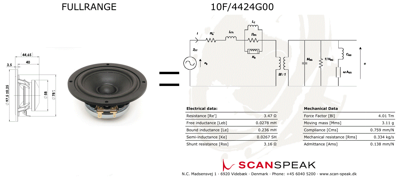

I am a audio newbie who got interested in audio recently. May I ask whether a crossover is required for full-range speakers? My guess is that it is not required because a full-range is just a single speaker covering the entire frequency range. There is no twitter, sub-woofer. Correct me if I am wrong.

You might want to know that your driver it's the same (acoustic/electric parameters) as it's equivalent circuit.
You can make 2-way speakers with minimal crossovers with no practical advantage for the no-crossover speaker, in such a way. Also the frequency of the crossover plays a major role on it's problematics with vocals and others. The same with the phase, very important for accurate reproduction and localization of the source. In a multi-way also the good qualities of a fullrange are looked in for the mid, if we can say so, comparing it in that way.
But you are right the short answer is no.

What dave was saying is that a "filter" circuit is sometimes used to correct for non-flat anomalies in the "full range" speaker's response.
Having said that, it is good to realize that most "full range" speakers are in fact somewhat less than ideally full range, especially in the LF. However there are some clever loading (box designs) methods that can make them surprisingly respectable, albeit at moderate SPLs.
