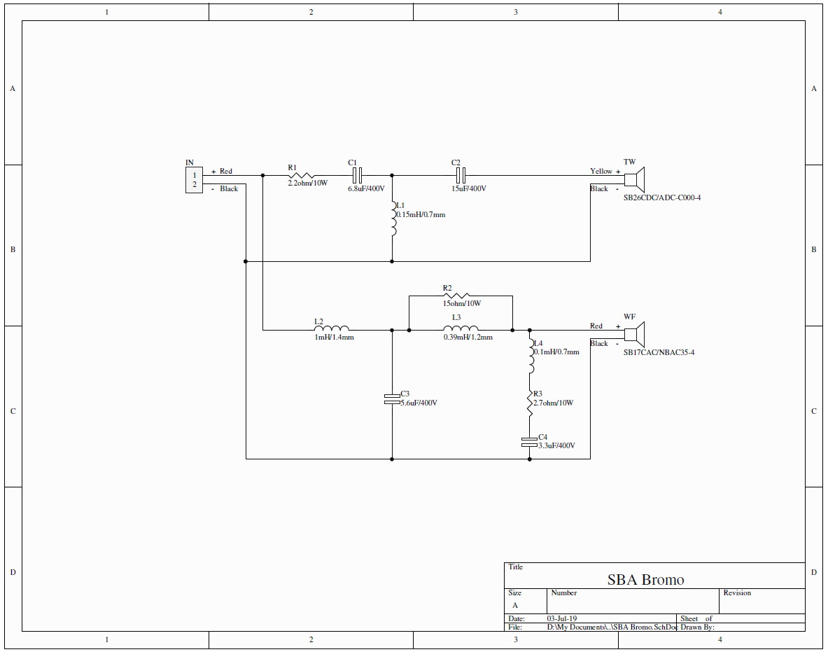

Madisound posted the Bromo Kit, with a schematic from SB (I guess), which could be interesting but don't really know if there is going to much of an improvement on previous SF/SB29s builds.
Any thoughts?
Any thoughts?

Ceramic SB17 is not significantly better than any of the other SB17. The material affects the frequency response a bit and the sensitivity, due to difference in weight. Once you put the crossover in place, there is going to be very little audible difference between the different SB17 models.
Any of the SB17 are a significant step up in performance from the Silver Flute, because the SB17 has a better motor design.

Most 'Ceramic' domes from SB are heavily oxidised Aluminum. That is why their response and performance is identical to Aluminum cones, but you do pay for the additional work. The cones are fractionally heavier and it affects to a very small extent some of the mechanical parameters but they are fully interchangeable.
For tweeters the Al versions would have better performance and the Ceramics might have better behaviour in the breakup region. I've not looked at it in detail, but at a purely technical level there's no reason to choose them over the Al cones/domes except if you like how they look. I'll admit they're very pretty, and will be as good of a performer as the Al drivers.
You can't discount the distortion characteristics - the old SF woofers had, even back then,. very primitive motors and would need to be crossed very early, or very hard, or need a lot of crossover work. When building with SB drivers, the crossovers tend to be very easy to do, with not much control required except if you're going into dicey territory to begin with. And most of their drivers have vanishingly low distortion, so they are a real treat regardless of which level of driver you choose.

I have used the SB17CAC35 and SB26CDC in a project, and I think they are a great driver combination. my project was a DSP filter active amplification system.
Based on technical reviews and comments from other DIY-builders whose opinions I respect, I believe that the SB17NBAC and SB26ADC have equivalent performance. The ceramic diaphragms have just slightly better performance at the first mode breakup... just slightly more damped by about 2 dB. This is probably insignificant, but for an extra $10, why not?

For what it's worth, here is a link to a Klippel test of the SB17CAC35-4 ceramic 6-inch mid-bass. While bass distortion (<200Hz) was something of a disappointment, the midrange distortion (>200Hz) was found to be a test record low. Which is not proof that the ceramic cone was responsible for either result. Certainly not for the bass distortion.

Regarding the potential sound character neutrality of rigid (meaning, high-Q) cone materials, Ted Jordan once proposed a simple kitchen experiment. He said to sit two drinking cups on a counter, one made of plastic (a low-Q material) and the other of glass (a high-Q material). Then strike each cup with a knife edge. The plastic cup material is naturally highly damped and produces a short 'thunk' sort of sound, while the glass cup rings a long time.
Now, repeat the experiment, except this time, with a fingertip resting on the rim of each cup. The plastic cup essentially sounds the same as before, while the glass cup now produces a very brief and colorless 'tick' sort of sound. Being high-Q, the glass is much more easily edge terminated with something close to it's characteristic mechanical impedance (your fingertip), while the plastic cup is permanently terminated by it's own lossy material, which is inherently distributed throughout the cup. Even when held in your entire hand, the plastic cup's sound character when struck persists. Ted's point being that high-Q cone materials can be made much more colorless than can distributed low-Q cone materials.

I've heard this from other builders also, the 4 different models are about the same, although I see not everyone agreed.
The SB17CRC35-4 6" Woven Carbon Fiber Cone looks like the flagship model going out to 4,000 hz.

The cone geometry of cac nbac etc is clever. Its almost flat on the outer inch. Off axis is pretty good. I love only tried the anodized metal version. V nice mid range
