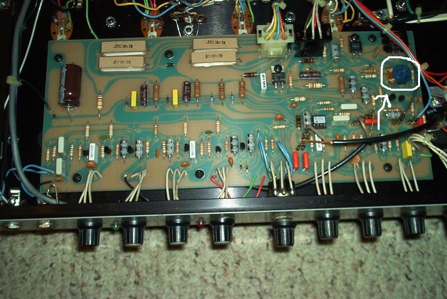

Just for comparison: in "the old days" , think 60´s and 70´s , it was normal to build "most" of an amp on a PCB but TO3 power transistors were on a finned heatsink some 2" to 6" away, and big supply caps were chassis mounted on their own clamps, again with 2" to 6" wires .... and amps worked fine.
70´s 80´s Randall Guitar amplifier, notice chassis mounted TO3 power transistors (to boot, in sockets), pots, big filter caps on the chassis underside, hidden by the main PCB, ALL connected with reasonable length "flying" wires:
