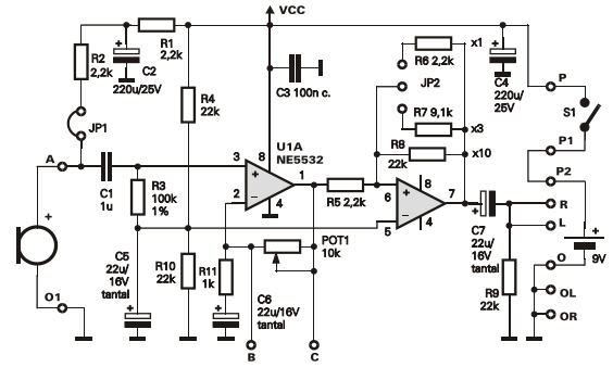

I have built this electret mic preamp and it works great. However recently I have bought Behringer ECM8000 microphone which needs phantom power. Is it possible to modify the shown schematic in such a way that it is able to work with ECM800 + design the simplest possible 48V DC PSU using 4x12v batteries?
According to Behringer the ECM 8000 is OK with 15 to 48 volt power.

By chance I've also been reading about the ECM-8000 (thinking of buying one). Like Mooly, I'm not really knowledgeable on the subject and everything that follows is just based on what I've read.
Anyways, the ECM-8000 is a bit weird in that it seems to have been designed to have a balanced output, which actually isn't. (You can find a schematic pretty easily by googling. There are some threads on diyaudio too.) I think that you might have to provide the phantom power to both signal pins. To do this, you can probably get away by duplicating the R1,R2,C2 circuit and applying that to the negative pin. Other than that, I think your circuit might work, if you increase the voltage (assuming that the preamp works with a higher voltage. I didn't check for that.).

Yes, happier with closer to 48V. Even though the mic only uses 12V, the two driver transistors are biased with the 48V. Search the web for mic preamp circuits and you will find several you can adapt. THAT and National are good starts.
I dissagree with the "not proper balanced". Not symmetrical, no CCM rejection advantage, but the impedance is balanced. Pin 3 is not ground, it is driven from ground.
Sorry not to be contributing to answering the original question but my eye got stuck on an error in the circuit diagram. The second stage, U1B, has the input signs reversed. Pin 5 is non inverting and pin 6 is inverting.

This is a two wire preamp and you are asking a 3 wire question. Modification would tend toward a total rebuild because a balanced input is needed for your new mic.
As a suggestion, change the 5532 for a NJM2068- every spec will improve, noise, distortion, and sound quality.
