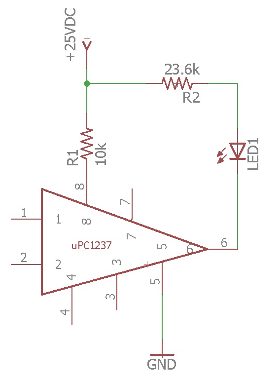

I have been playing with a uPC1237ha I have pulled out from an old working power amp trying to understand how the thing works. Here is the simple circuit I have set on the breadboard. As you can see I have created a bare minimum to just see if I get anything at the pin 6 when no input at pin 1 or 2.
The voltage as measured at pin 8 is 3.4V (by the spec). The voltage at pin 6 is 23.6V while I expect it to be smth close to 0 since pin 6 is the output of the relay driver and in the absence of input at pin 1 or 2 pins 8 to 6 are supposed to drive a relay. Is my IC broken or have I messed things up?
I never confirmed that DC or overload protection worked in the original amplifier I pulled it out from. All I know is that the amp was working OK in normal conditions. So there is a chance the IC is broken, however I can't see by the look of it that anything wrong with it (it is not visibly fried or anything like that).

Hi reedcat,
No, I think the chip is fine.
You have to tie the unused inputs down to common, pin 4 should see just under a volt on it (AC power detect), but less than 10 VDC (abs max). If you don't tie the other inputs low, they could float high enough to make the IC think there is a problem. Ground pin 3 so it will automatically reset also.

Darn it! You are absolutely right! As soon as I had 2V at pin 4 and tied all other pins it worked like a clock. I was even able to test mute on power on. Thank you for your help. I spent all night yesterday banging my head at this. 🙂

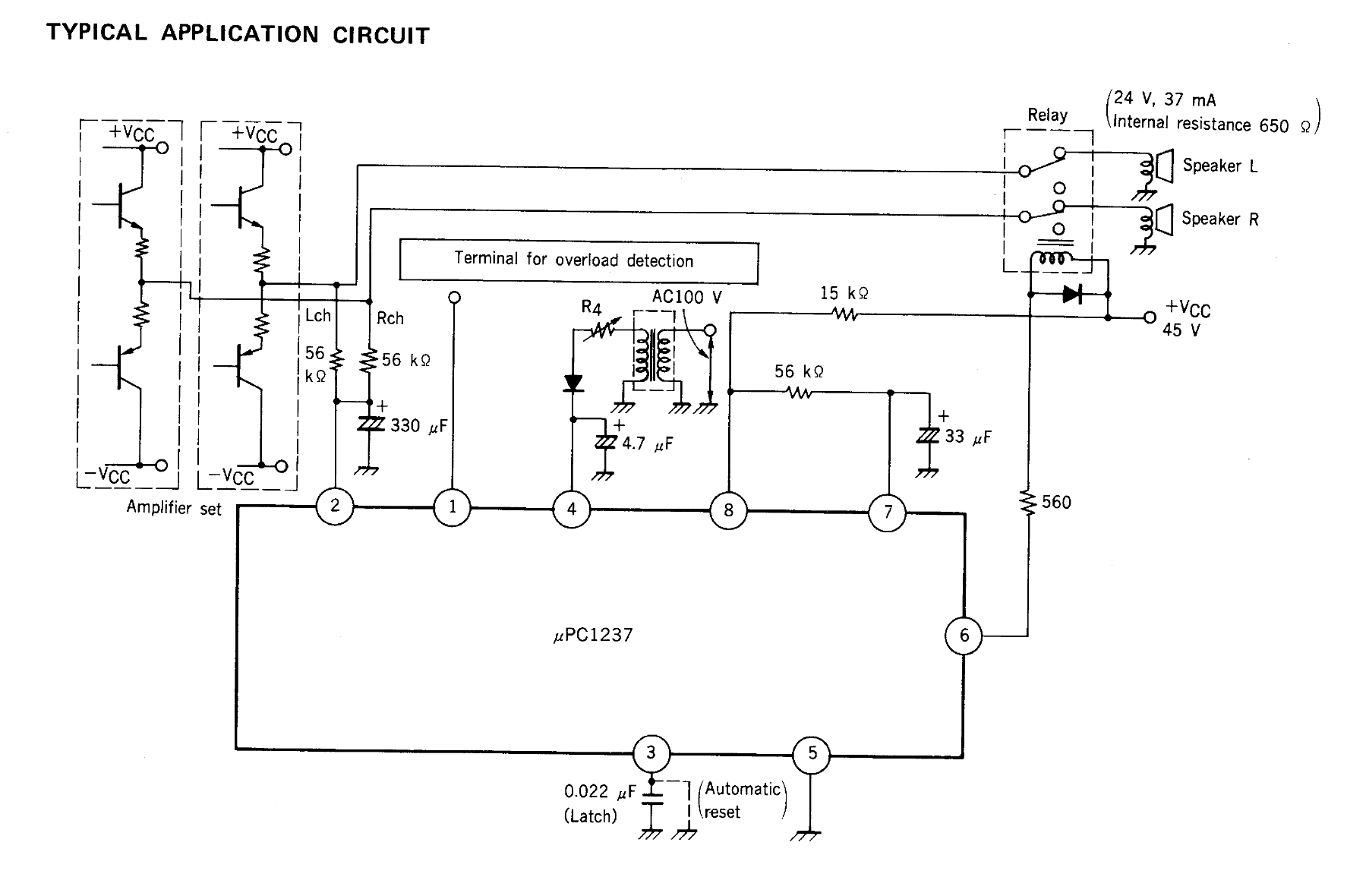

Here is one more question that hunts me. I hope you guys find it a piece of cake and relieve me from my misery.

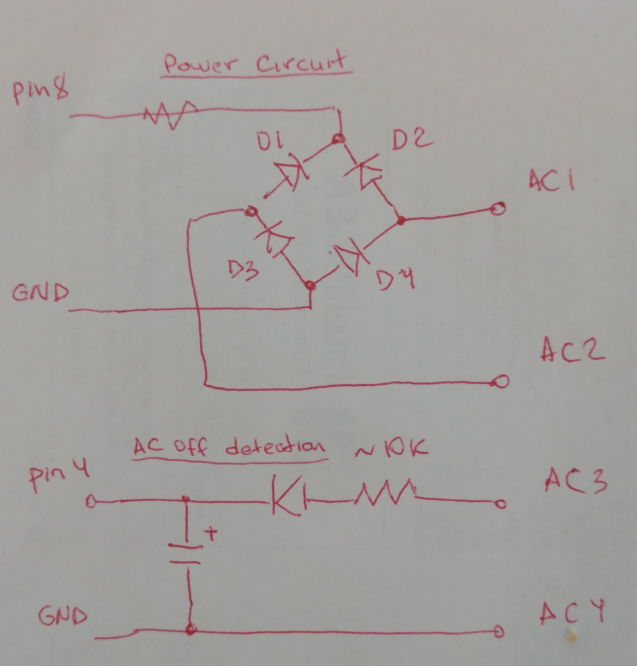

Attached are the example circuit from the data sheet and my own drawing with uPC1237 power circuit and AC off detection circuit (going to pin 8 and pin 4 respectfully).

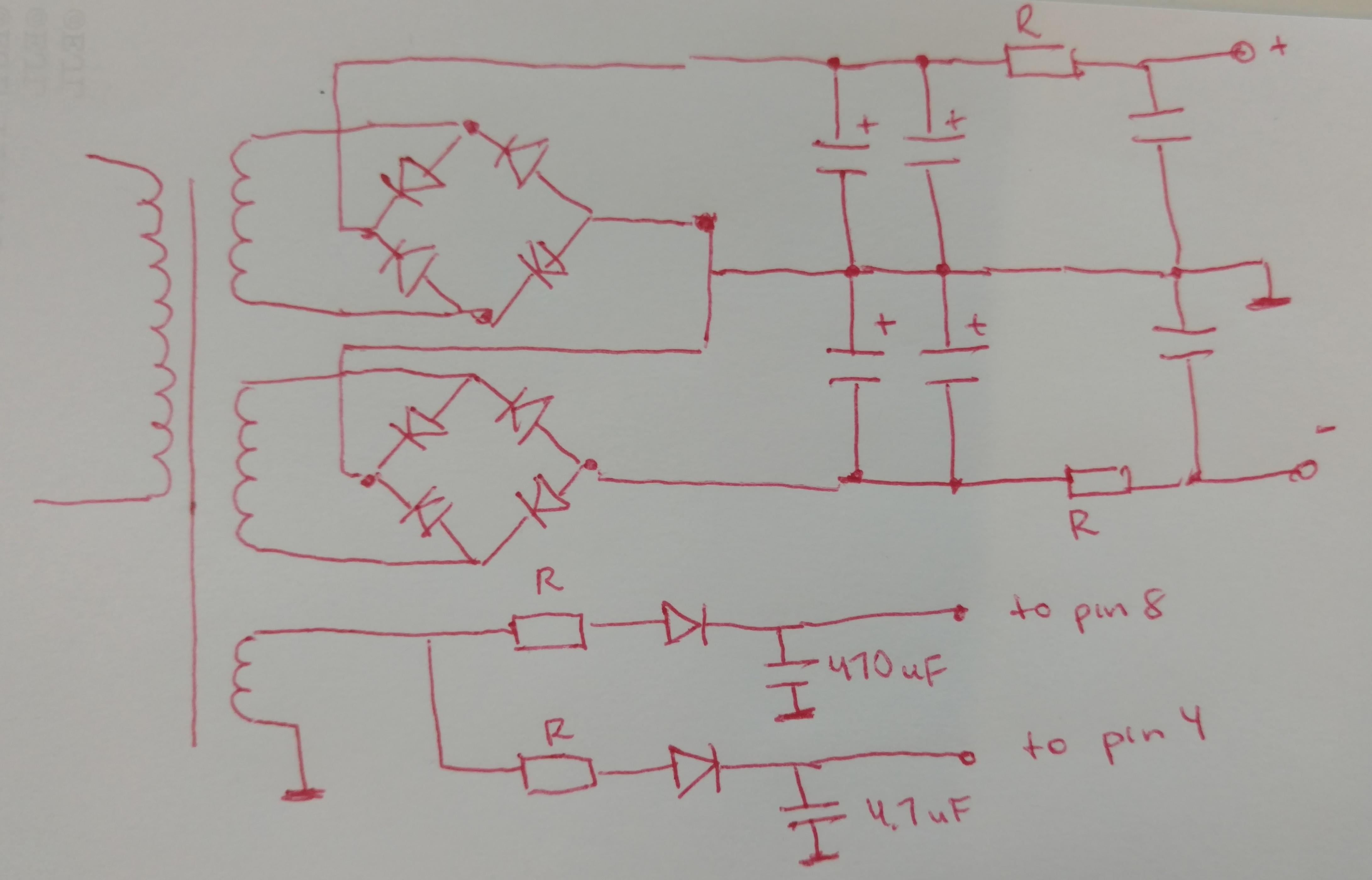

I am going to power uPC1237 with a separate low VA transformer (TR2) so that uPC1237 is not impacted by the slow start circuitry I use with the main PSU transformer (TR1). Originally I was going to connect a spare secondary of TR1 into the uPC1237 AC off detection circuit (AC3 / AC4 in my drawing) however I am thinking lately I want a short cut. Rather than send a wire from TR1 to the uPC1237 PCB why not use TR2 secondary directly and connect in the PCB itself? So my question is, can AC input in the upper part of my drawing be connected with AC input of the lower part - AC1 to AC3 and AC2 to AC4.
I suspect the answer is 'no' (since this will essentially short out D3) but I don't know what the right way to connect is. If AC3 and AC4 came from a different transformer (as shown in the data sheet example) then grounding one output of the transformer wouldn't be a problem, but if I use the same transformer to power uPC1237 and for AC off detection then I am thinking it will cause issues. What do you think guys?
P.S. I cannot feed DC power to pin 4 directly (via proper resistor) since I will be using a 470uF cap in the power circuit and it will delay AC off detection. The capacitor in AC off detection circuit is much smaller (data sheet recommends 4.7uF)

Hi reedcat,
You can feed it from a supply with a large capacitor. You just put it's rectifier and small cap feeding pin 4, then take the next rectifier to the larger capacitor for the other power supply. That would work if the other supply was bipolar with a common ground. Of course, you could also feed it from the main power rectifier. It will detect as little as 0.8 Volts, and if the slow start delays it a little, who cares? Just shorten the time it takes to pull in.
The important thing is the common ground point.

Let me make sure I understand you. Are you referring to connecting both pins to the small transformer (TR2) like the attached circuit shows? Or did I misunderstand you?
The main amplifier PSU is bipolar with common ground. I don't want to use it to power uPC1237 because I think slow start will interfere with uPC1237 ability to mute speakers on power on. If that is not the case then I will gladly use it - one less transformer, my chassis it already crammed.

I think I completely failed to understand the significance of this statement since I still don't understand how you suggest to power uPC1237 from the main PSU.
Hi reedcat,
Your picture is correct. The reduced AC voltage will power the AC detect just fine. I guess what you really want is a "housekeeping transformer", but you don't need one.
Assume the uPc1237 is affected by the slow start. As far as it's concerned, power has not been applied yet and so it remains off. Soft start trips and only now can the chip work, so it begins a time out before activating the relay. This really has no effect beyond increasing the length of time before the speaker relay contacts close.
The uPc1237 will not connect the relay until it has powered up and gone through the timing period. In short, you are worrying about nothing. Try it.

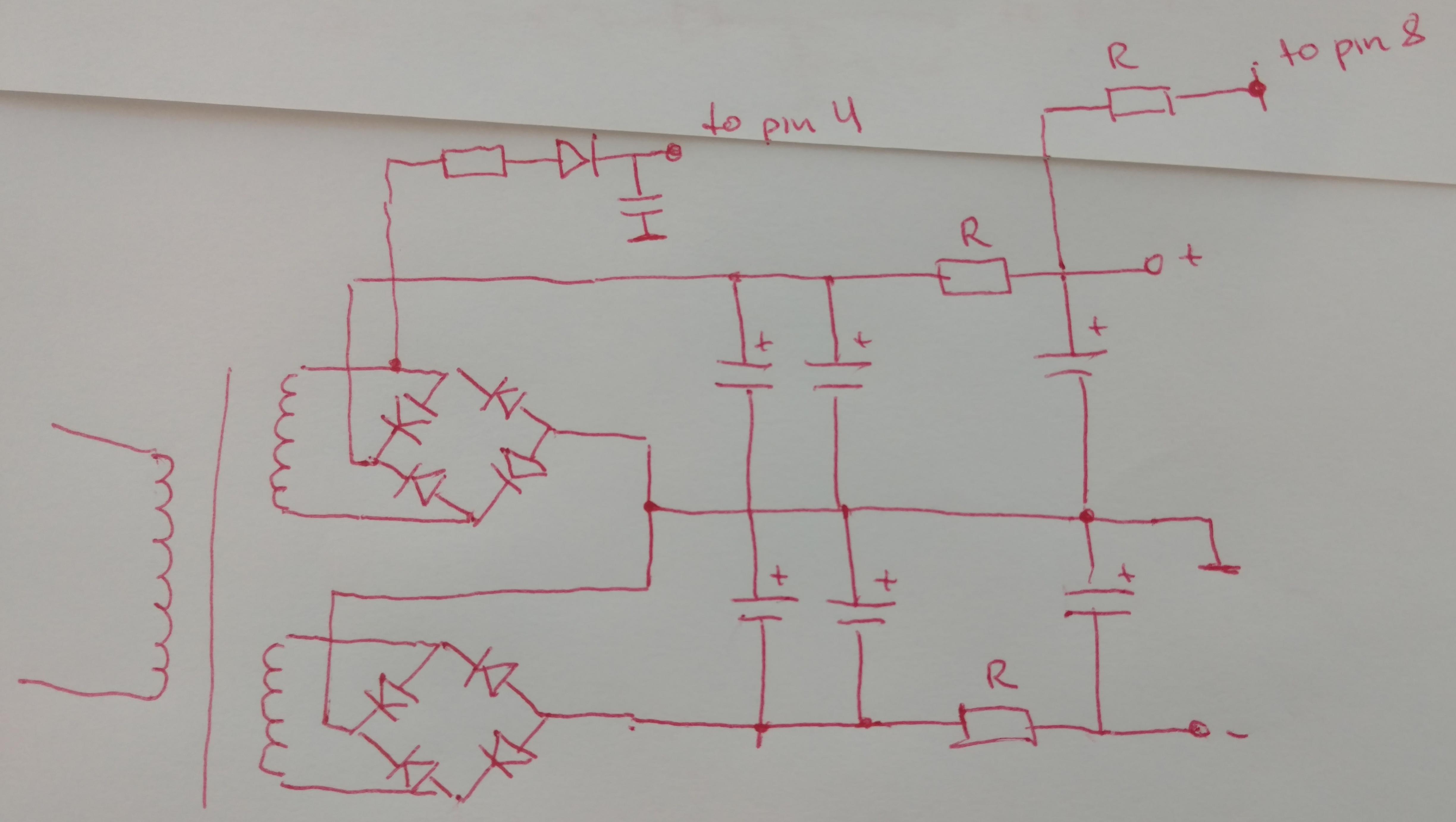

Alright, I think I understand now why slow start will not affect protection. I still don't understand however how I can power uPC1237 from main power supply.
Attached are two designs. One is for using the spare secondary - no questions there. The other one is my attempt at connecting w/o spare secondary. See if there are any issues there.
One difference of this design with the design in the data sheet is that in the data sheet the first out of the transformer goes in the pin 4 circuit while the second out of the transformer is grounded. In my case the second out goes into rectifier bridge and then grounded. Is that acceptable?

Hi reedcat,

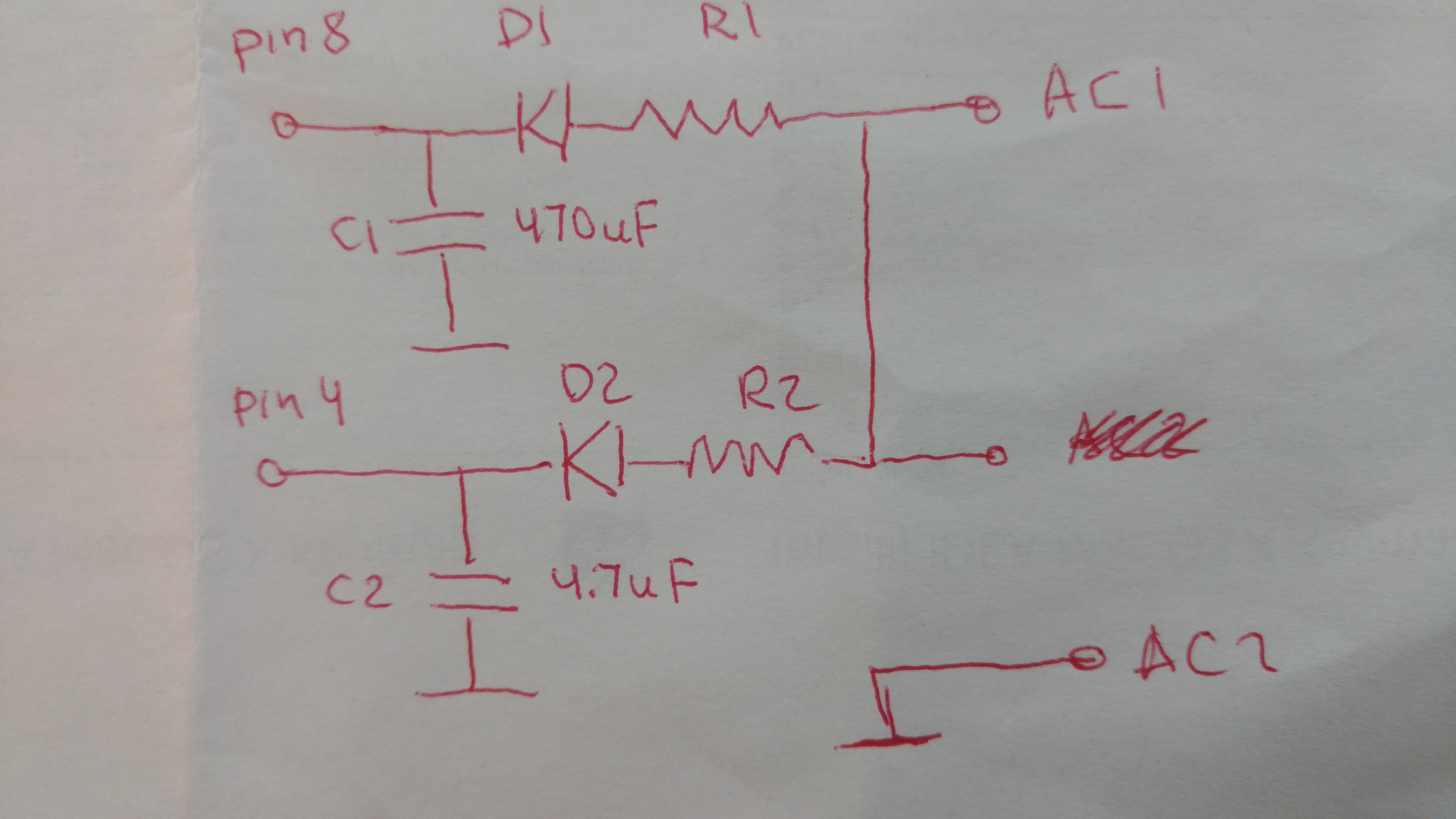

Diagram #2 is correct, but you are introducing variables before you have a good understanding of the core question. See this attachment for the basic connection. Of course you need to add resistors between the diode and capacitor. I just wanted to show you the basic idea without any other things to clutter it up.

Alright, I get it now why the diodes should be connected in a series like that. The second diode will prevent larger capacitor discharging into the smaller one. Thank you Chris!
