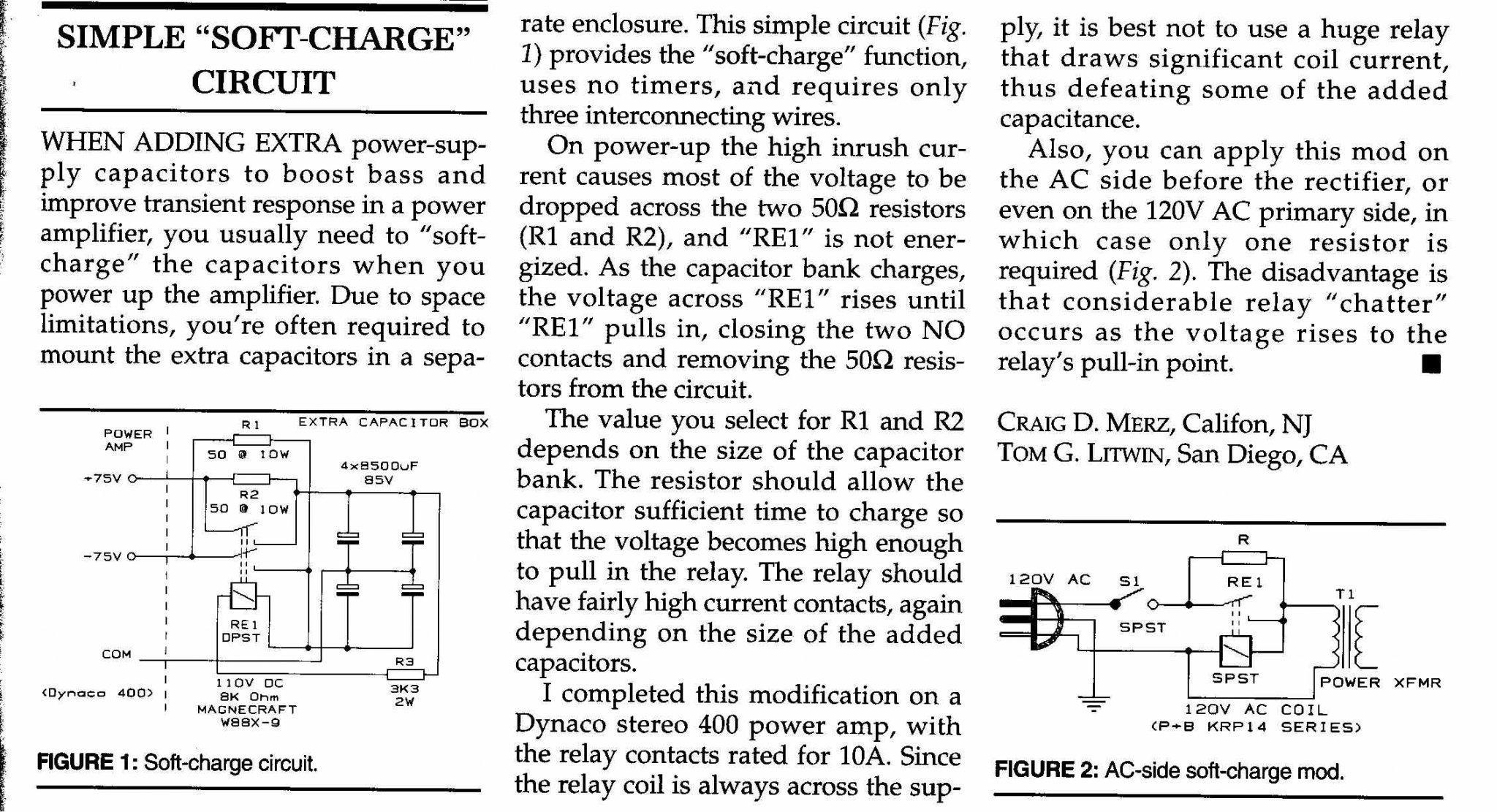

For a power amplifier I am contemplating a multi-Farad buffer to the power rails. That would complement some aplifiers great That now also have 56.000 uF big-can capacitors like from Mallory, big, blue, screw Mount. Some designs just love such buffers!
While I can easily cycle the power supply to an on-state = going from 0 volt to 14 volt, I am worried that the capacitors might not ‘like’ that and are in fact made fo allways-on use.
Such as being used parallel to a (car) battery. Then it virtually never goes ‘off’ to unloaded.
On the other hand, in an amplifier I would see it stop gracefully in about 5 minutes, once the power is switched off.
So in actual use it would cycle.
If that is is not wished, then I would make a relais (the DC-type contacts as used in cars) to engage them. Then they would stay charged When the amp is not in use.
What is your advice for this?

Caps aren't batteries and don't mind turning on and off, but the circuitry feeding "multi-Farads" will mind. Why don't you just sneak up on it with another set of 56000uF?

Yes that is right: you can't just switch this, e.g. to a battery. The wire will explode (50 amps?). I have seen several such 20-50 Farad buffers where the wire has a small switch, that you have to engage, standard is 0,5 ohm for instance, then the switch shorts that and the cap stays connected to the car battery all the time.

Well - they might 😉 : 1 million times in one day (24h) would be 11.5 times every second.And the answer is: No, the caps themselves don't mind turning on/off a million times a day...
That would give you some 18A constantly applied either charging or discharging (with 14V delta and 56000uF).
The heat generated by this for a prolonged time may overheat the capacitor.
But besides this you are right - in general capacitors don't mind being turned on and off and do not suffer from the wearout that a battery would.
And then there are the exceptions as noted in #6.
Then I'll go ahead. It is for a new implementation of a amplifier Le Monstre. What the designer said in another circuit: the 1F supercapa makes the sound seem dull but it is darker and has more depth.
Thanks for doing the math! I was going to say "thousands" but that didn't seem extreme enough to make my point that it's not really about the caps but about how to control the inrush...1 million times in one day (24h) would be 11.5 times every second.
Charging every minute would already heat them up beyond repair . . I have several capacitor banks from (mil) airplanes that had a 22 ohm resistor and 10x 56.000 uF. All in a case that slid right into a recess somewhere.
