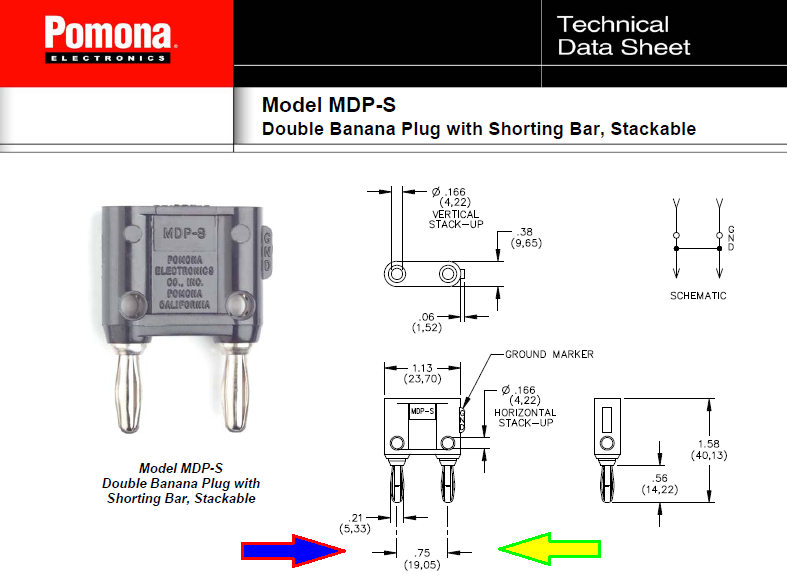

I think the manufacturers common standard is 0.5" (1/2 inch).
I never found a commercial product with a 3/4 spacing.
Here's one from Pomona, model number MDP-S

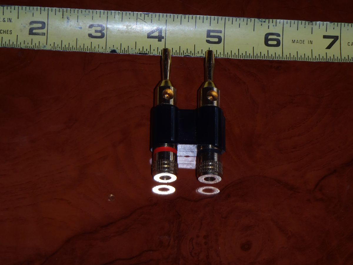

If you use the standard dual 5-way binding posts, they require two 3/8" holes spaced 3/4" apart. That way you are set up to use wire leads, crimp-on fork connectors, separate banana plugs, or a dual banana plug for speaker connections.
